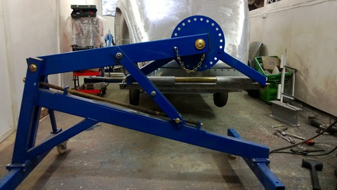

Re: Car Tilter
We have a more complex version of a tilter supplied by http://www.cjautos.eu/ but it does mean that you can remove the axles to access the work that is being undertaken - it could be simply built from box section - I'm happy to sketch the measurements to a drawing or dependant upon where you are located you could come and have a look for yourself should you wish - Chris
