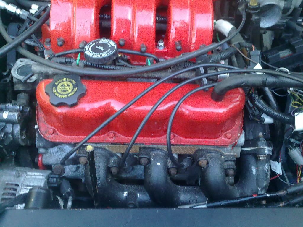

It's time to turn the engine over but not fire her up, to make sure she
hadn't seized up!

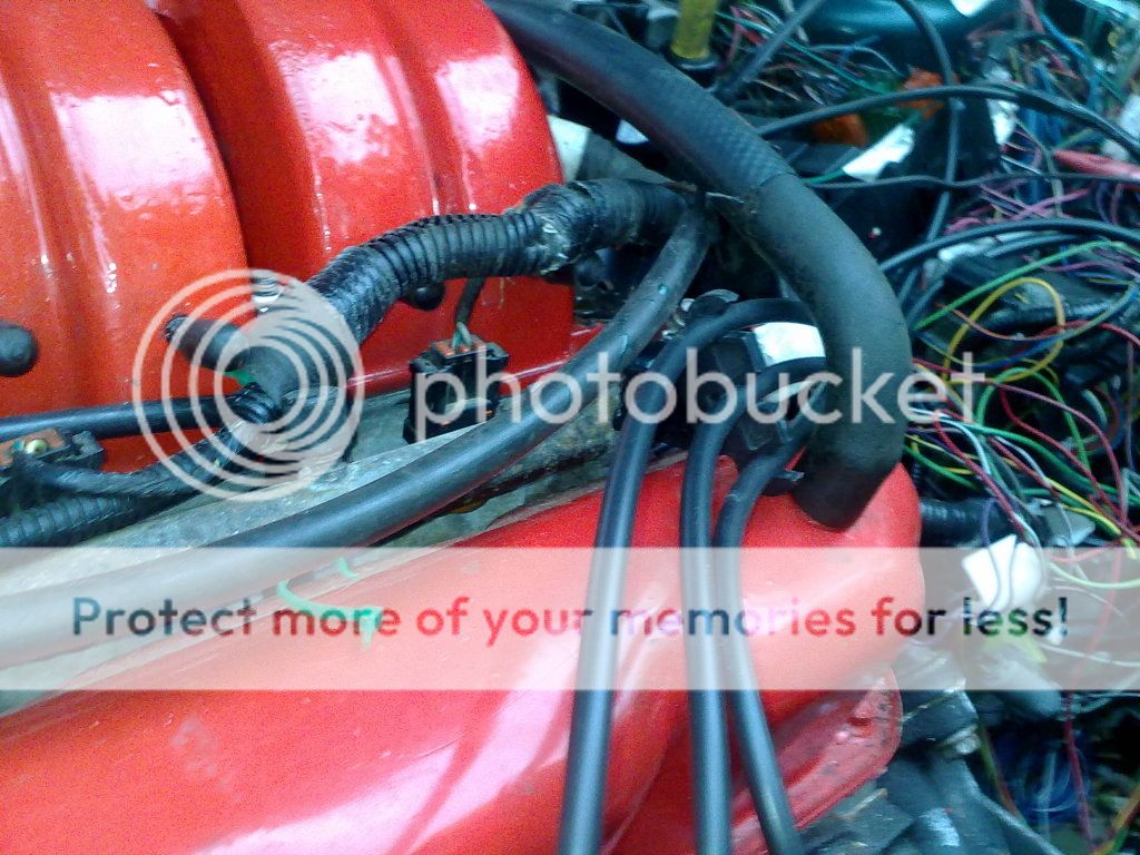

Then as the crimps had arrived, I cut the cable and one end of each of
the spark plug wires. I had found an old spark plug wire holder which
looked like it will be perfect for the job, but will need a little trim and a
hole drilling before bolting into place.

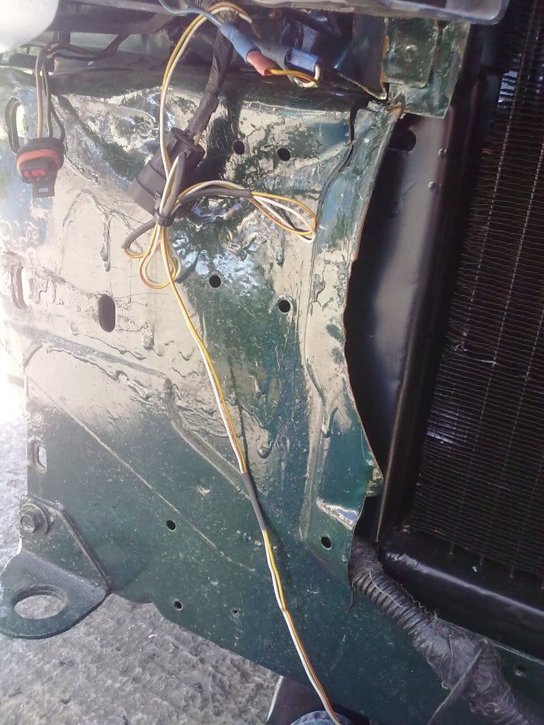

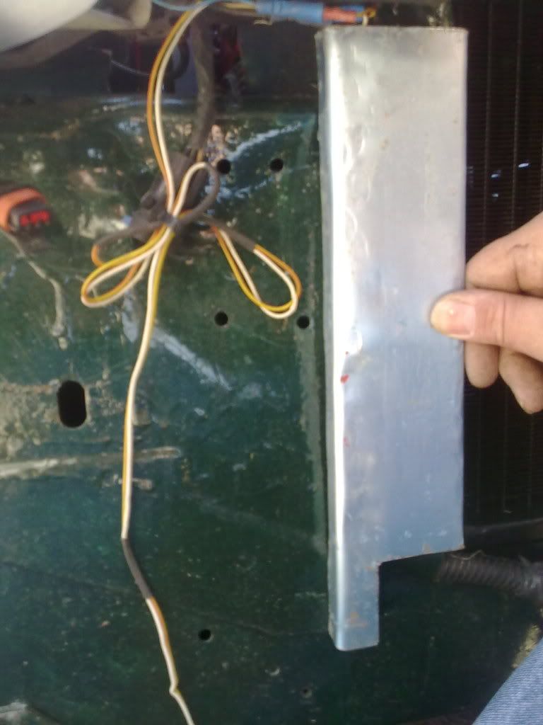

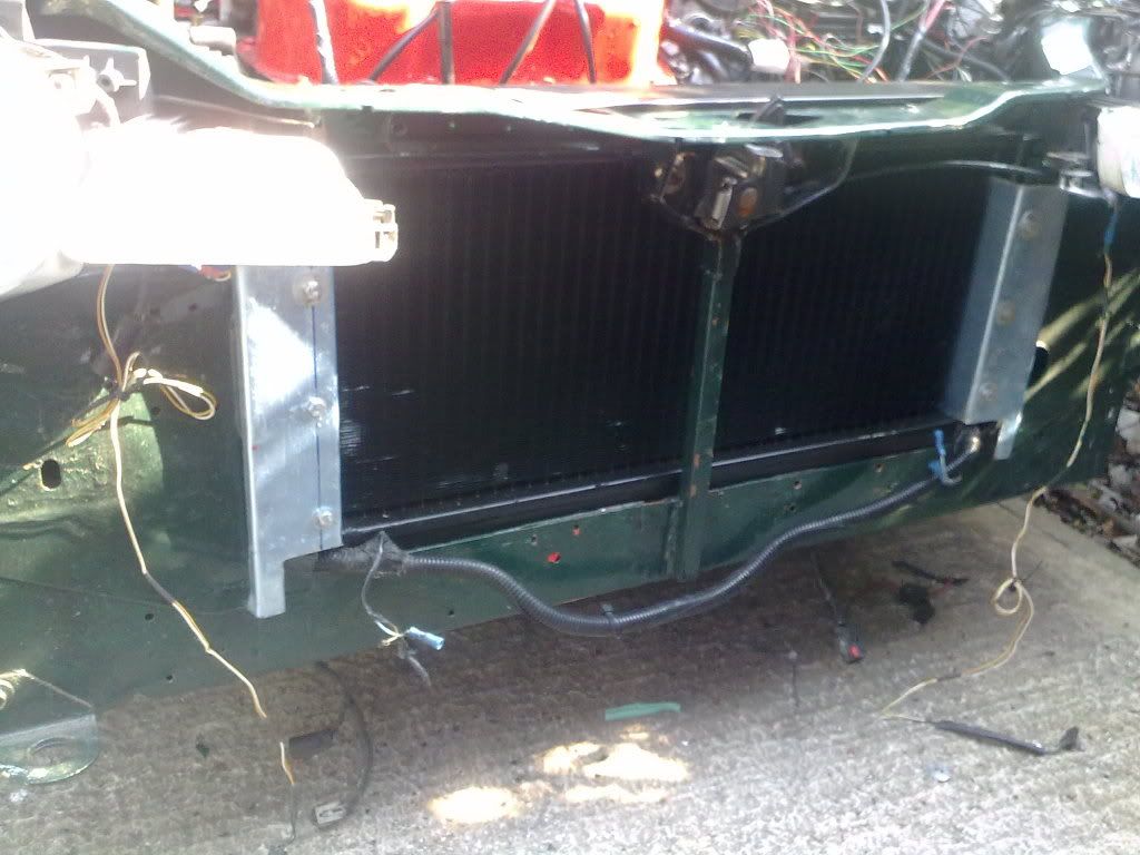

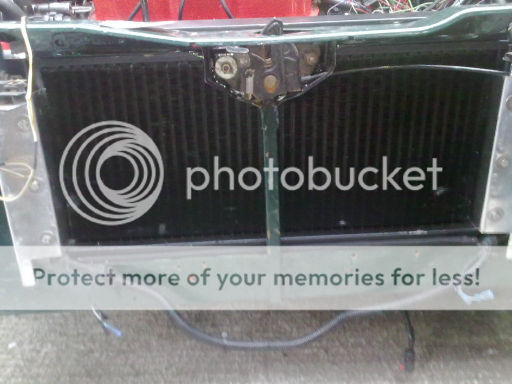

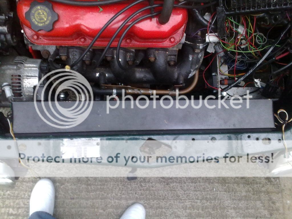

As Dad was welding his boat trailer yesterday, so nothing done till today.

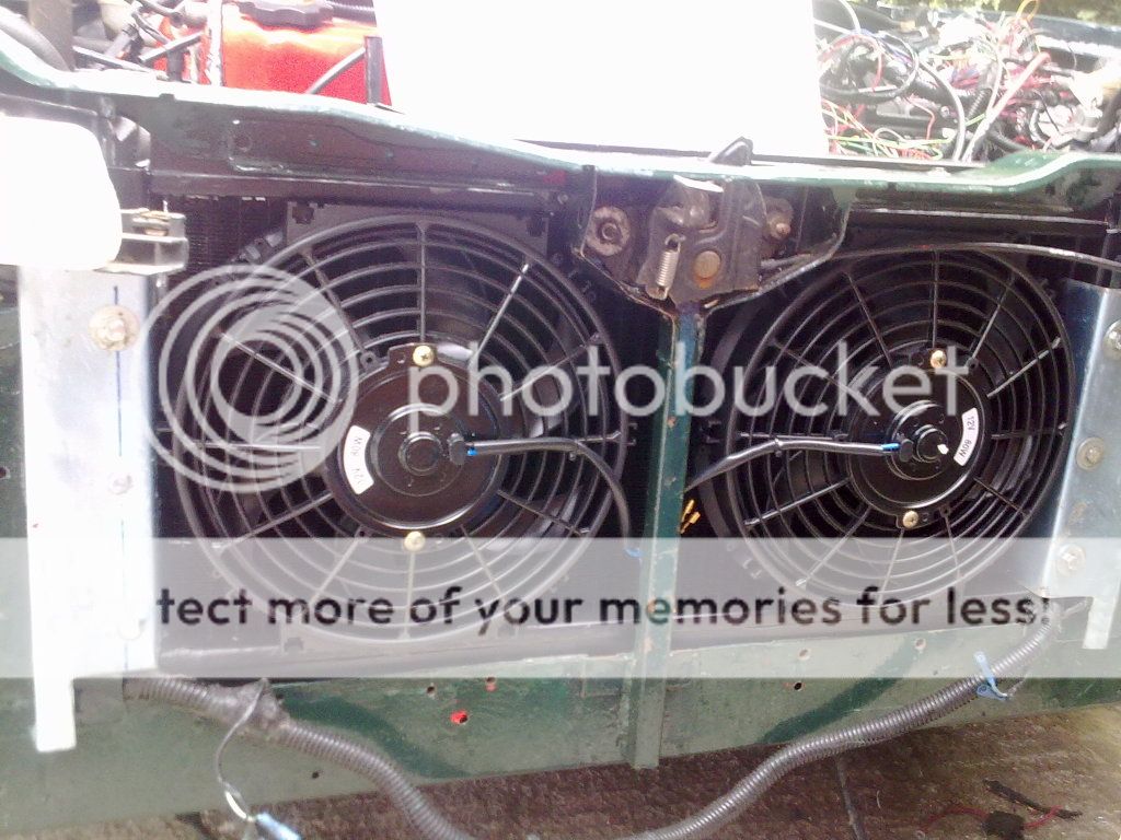

With the custom radiator being without the the a/c condenser the 12"
cooling fans are way too big and the panel which had been trimmed is
now a problem that needs to be covered up!

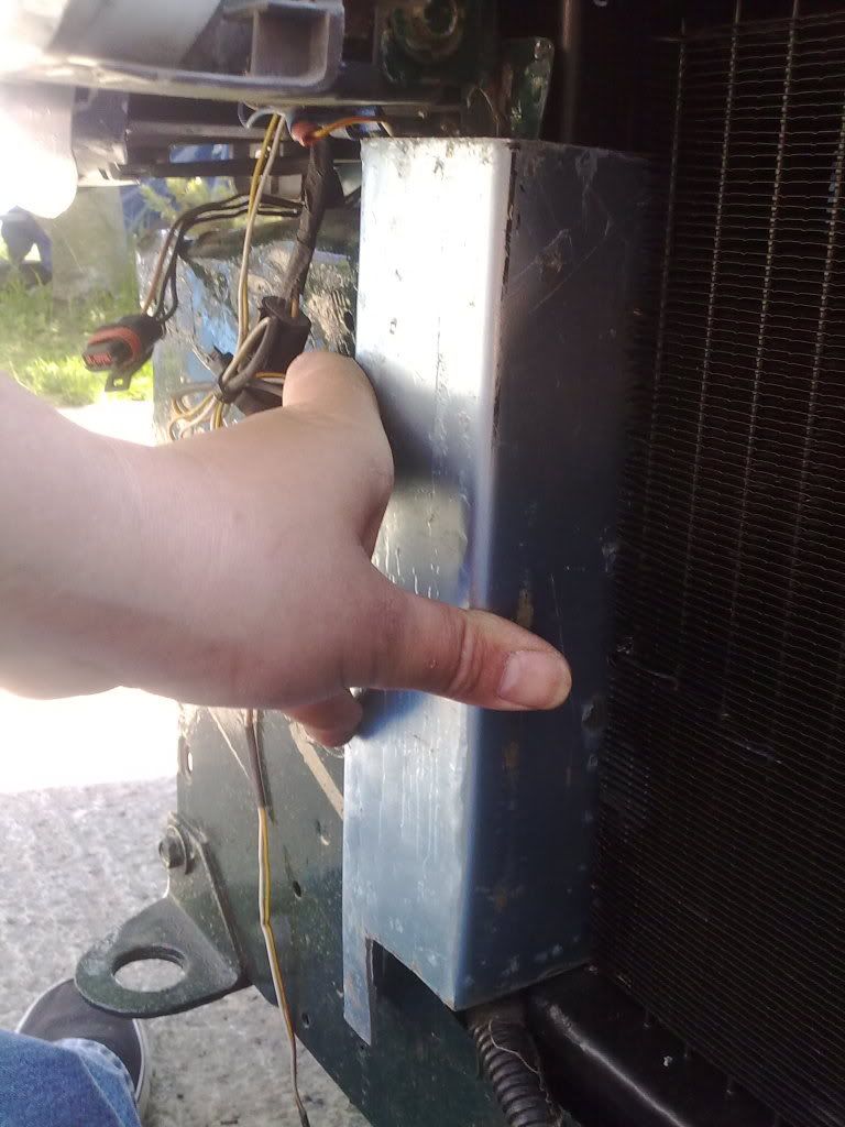

After cutting the alloy plate a good vise and a rubber mallet to bang it
into shape.

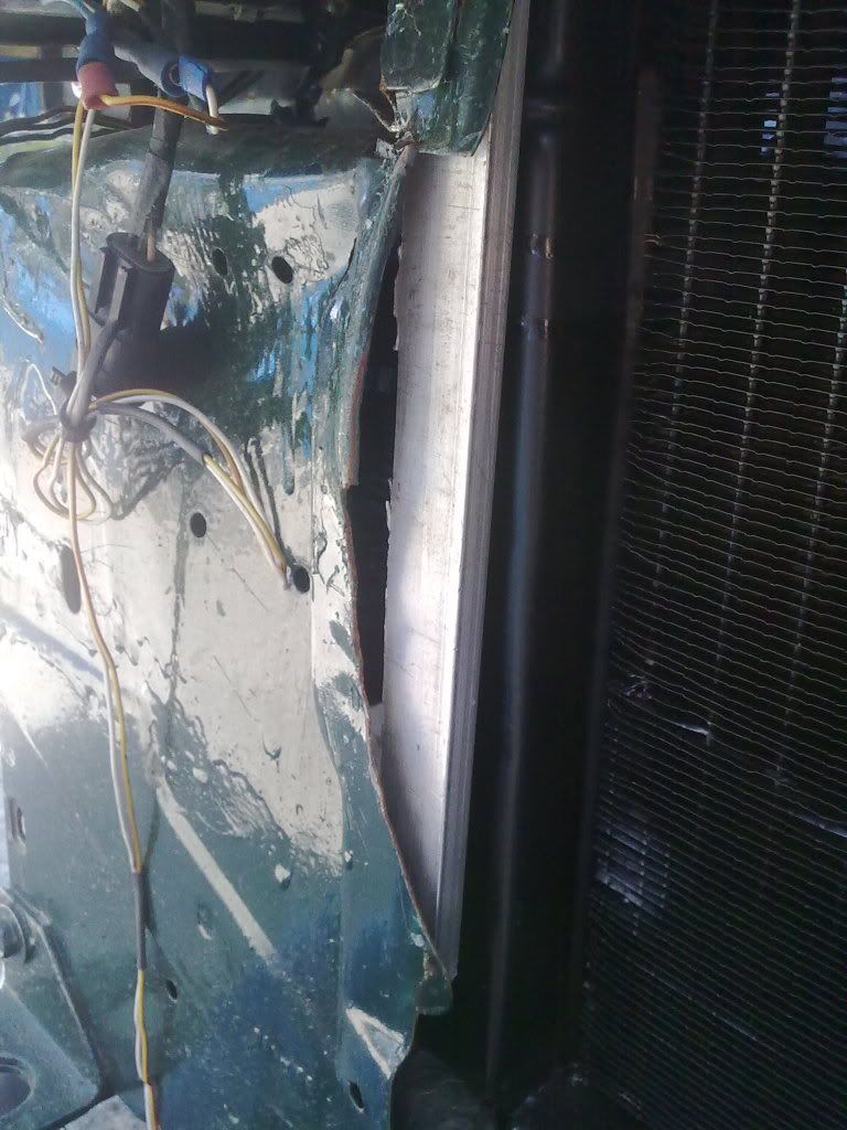

A thick strip of alloy used as a spacer to cope with the mouldings in
the slam panel.
It is all bolted up, but the nuts, bolts and washers will be replaced with
Stainless Steel as the current ones are just so I could bolt it up and drill
all the fixing holes. (The protective film on the alloy hasn't been removed)
10" fans will be bought to replace the 12" fans that don't fit.

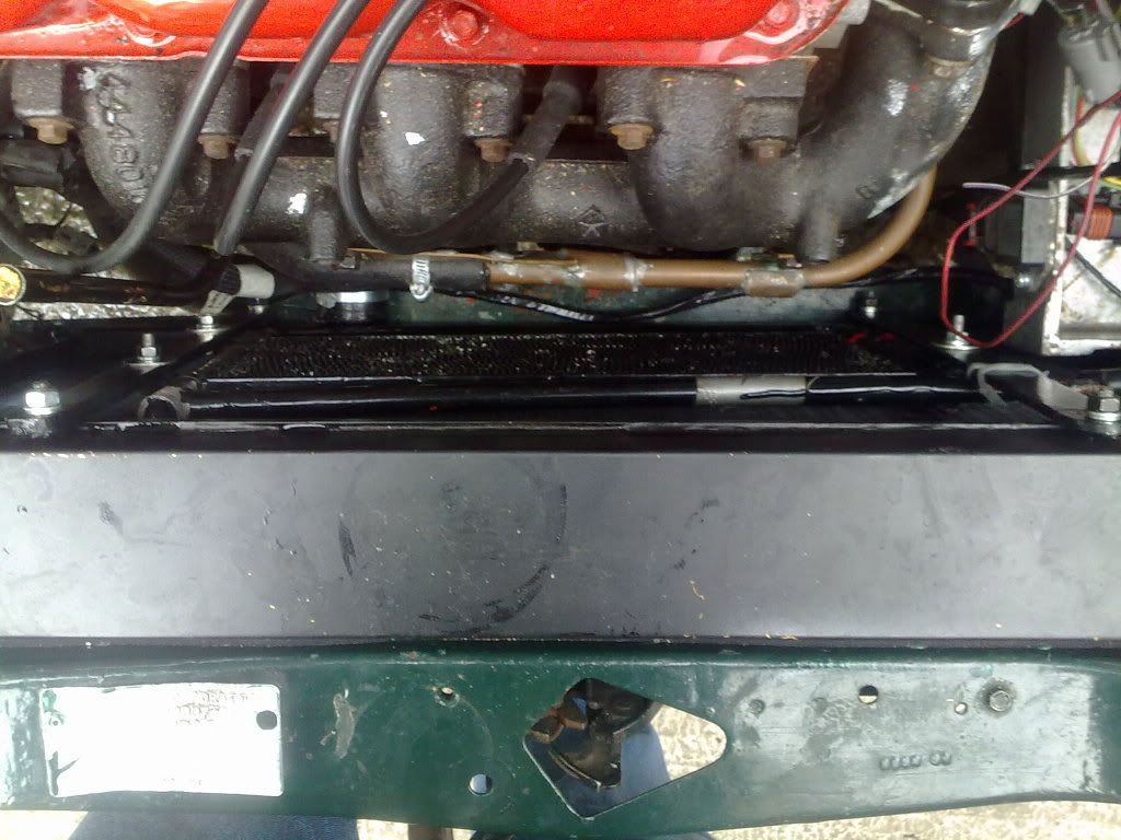

The brackets for fixing the oil cooler to the radiator, and the bracket for
clipping the spark plug wires were tidied up with the grinder and given a
coat of gray primer.

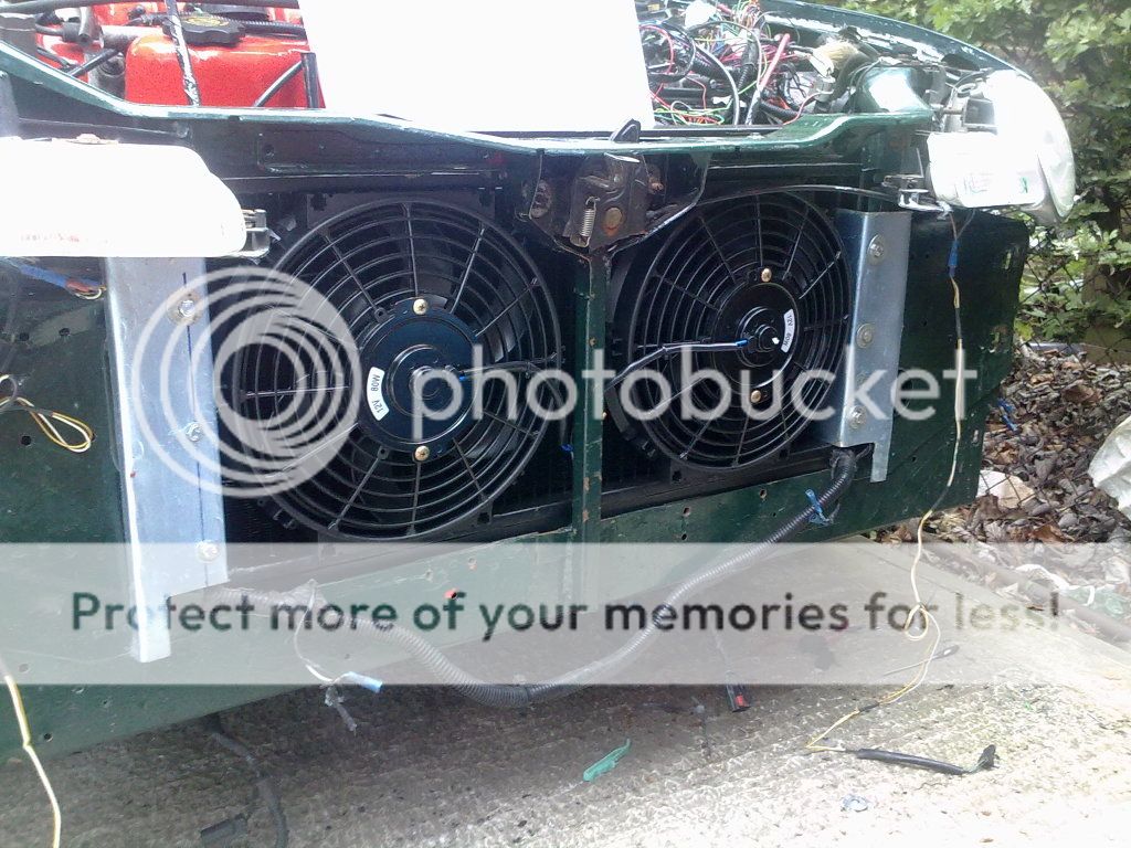

A rather large parcel awaited my return from food shopping. The
parcel wad a yard long a one foot square, the contents?
The two 10" radiator fans! could they have used a larger
cardboard box?
Without any brackets or fixings the two fans sit tightly between
the two tanks of the radiator.

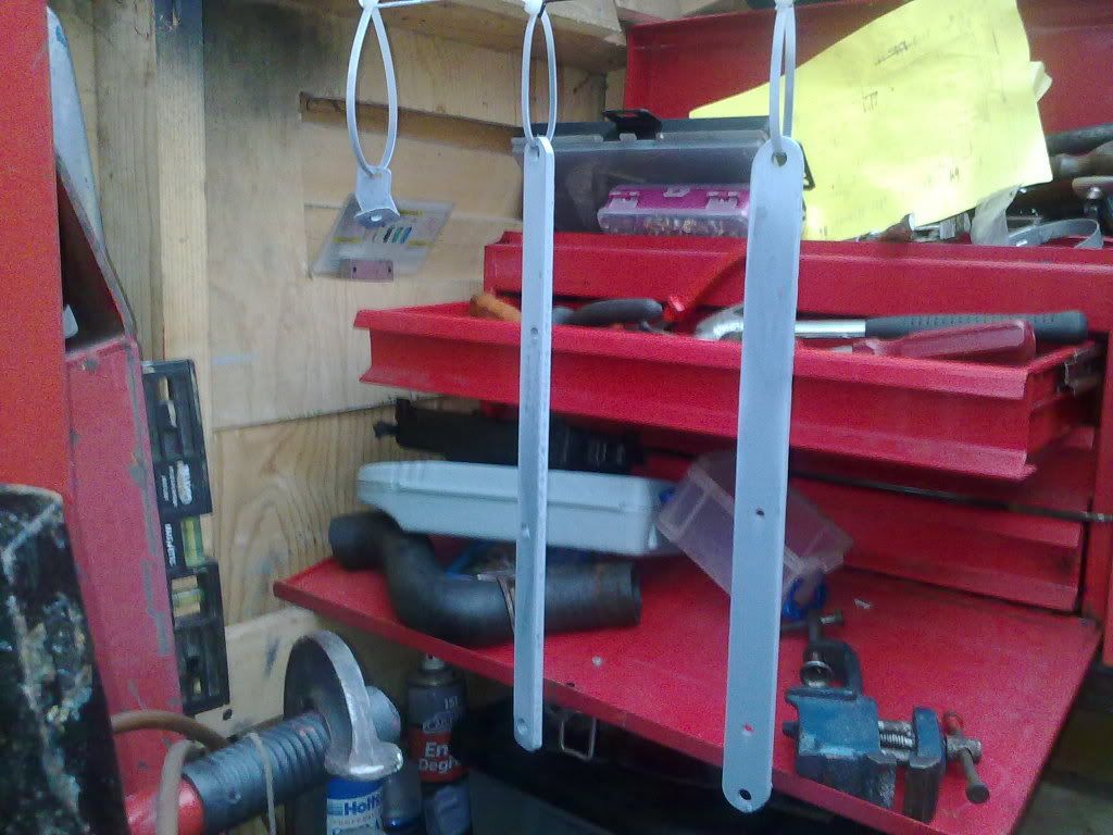

Looks like two new sets of brackets to be made to hold them in
place, luckily I have a bit of alloy box tubing which is suitable for
the top space to make an adapter.
The bottom is a total rethink!
As I had picted up the stainless steel nut , bolts and washers. It
made sense fitting them while the weather stayed good. I have
added a strip of foam draft tape along both the top and bottom of
the radiator before refitting it.
So the air gets directed through the radiator rather than over it
and below it. The foam tape also protects the radiator from sharp
or unevenness in the slam panel.

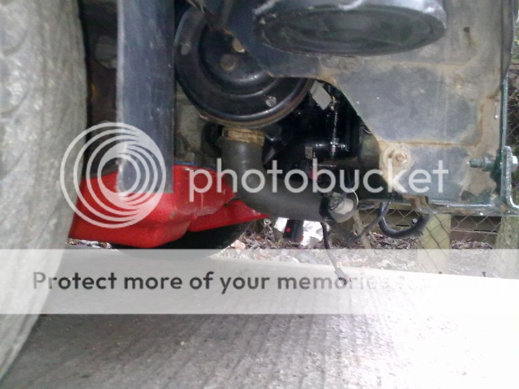

The lower radiator hose hase been fitted, I just need the
thermostat which I forgot to get before filling the cooling
system.
The little spark plug wire bracket's paint dried so it was fitted.

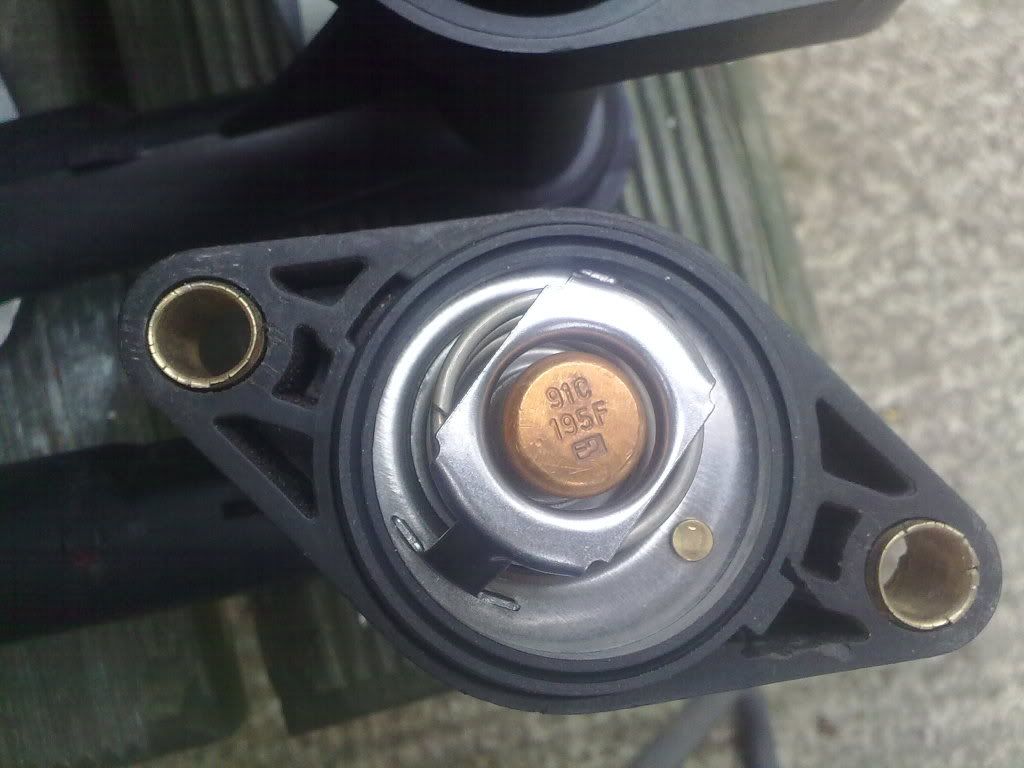

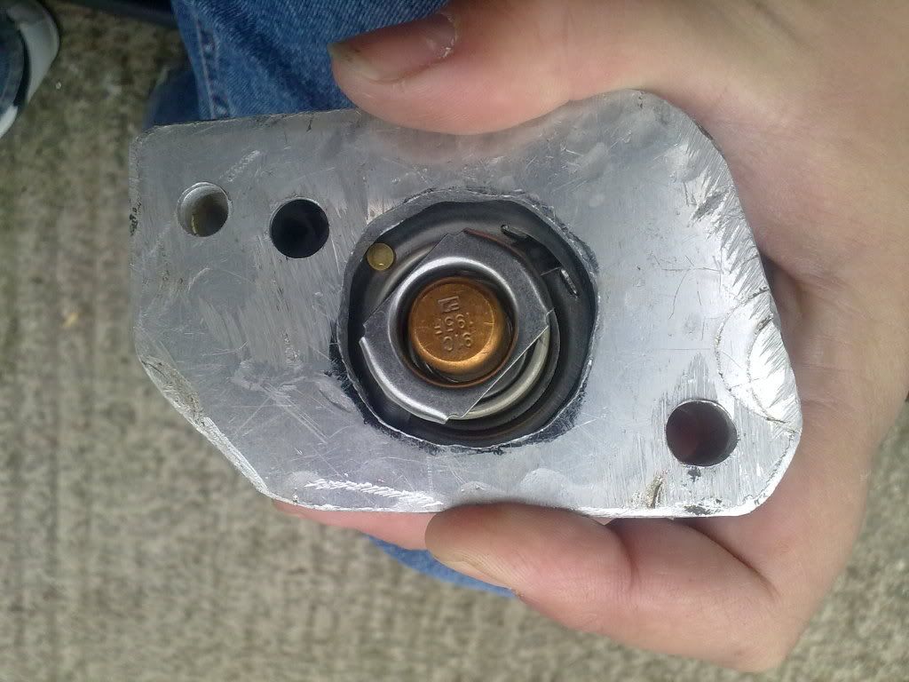

Today the cooling system again!

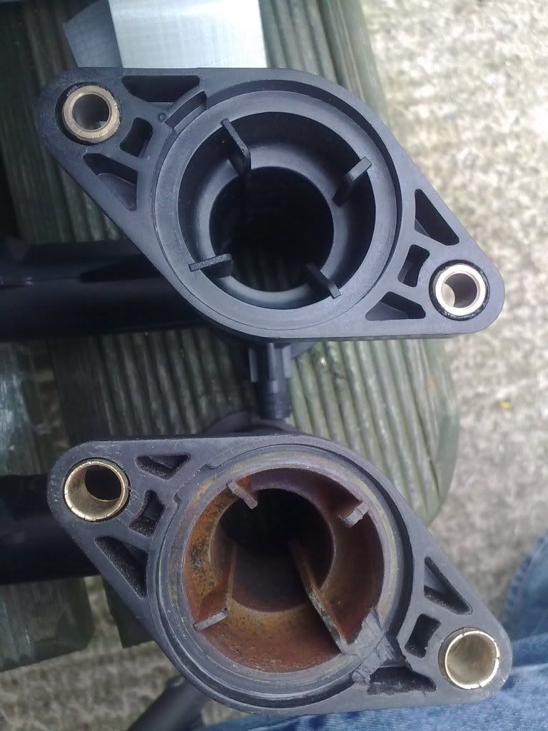

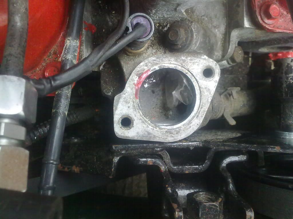

The modified and damaged coolant filer neck bottom and the
brand new one before I started on it.
I changed the bolt hole reinforcements, and used the
industrial dremil bit to do the modifying more professionally
and carefully. As well as changing the position of how the
thermostat is placed, I shaved a bit off the reinforcement
for the outlet spout. This was to make it better for the
accelerator cable.
The second adapter plate needed a bit more taking off on
one side. The engine manifold needed a slither taken out of
the ring where the adapter plate will bolt up. this is so there
will be no problem fitting the thermostat.
I rolled up some cello-tape and put it so no bits of metal shavings
would get into the system. I did wheel out the vacuum cleaner
and sucked out the shavings.

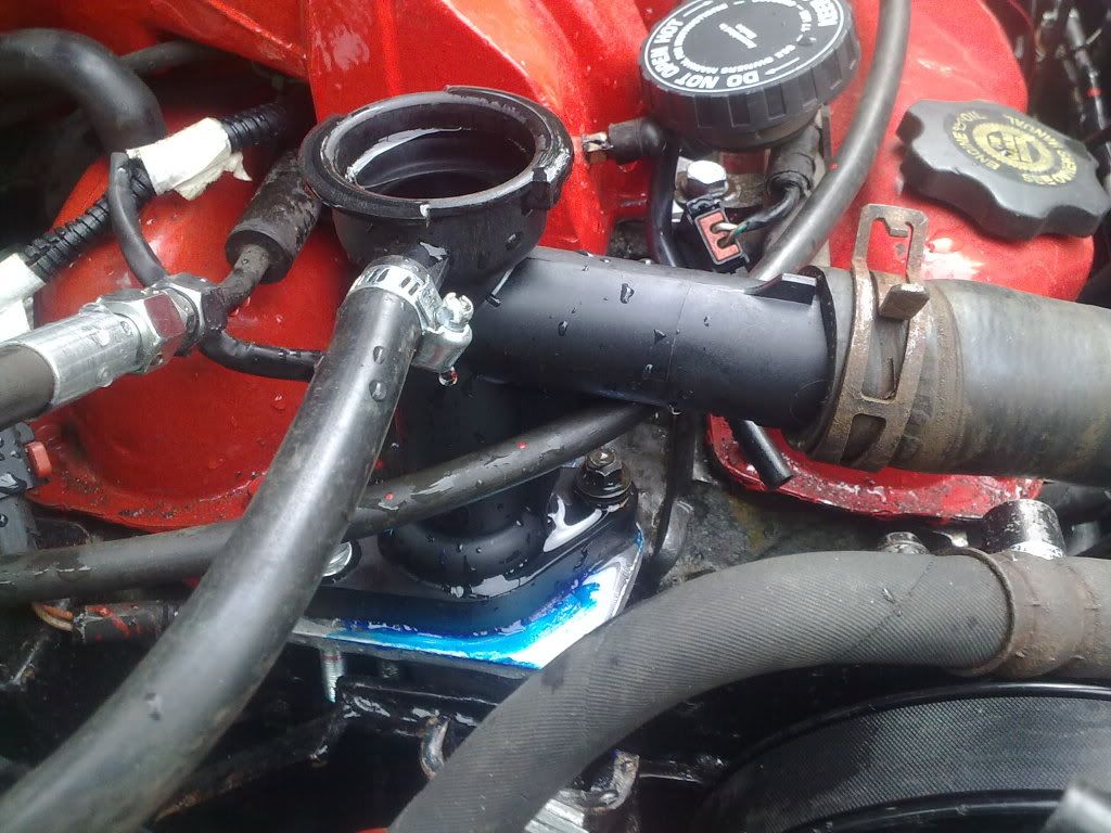

Between the adapter plate and the engine I used plenty of gasket
seal paste, and the same with fitting the thermostat and fitter neck.
I think that the upper radiator hose will need to be replaced soon as
it looks lik it has seen better days.
I have filled the cooling system with just plain water so if it leaks
then if the dogs try to drink it or it ends up on the plants or drive
then there is nothing to worry about.
Once filled it will be left over night or for a couple of days to see if
okay.

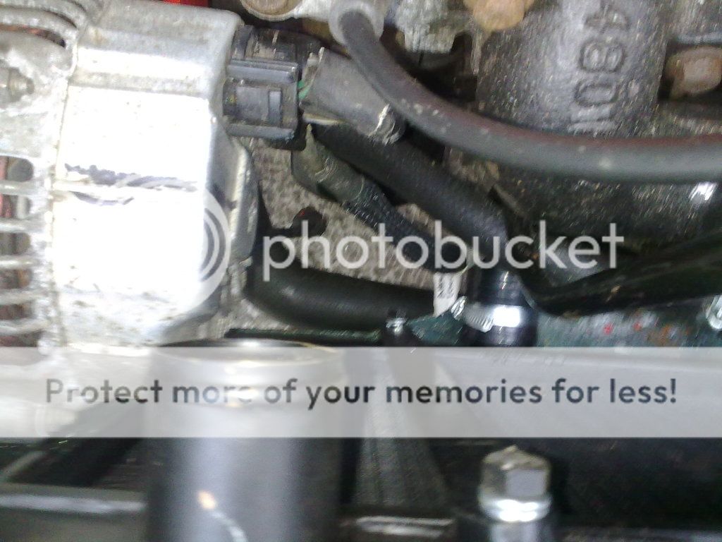

After most of the bent fins on the oil cooler radiator had been sorted,
it was mounted to the rear of the main radiator.

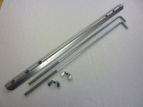

Another thing I ordered of the Bay of E rather than spend time and
money going around scrapyards trying to find one is A battery Hold
down clamp.
http://www.ebay.co.uk/itm/320915055040? ... 1439.l2648
And at £5.80 in total it's a heck of a lot cheaper than paying for the
fuel getting around the scrapyards!

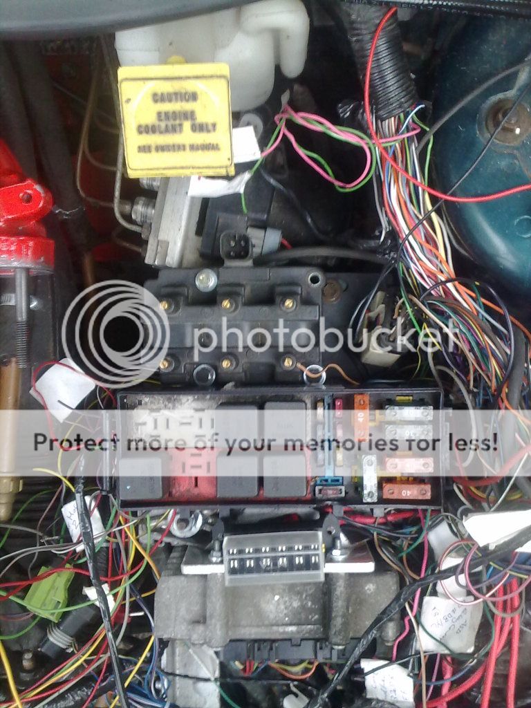

The bad and ugly news, the bluetooth obd is a clone and that the
Torque 1.4.91 software shows it as such when it was connected
to mother's Volvo V70 t5. Also it would not speak to the ECU on
the Volvo's Baud system, it also did state that it wouldn't
connect to certain ford systems. I didn't dare start the Volvo to
try and get runtime signal from it's ECU as it would pump the
remaining water out of it's cooling system(SERIOUS water leak)
So now I am wondering if it will work with the Voyager ECU & TCU!

Don't worry too much about using a cloned adaptor. Sometimes it's just a case of hacking some of the Parameter IDs to work around the conflicts thrown up by the clone. Worked for my adaptor which has been used on - among other thing - a newish Focus and succeeded in identifying its gremlins. ;)

I don't know anything about the neons cooling systems, but do they not use an expansion tank like others?
Glad to see it's progressing
David
http://www.landymann.co.uk
#490 Post by Mitsuru »
ERR David you need new glasses mate as the answer has been
stairing you in the face :lol:
The small pipe which comes off the filler neck, which is also the
thermostat housing. Runs around the back of the engine on the
firewall.
To the coolant reservoir which is bolted on the passenger side of
the firewall.
The Coolant filler cap is spring loaded like most modern cars which
when it gets to a certain pressure uses the reservoir.
