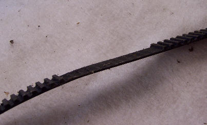

OK less likely to break than a belt but then again belts tend not to snap but the tensioners seize and take the teeth off .. just like this in fact ..
