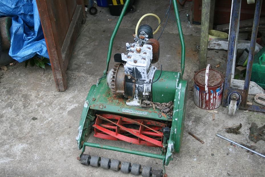

I'd be interested in that engine, don't suppose you fancy another Suffolk machine? (Like yours, slightly older and in the old BAR Honda colours :lol: , not really, just kidding, it's Suffolk green) Straight swap for the hot rod motor eh?

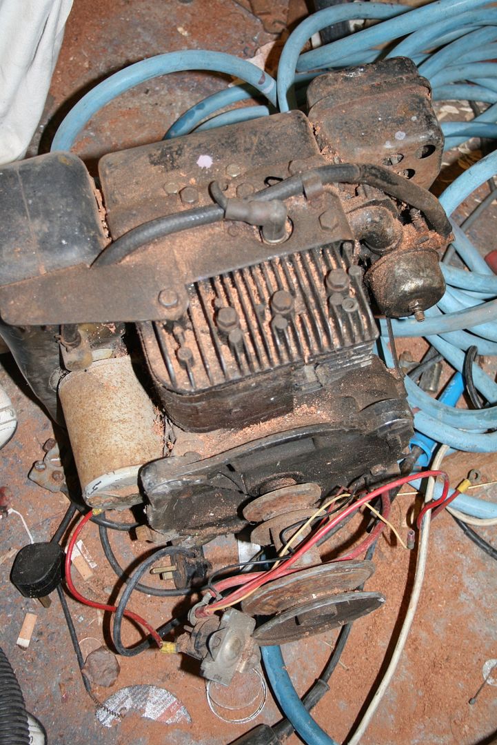

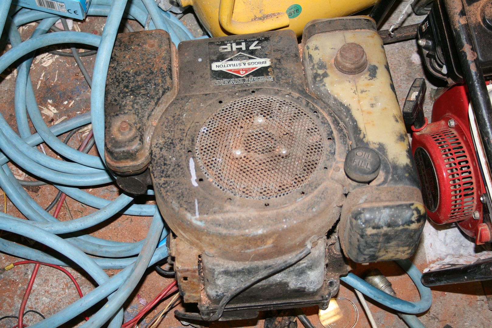

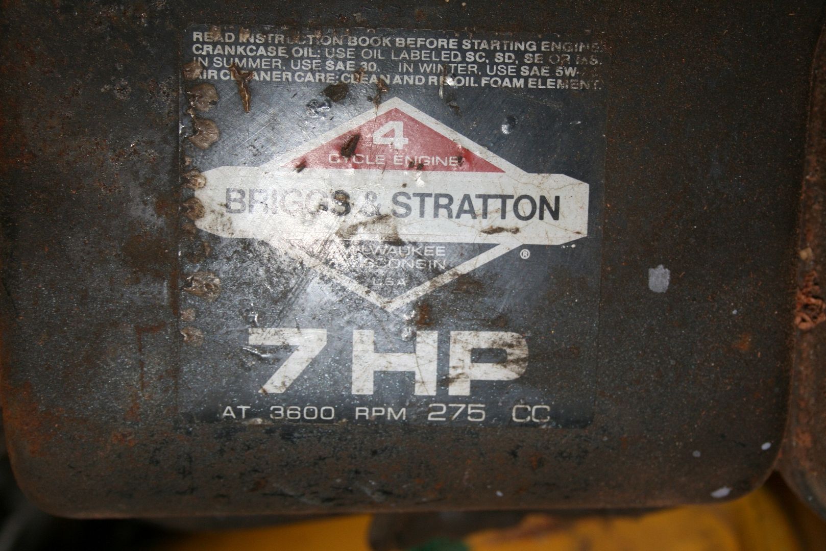

I was wrong , it's a 275cc sidewinder .. Bonus !!
Sadly only 7 hp.. :( was covered in sawdust , it was under the flipsaw and i've been sawing up mahogany :oops: Tinware is a bit speckley with rust ,like the thin paint on mowers goes.. I'm an expert on mower paint ;)

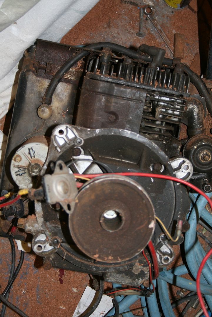

It's now a runner, at least ,on sniff . No oil in it . There was no spark , so i whipped ( belted hard :oops: ) off the flywheel , and it's the old points and condenser ,so its pre 1980 .I'm an expert on mower engines . Cleaned points and fat juicy sparks now . A shot of sniff and it fired ,but daren't run it without oil...and it was only balanced on a workmate . If you want it I'll look for a big box .
