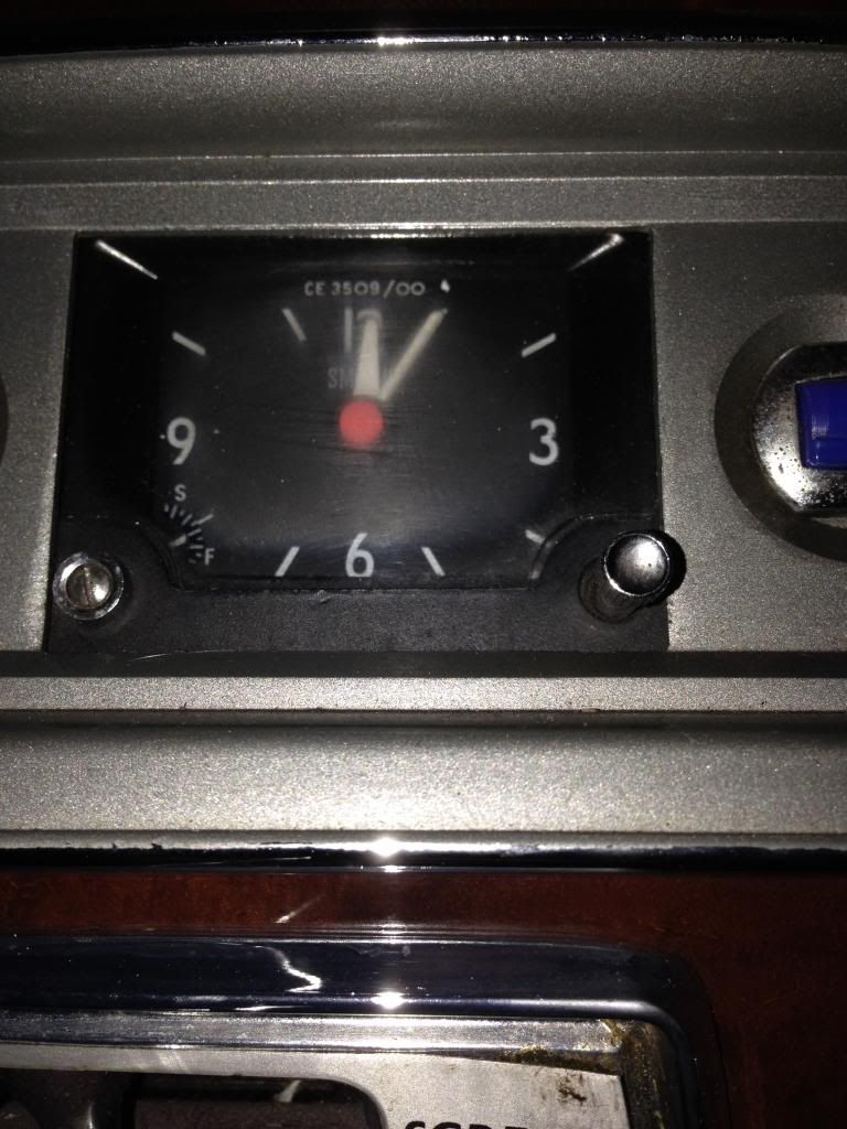

This is the only visible terminal, im assuming it earths through the casing?
One more question..
On the 2nd picture, bottom left, there is a scale just to the right of the regulator screw. what is this?

That scale shows how far from the arbitrary "normal" position the regulator is set at, F to make it run faster, S for slower. The only clock of that style that I've seen (in a period moulded accessory dashboard that came with a mini I once had) was wound mechanically using a pulse from the battery that was sourced from the same terminal as its dial illumination, on the cold side of the light switch. In that case the mainspring was a little short as a result of an older repair so it used to run down far more frequently than it should and I used to have to switch the lights on roughly every three hours to provide the supply to wind it up again. It soon went the journey to be replaced by a discrete DC qu***z movement that was fitted to the original face.

Surely that clock is the sort that has an electromagnet that gives a pulse to the balance wheel. Not terribly reliable, I've had several on 50s and 60s BMC cars and they fail when the contact pin on the balance wheel burns through. You need a permanent 12v feed to the terminal on the back and it earths through the casing, as does the panel light which I can just see at the top.

Well if it is that type, then you could fit the sort that the number suggested it was that uses a conventional, wind up movement that's kept wound by motor pulses supplied from the battery. The one I had in that accessory panel in the mini was of the same shape and had that movement which was why I'd assumed it was one of those and that would be a straight swap but sometimes, taking out the original gubbins and fitting one of these single AA cell clocks that can be bought at craft shops for very small amounts of cash is the way to go, especially if you're the sort of person who can't take the sight of a clock that's not telling you the right time!
