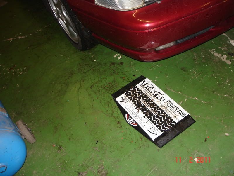

One of the first type mate - the sliding type - didn't even know they made a laser one.
Here it is being used on my Volvo:
