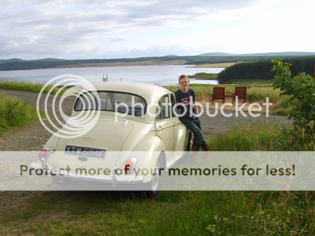

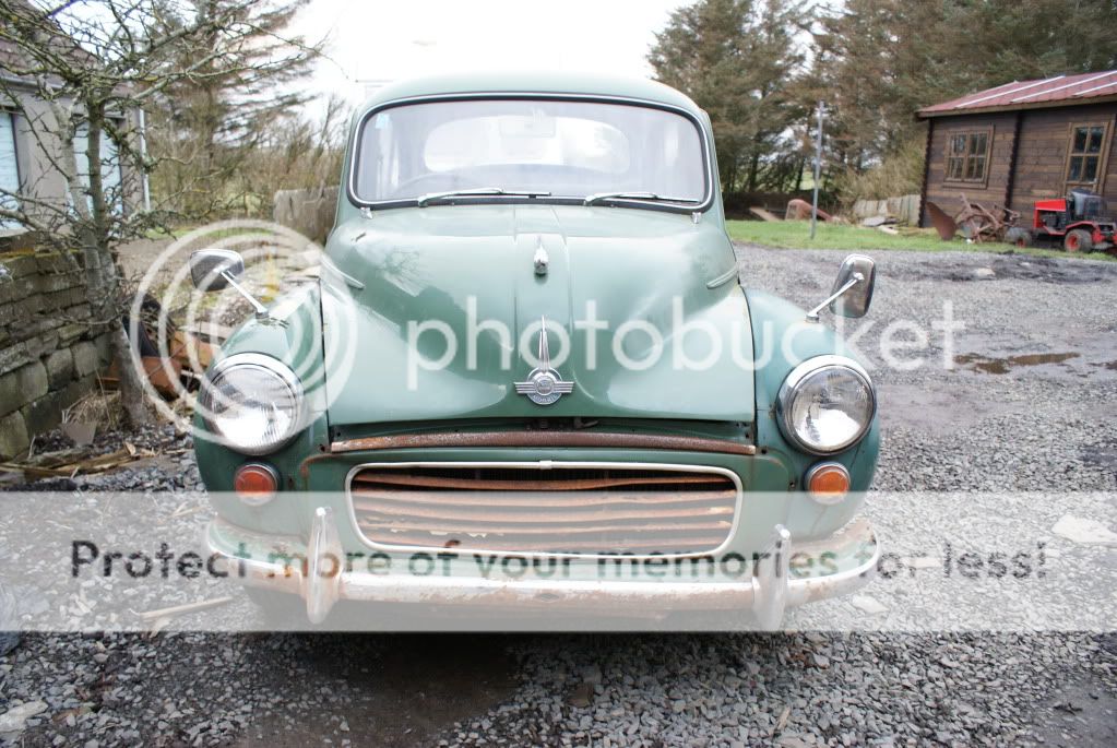

If it helps inspire heres the one I had a couple of years ago
First as a £200 quid rotter
Then as a 1275 converted welded up machine (It@s the lad in the picture, I'm not that young :cry: )
Go on, you know you want one :)
