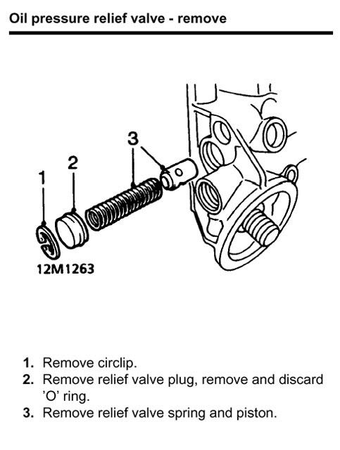

#2 Post by JPB »
And that right there is the most common cause of low (or excessively high) pressure if you're talking about your RV8. ;)
