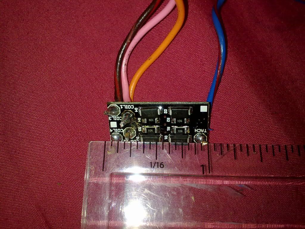

I have found after a little research a cheap tach adapter $10 plus postage.
This small board adapts a Tachometer to up to 4 individual coil packs, capable
of handling 4, 6 or 8 cylinder wasted spark applications
Installation is straightforward:
* Connect Coil 1,2,3 and 4 to the drive signals to each coil packs as necessary.
* Connect the tach output to the input of your tachometer.
* Wrap the board with electrical tape or shrink tubing- the board is small enough
to integrate into your wire harness / bundle.
Example Wiring
Here is the the web address
http://autosportlabs.net/TachAdapter
I have purchased one from their website with paypal.
So I will try it when it gets here in about 2 weeks time.
This could be used on other vehicles for engine swaps etc.

Okay as there was no real scale to the photo with the tach adapter.
And that is 15/16 of an inch.
please look at my engine swap to see it get wired up.

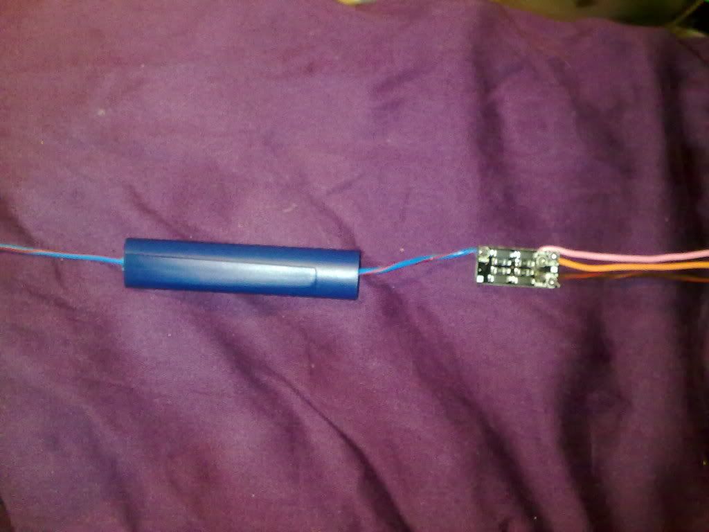

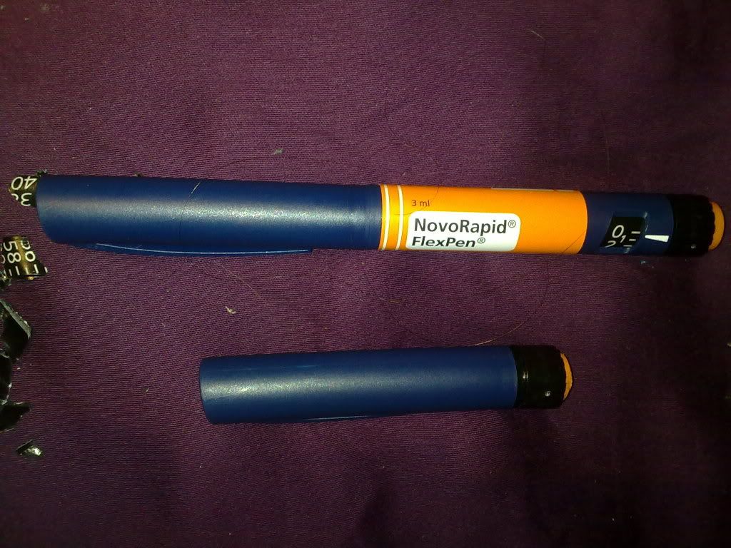

As I have plenty of used insulin pens, and the cap/cover is
the right size I decided to use a bust one as a holder and
protector for the tach adapter.
I show an undamaged insulin pen next to the cap and
snapped off end how it will go together.
(the insulin cartridge was undamaged)

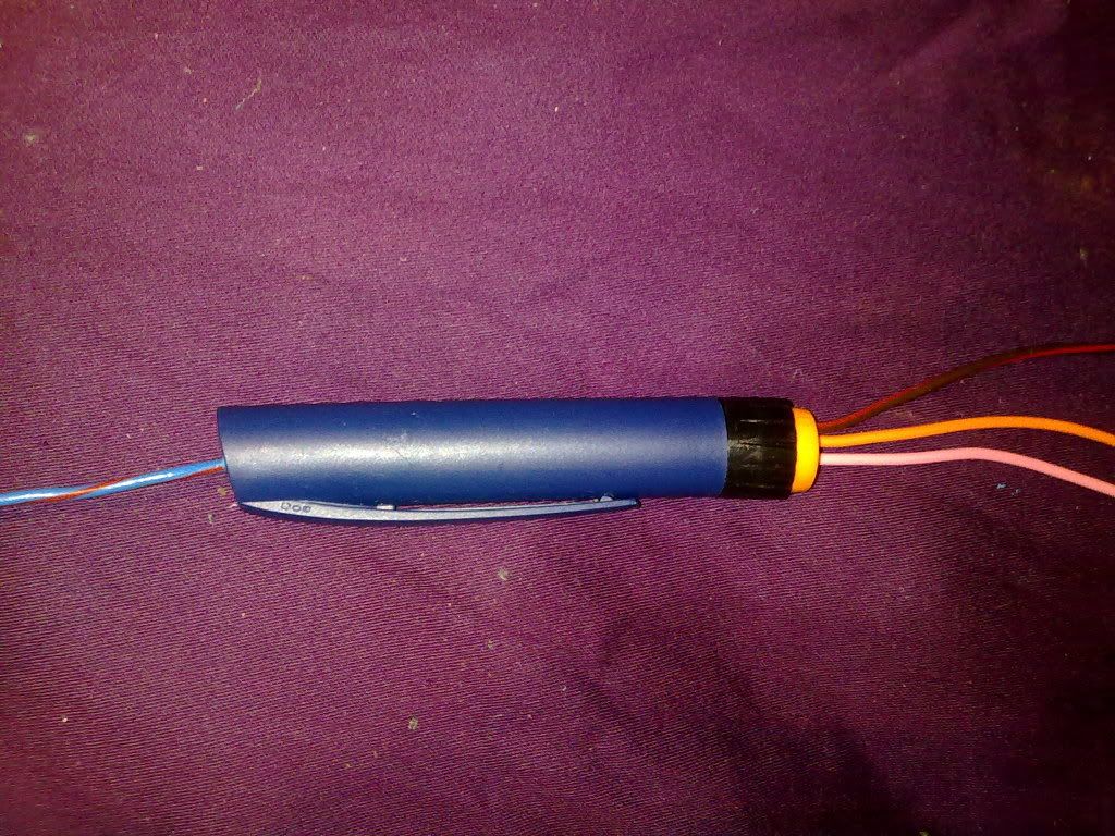

Almost done the below picture is before I used gasket
seal to glue and seal the bits together.
