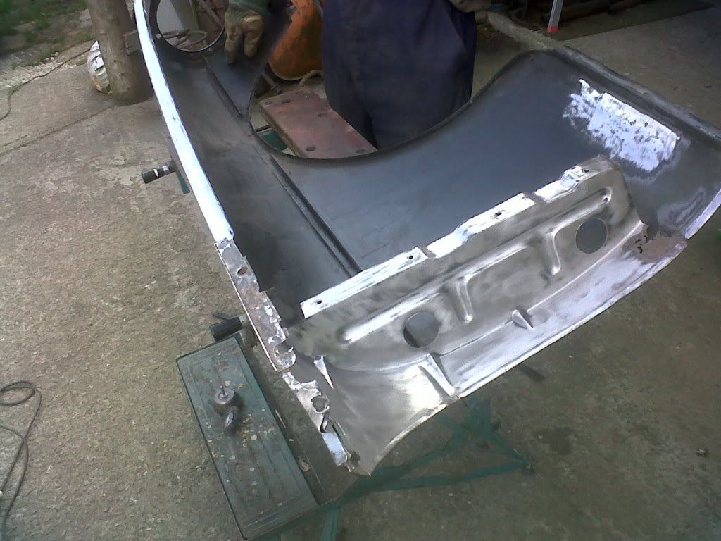

The rear was in a bad way. Cut boot out and rear panel.
Since welded in boot panel but needed to repair the bottom edge of the rear under the lights.
New panels for this section ar enon exsistent unless you spend £500 a shot on the whole side panel as well.
So set about cutting out the rot to good metal and making my own repair panels. Welded in bit by bit to avoid warp, ground down and then leaded. Since fitted the new rear panel will post pics.

First I welded the new rear panel up where it wraps round the sides to join the rear quarters, leaded it after grinding and gave a skim of filler splashed with some red paint I had about ready for a final rub down -
Also welded in and ground down the rear panel where it meet just by the rear lights area. Again leaded and skimmed wih filler and splashed with paint ready fro final shaping and smoothing. Started recreating the two seam lines at the rear but changed my mind, going for a totally smooth rear end -

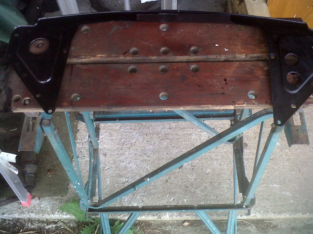

Then we dedcided it was time to stip everything underneath ready for the new lower front spring and uprated rear leaf springs and bushes. Firs tto go was front cross member with the discs suspension etc on it. Just 4 bolts and its out thankfully I had been dousing everytthing in WD40 for months in prep, got it on the work bench , time to pop the springs out -

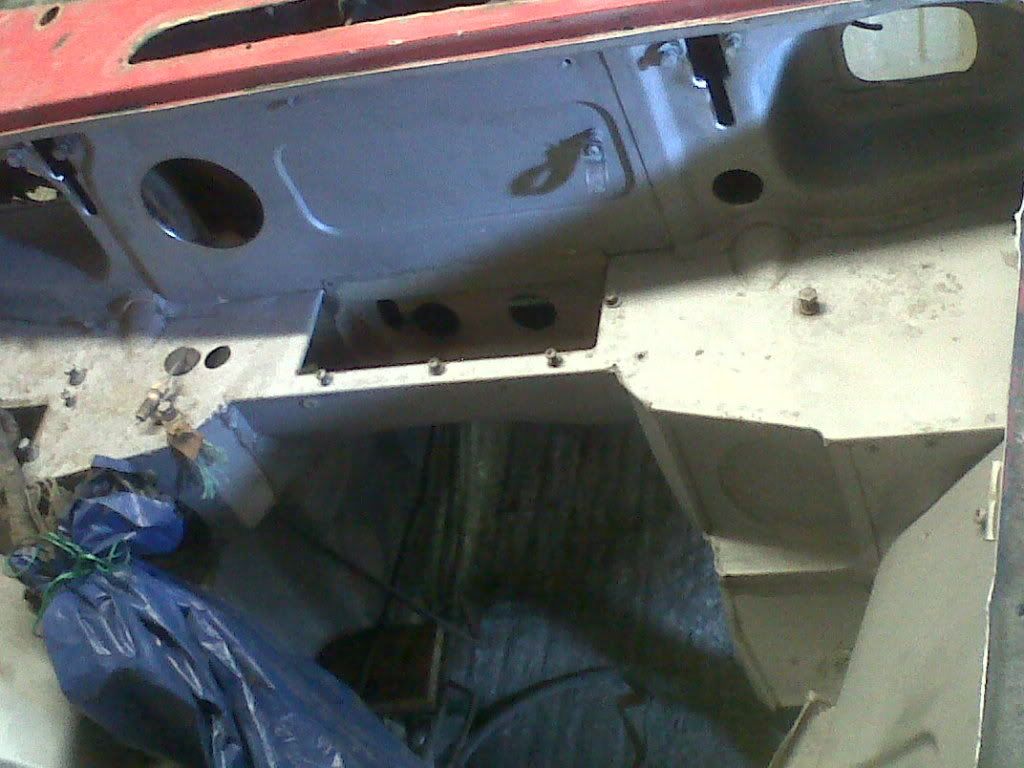

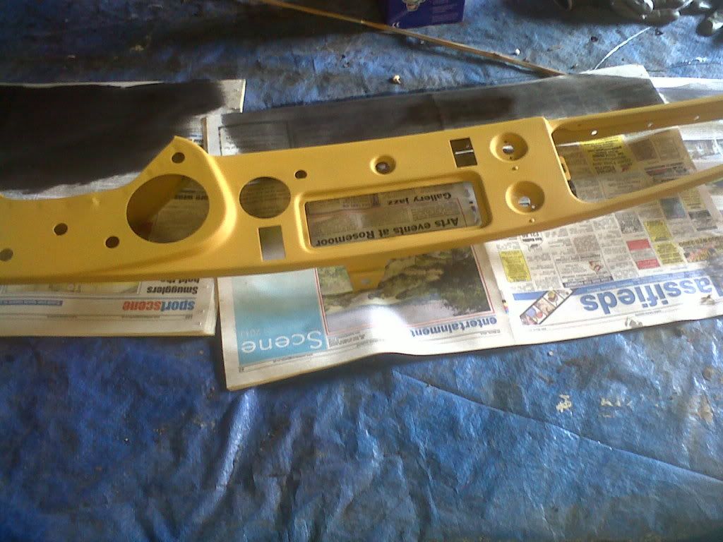

First job on the MGB was sandblasting the dash off paint and covering in primer ready for the arrival of the new crinkle paint

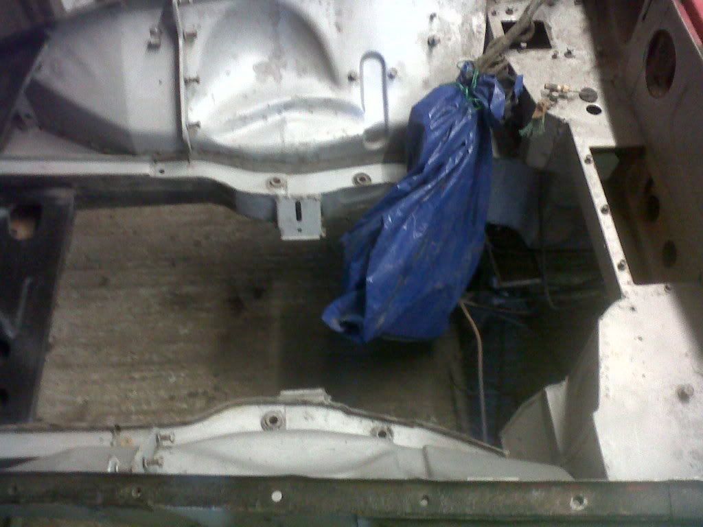

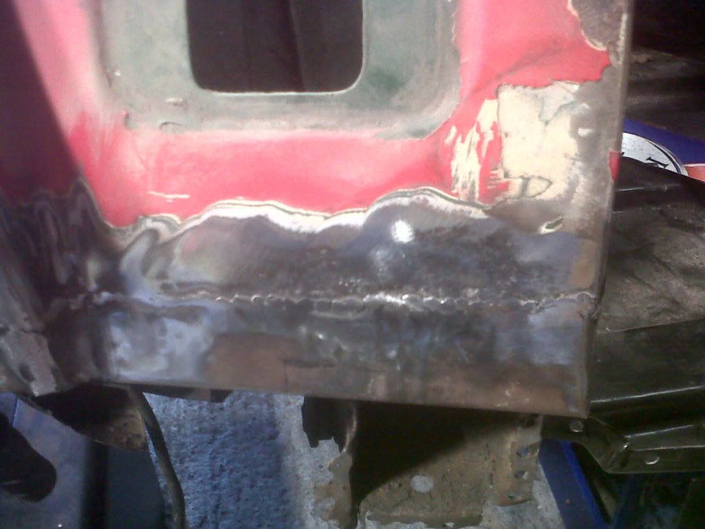

When sandblasting the engine bay I found it over all very good. But there was one small section of rot on the left side towards the top. It needed to be cut out and new metal put in. I had covered the whole engine bay in weld through high zinc to protect while I get round to painting, so not problem welding to.
Iused the old "card and dirty finger" to size up the patch as I wanted to butt weld. Covered the patch in weld through to protect the back well. Was not happy with neatness of welding as just could not get enough light wilth the mask on in the garage and difficult angle, I had wanted not to have to use filler at all. But int he end after grinding it did need a small skim to be perfectly smooth. Trying a new filler as Im alway parnoid the normal stuff absorbs moisture if not painted right away. So this one has metal in it so less likely I guess?!? I also put a little filler ins some areas that has some pitting to give a pefectly smooth finish. THen covered it all in the high zinc again ready for normal primer then the paint.

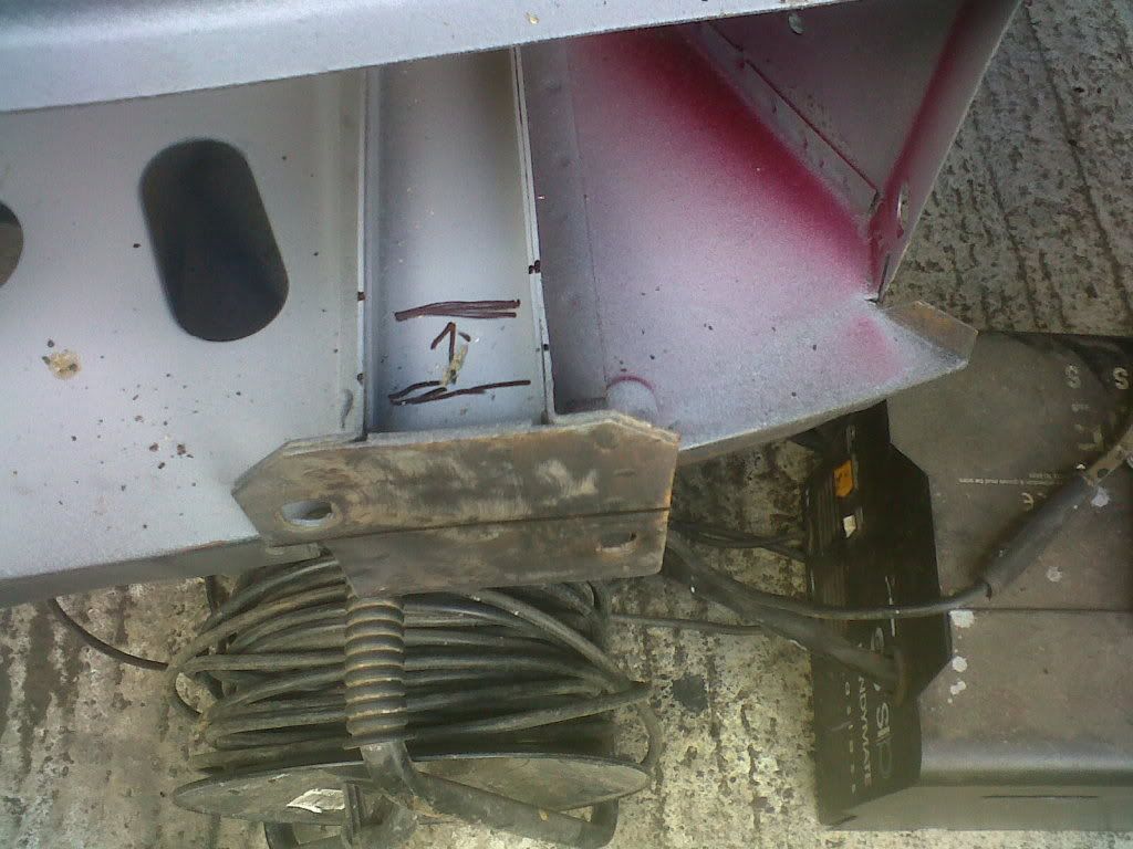

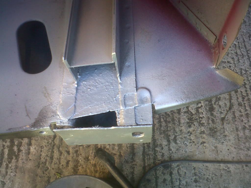

It was also time to start modifying the front end for the chrome conversion. I needed to trim back the chassic rails to allow the new grill to sit further back. I did not have time to cap them off yet, thats the first job this week.

Capped off the chassis rails where the chrome conversion is happening, and decided I wanted to add a little filler to try and get a proper factory finish (not that 79 MGB where that neatly put together lol!)

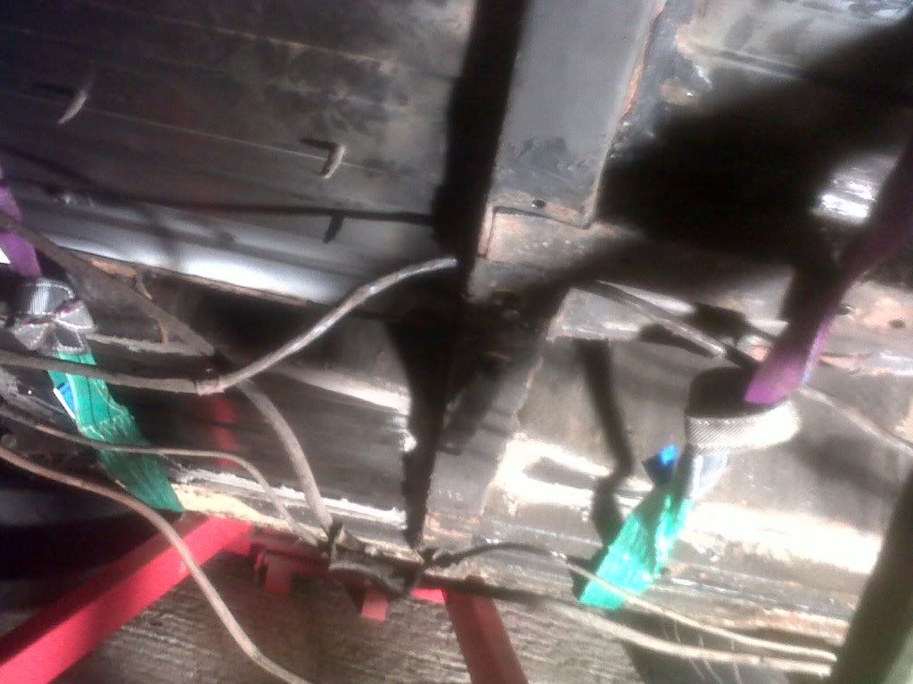

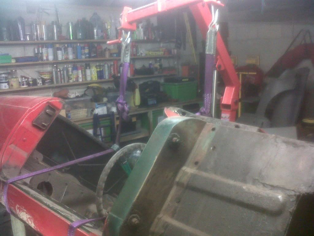

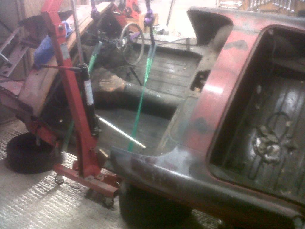

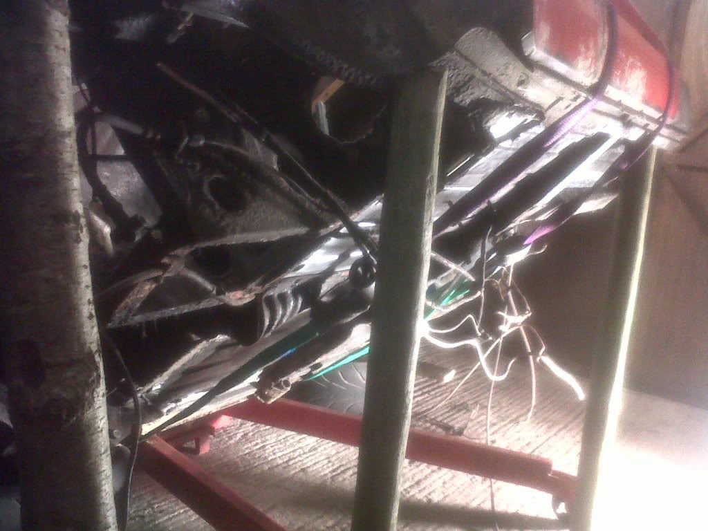

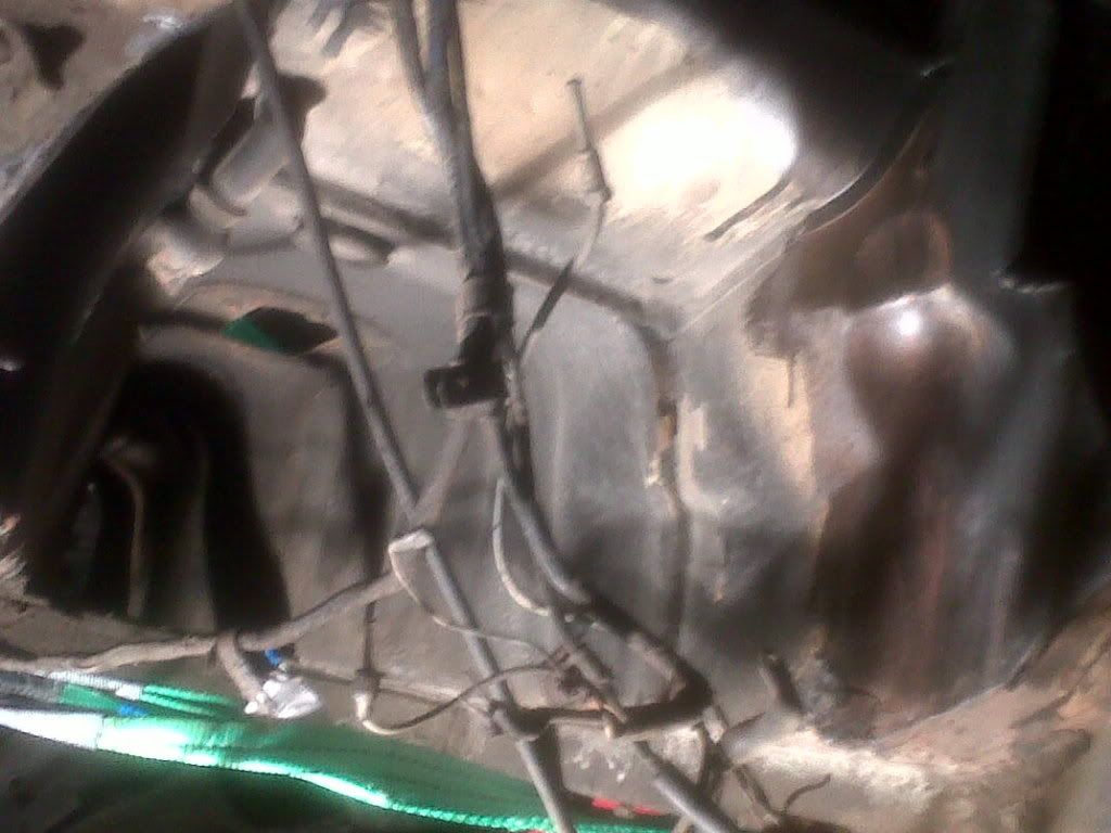

I got on to turning it on its side with my fathe rin law to attack the old underseal, fit a new jacking point and seam seal the floor pans and boot floor I put in a while ago.
Used the engine crane and 2 straps to winch up on side with some slicks intended for the alfa 75 to protect the side. I was not trying to get completely over ,I wanted it support to stop and panel damage.
Supported the otherside with posts in case the engine crane gave way for any reason.
Transmission tunnel lookk ok going t clean all off though and use a rust paint and the undereal, is Omnicoat a good choice for this?
Not masses to do under the centre of car becuase of the new floor pan, you can see where I started the seam sealer but not finished as was a struggle on anle stands. You can also see the chassis rail repair at top of the pic and where the jacking point is needed.
