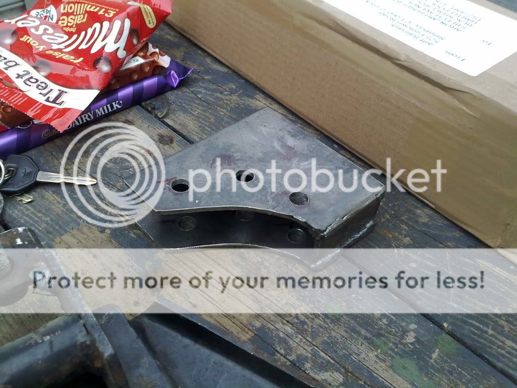

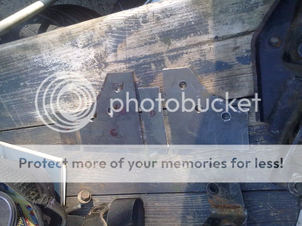

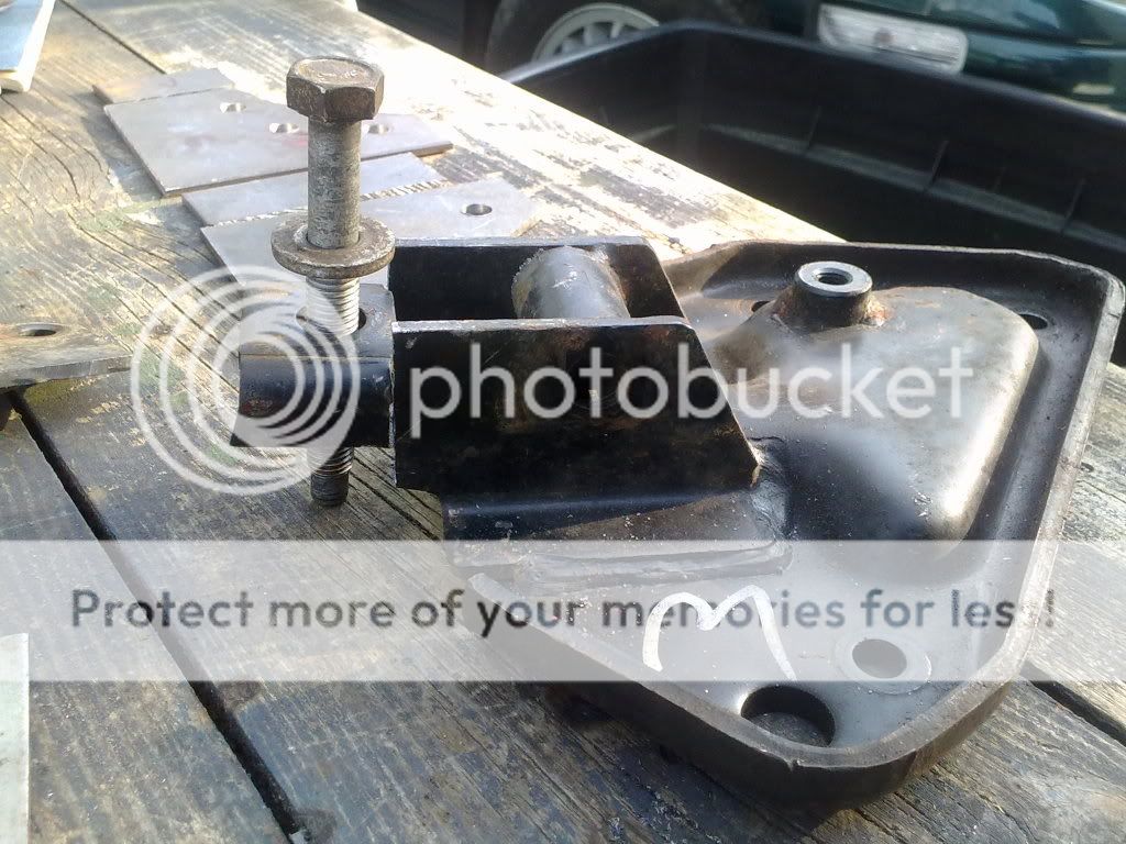

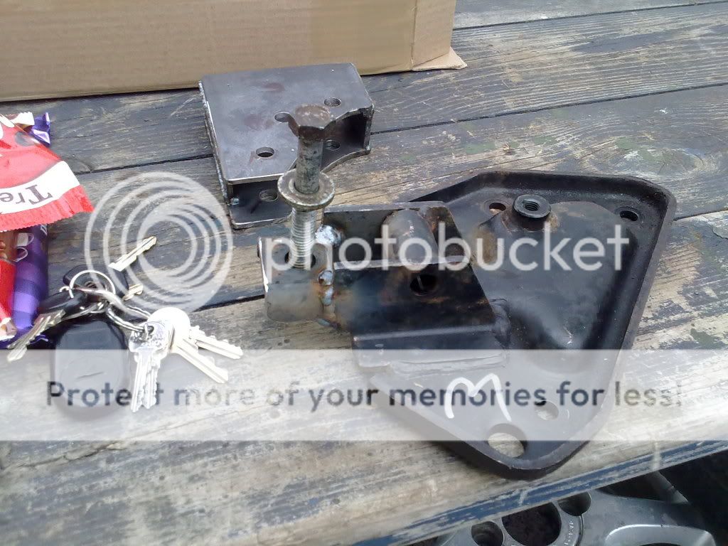

Out came the jigsaw this afternoon, and a little more work on the front engine mount.
I made the pieces for extending and adapting the transmission mount.
The 2 main plates will be bolted together so a grinder can be used to get the cures correct,
also so can make sure that the mounts holes are spot on.
I then made a start on the V6 side engine mount, where there was a bolt that went through
the top to hold a bracket. This was cut off and moved to where it will be welded and
photographed.
Yes it still needs a little trimming for the belts etc.
My farther will be doing the welding at the weekend, so I have to get all the parts cut & labelled
what goes where ASAP.
Tomorrow the ancillaries!!
Or if the intake manifold gasket turns up, I will be making a mockup of a new intake manifold.

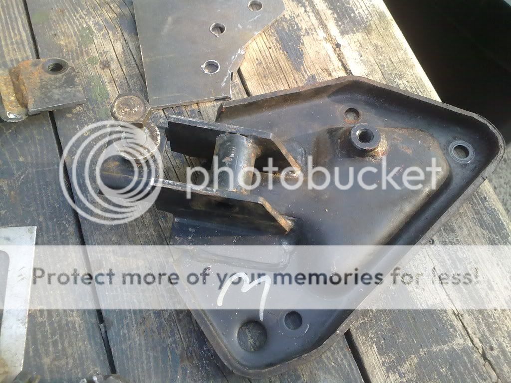

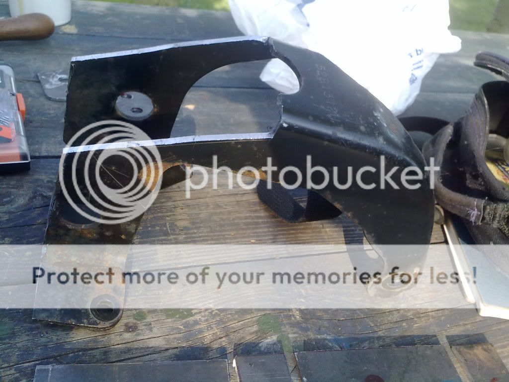

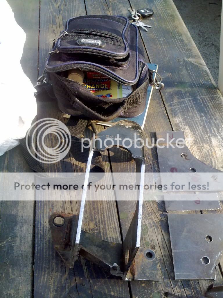

#52 Post by Mitsuru »
Dad did a little welding for me.
The transmission mount, just needs three holes for the neons mount.
The Side Engine mount

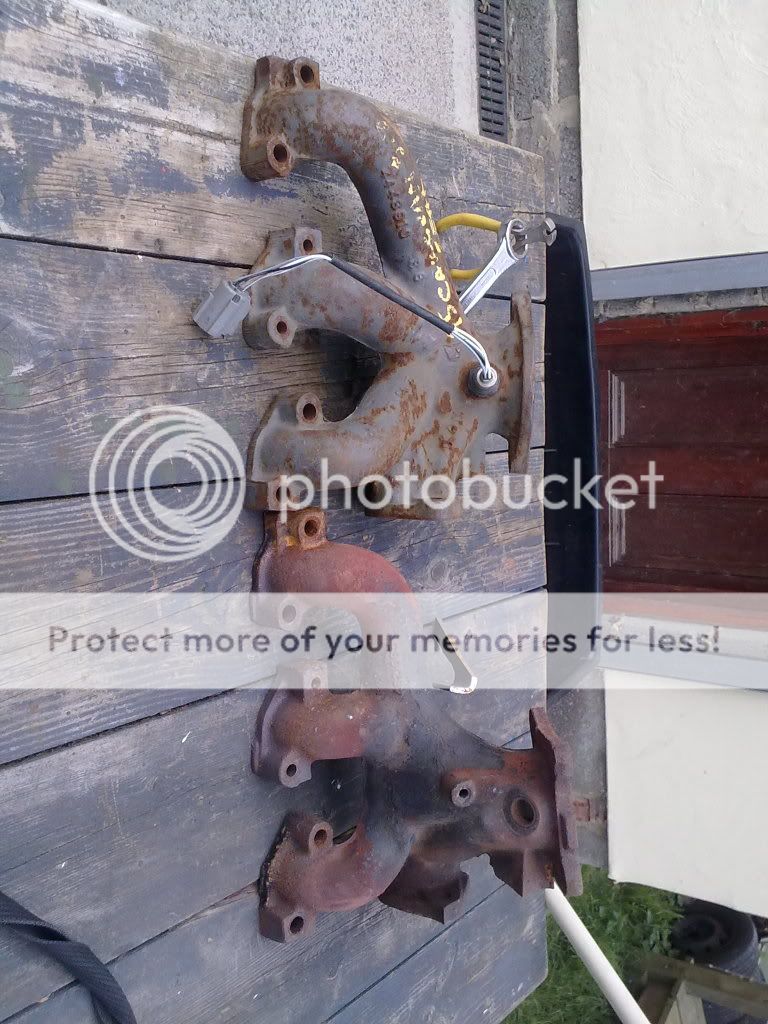

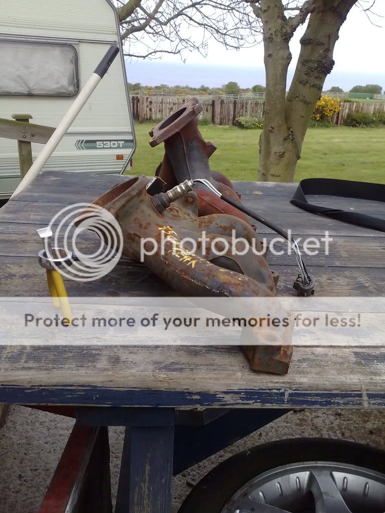

Guess what arrived ot about 9am
No packing just a fold of cardboard taped at both ends not very secure.
I paid $80 for postage the dispatch/usps labels says it was $62.04
So if an exhaust manifold which isn't light costs $62 how can people justify
well over $100 for a set of headlights or something smaller weighing less.

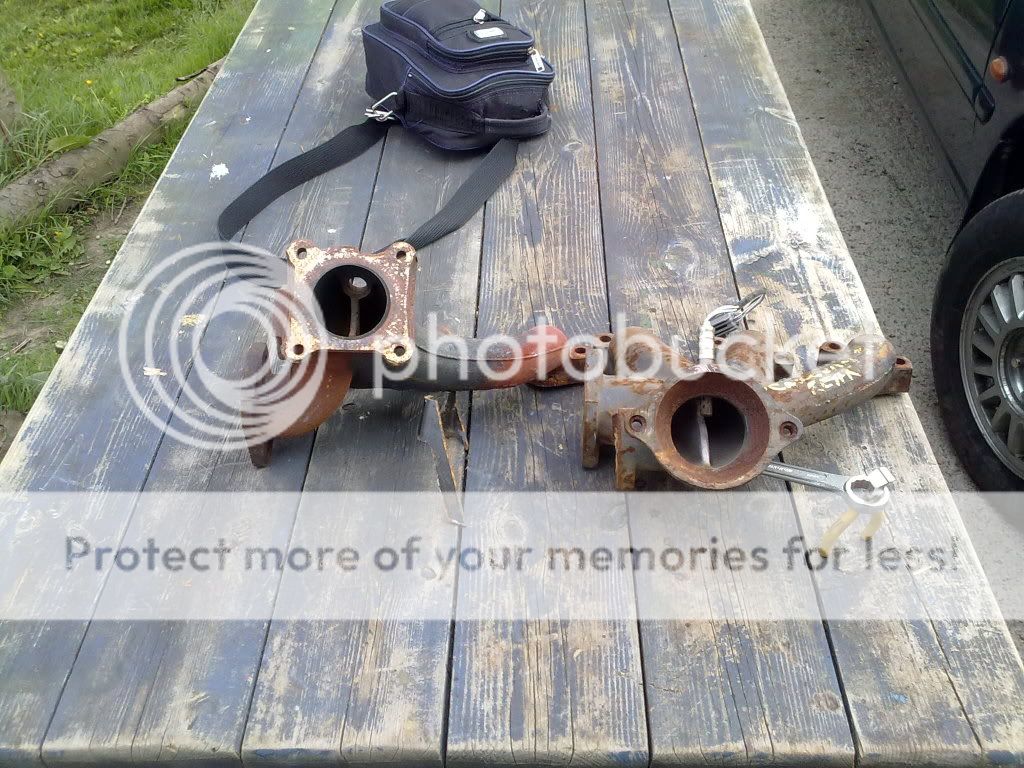

I placed both Voyager exhaust manifolds lined up on the table outside the
garage, spanners and a pair of wire cutters to prop them up as though bolted
to a flat surface. This is to show how much difference there is between the
positions of the outlets.
I couldn't find a picture showing this on the net, so I did one for comparison
reasons.
I previously stated I might have to tilt the engine to make clearance for the exhaust,
I don't have to now thanks to jimbo pointing me to the right exhaust manifold.
So since the back doesn't need moding, and my engine is 2 inches lower than jimbo's,
can i get away with the exact same intake manifold?
Jimbo's intake manifold doesn't have exhaust gas recycle but that can be installed as
it's not cast iron but it is alloy or aluminium.
The manifolds I have seen aren't as low a profile as Jimbo's unfortunately.

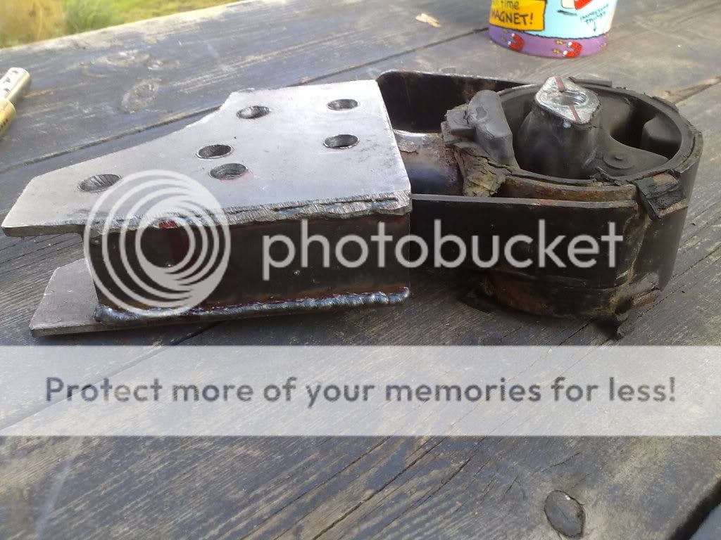

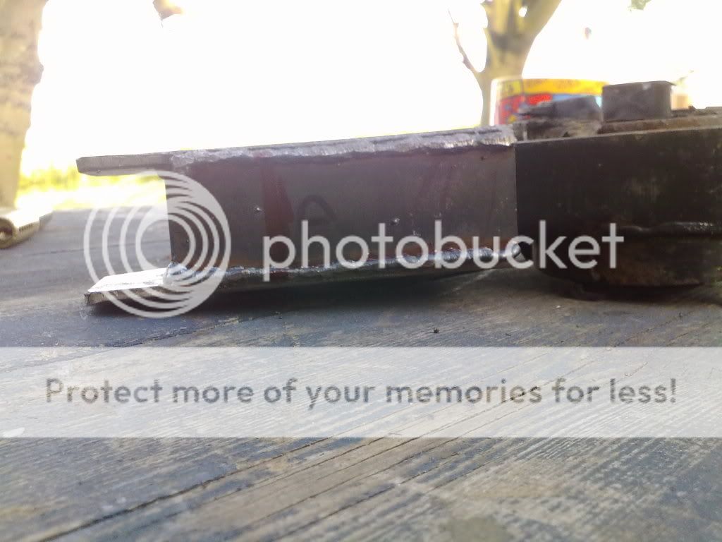

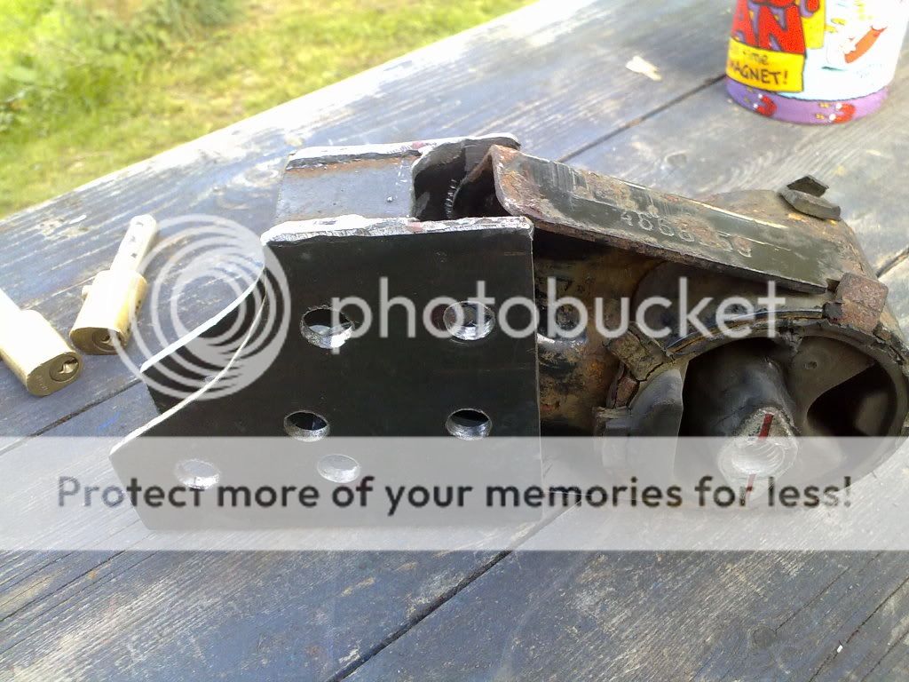

A little more work done on the transmisson mount, holes drilled for receiving the old
neon mount. I have removed part of the side plate that was welded in, so the mount can
slide in to be easily changed.
The picture below shows the untouched side yet, but from the red line to the right of it has
to be removed. Then a few bits of tube for the bolts to co through and give it more strength.

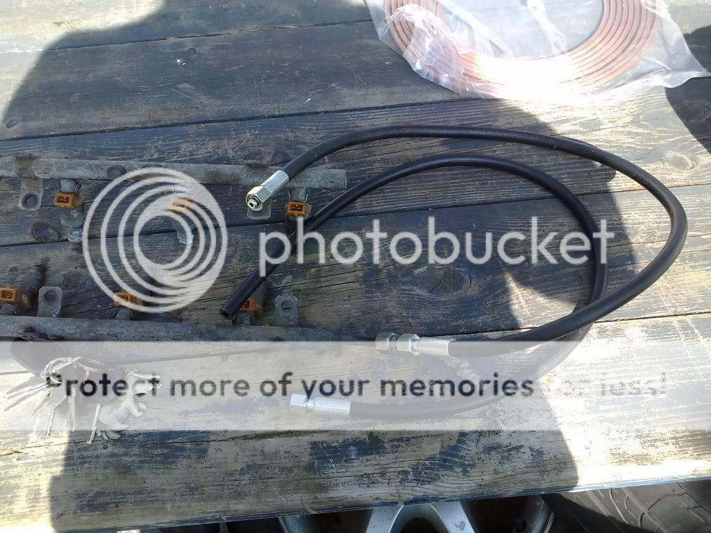

I spent this afternoon going from one company to another to get the fuel rail sorted.
Eventually I came to a company called Northern Hose & Hydraulics in Middlesbrough,
Who cut off the old crimped on hose, the put a compresson fitting on and made up
two flexy pipes so the fuel rail could be connected to the new copper fuel lines to the
tank.
On one both ends of the flexy line has screw type fittings crimped on, so that i can find
the correct attachment to connect to the 1/4 inch copper pipe.
On the second flexy pipe only one end has been crimped with a connector for the fuel
rail end, the other has be left for me to make up that connection how I see fit.
So I have 2 options for the fuel rail. Cost inc tax £20.
I had been phoning around about connectors for the 1/4 inch copper pipe.
Not one person even asked or stated the size in millimetres, 1/4 inch is 6.35 millimetres
or near as dam it 6mm. And nobody does 1/4 inch but ask them if they did 6mm!!!
