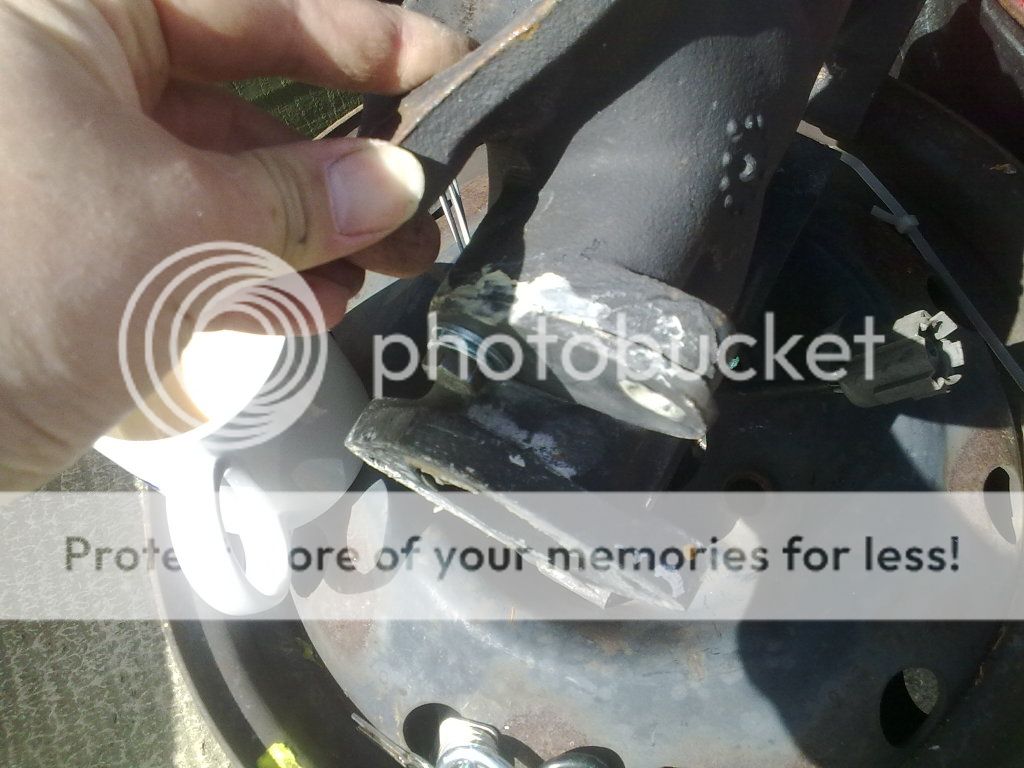

Well I thought it best to take the rear exhaust manifold off,
and see what the damage is.
For some reason It only took 20-30 min to remove it from the
car! I hope it goes back on just as easily.
I had a doctors appointment in the afternoon, so I put
everything away and when I came back it has been showers
every so often so no further work done.
I will drill and tape the manifold tomorrow.

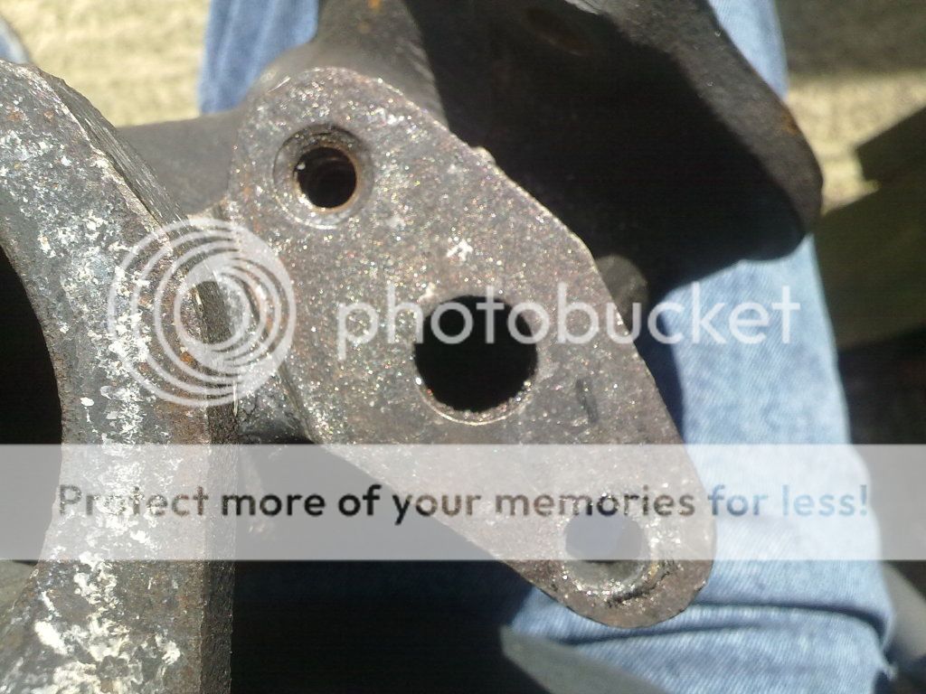

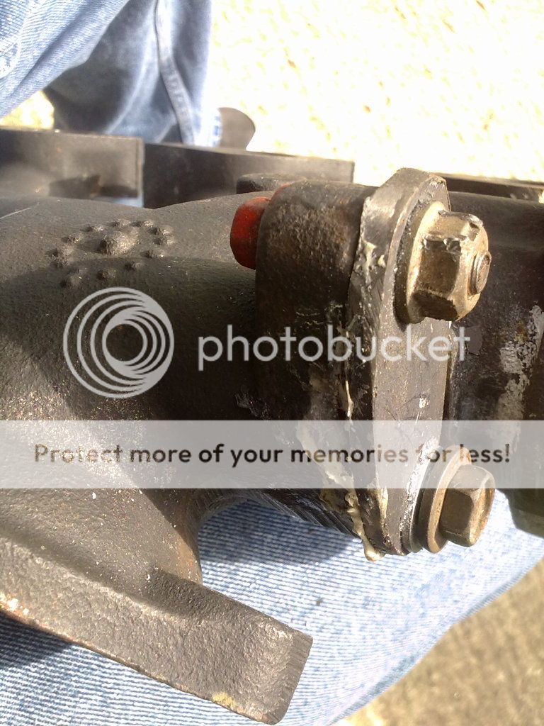

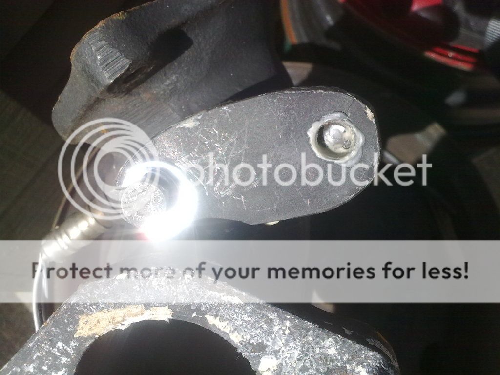

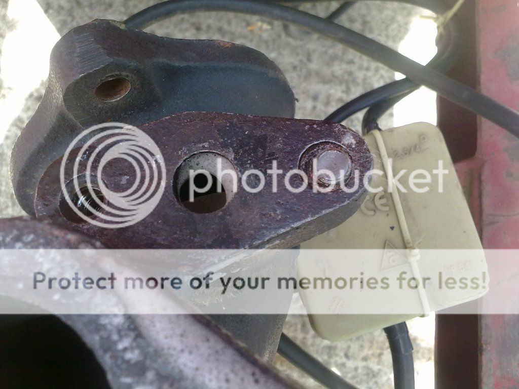

As it was a nice fine day, I drilled and tapped the hole which
the bolt had snapped off in. Only for the replacement bolt to
do the same!
This time I drilled the hole bigger and didn't bother tapping it.
A nut and bolt job, with plenty of exhaust assembly paste.
I spent a few hours putting the manifold back on. the nut for
the side pipe connection to the rear manifold was the worst!
I ended up jacking the car up and lifting it as high as possible
so I could get under and tackle that problem nut.
While I was under under there I plugged in the speed sensor,
the power steering switch, and right abs sensor.
I hope I got the abs sensor and the power steering switch the
right way around.

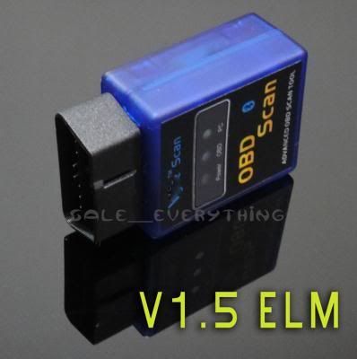

ELM327 v1.5 Bluetooth Mini Small Interface OBD2 Scanner
Ebay £7.38 inc postage from china (hope it works!)
http://www.ebay.co.uk/itm/180869652454? ... 1439.l2649

Those cloned adapters from HK work but you'll need to download and install this A.P.K. and it's worth paying for the licence as the free version is OK, but can FC under load, especially if your machine doesn't have BT3.
That scanner won't re-set the service light.
Looks like I will have to get an emulator as I don't have anything running on android.JPB wrote:Those cloned adapters from HK work but you'll need to download and install this A.P.K. and it's worth paying for the licence as the free version is OK, but can FC under load, especially if your machine doesn't have BT3.
