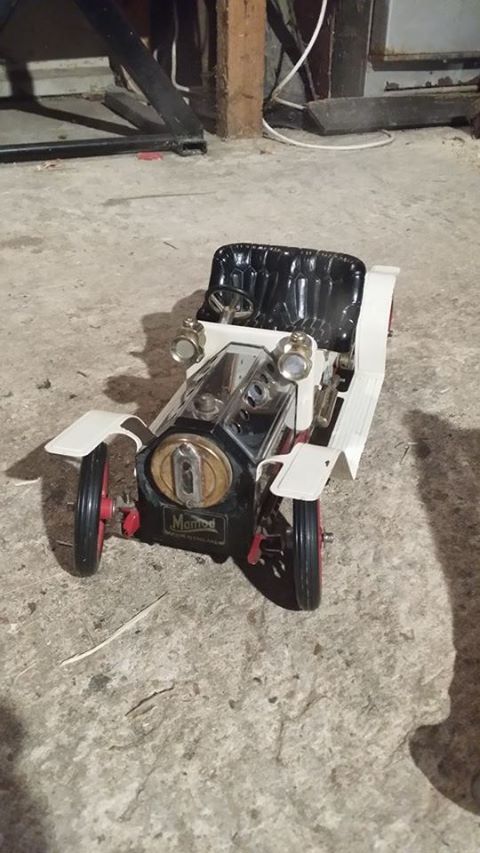

Polishing the brass, straightening the bent rear axle with a hammer, tightening the rear diff as it was slipping on the axle, reattaching the seat, and firing it up for the first time on 30 years. Unfortunately the boiler would not hold pressure due to a crack in the sight glass. :cry:

#367 Post by TerryG »
That's pretty :) looks much better than my traction engine.
