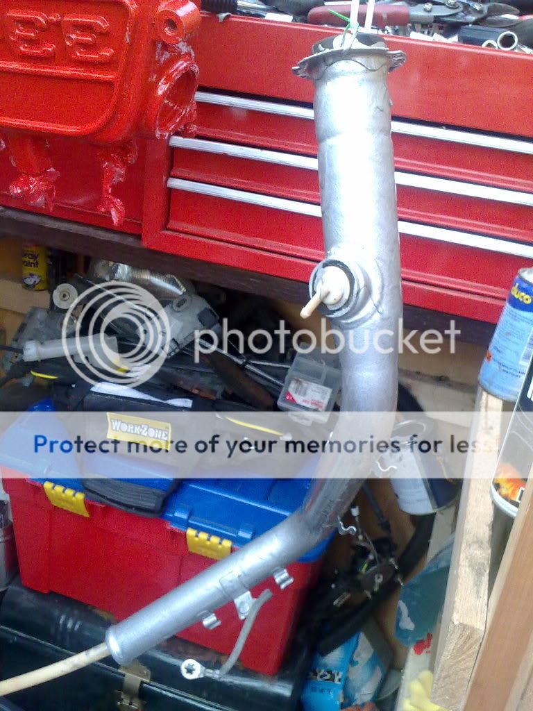

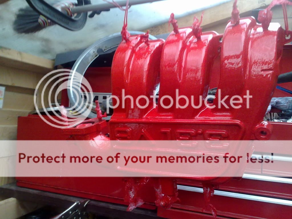

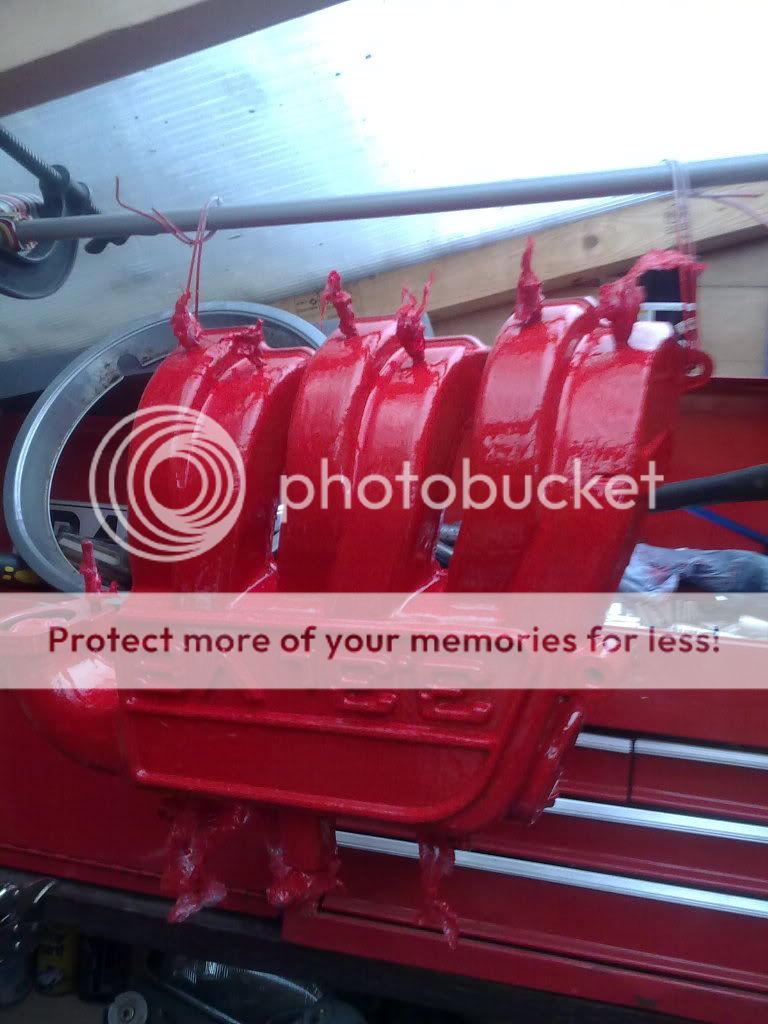

#193 Post by Mitsuru »
After checking that the thin paint that was applied via a spray can had dried.
I sanded the intake manifold back, and gave it a coat of paint from the tin.
At least it covered well this time especially with it being a lot thicker paint.
So much so I hung it from the rafters in the tool shed to help it dry.
If there had been a little more space in there I might have done some other stuff.
But the paint will take a few days to a week to cure properly.
As we are expecting high winds and rain over the next few days of what is left of
that hurricane. I don't know what I will be able to get done outside or in the shed
with the manifold hanging there.

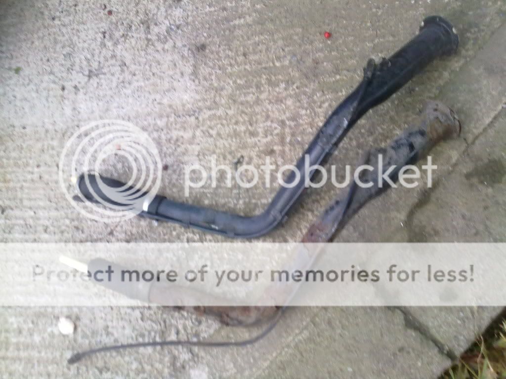

#194 Post by Mitsuru »

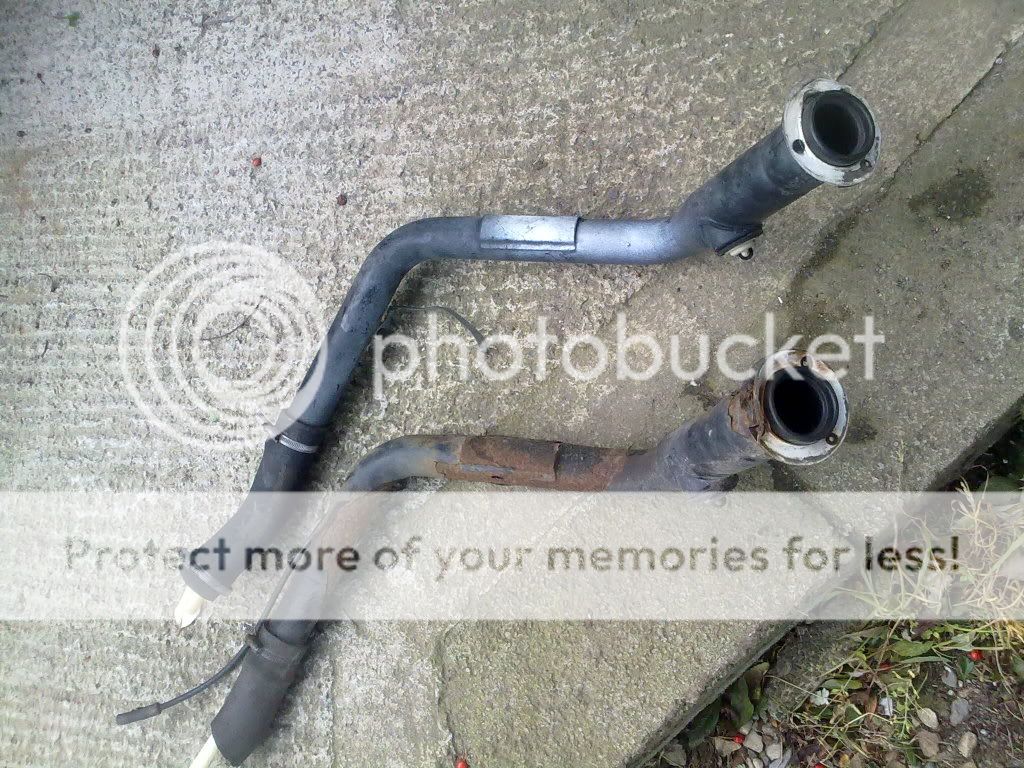

The Fuel Filler Neck arrived this morning at 9:42, Luckley for me my
parents have this week off work so they signed for it!

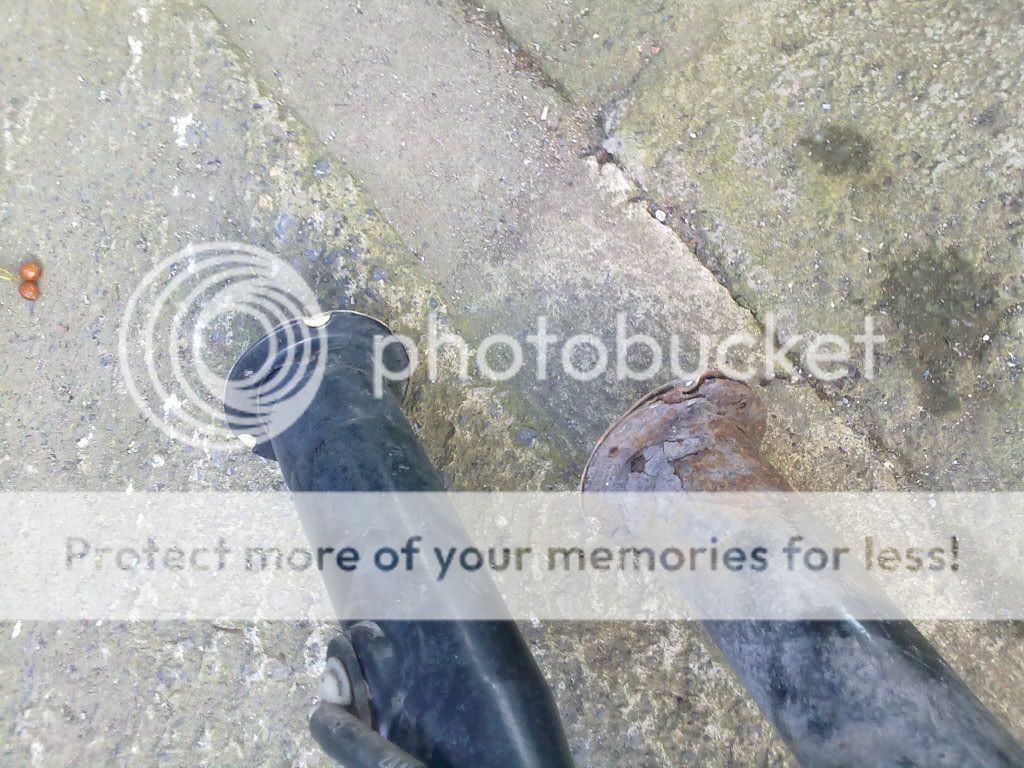

I have put the replacement next to the original, bit are off 1997 Neons
Mine has spent it's life in the North East of England (manly the coastal
areas according to the cars history). While the replacement is off a
Neon that has spent it's life in Texas. Boy can you see the difference
even at a distance!
For added protection I will clean it and give it a lick of hammerite paint.

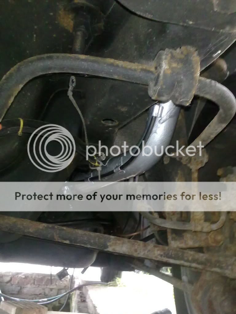

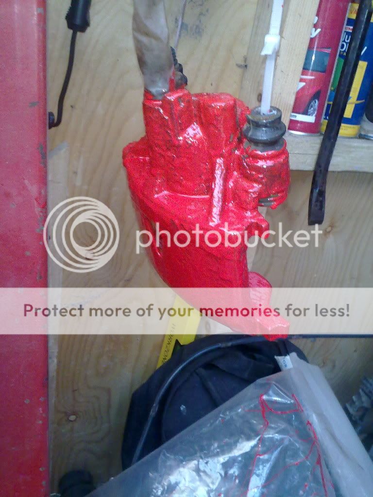

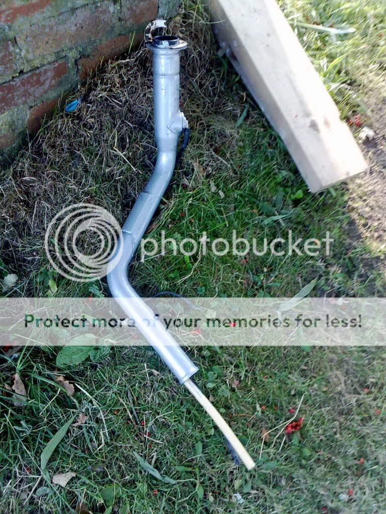

#196 Post by Mitsuru »
The fuel filler neck got it's first coat of silver paint.
I cleaned all the rust and dirt off the front right brake caliper,
then it got a coat of red.

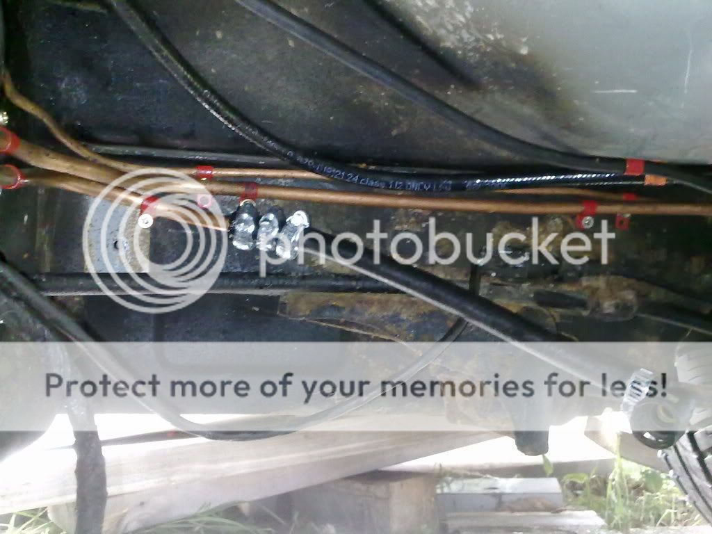

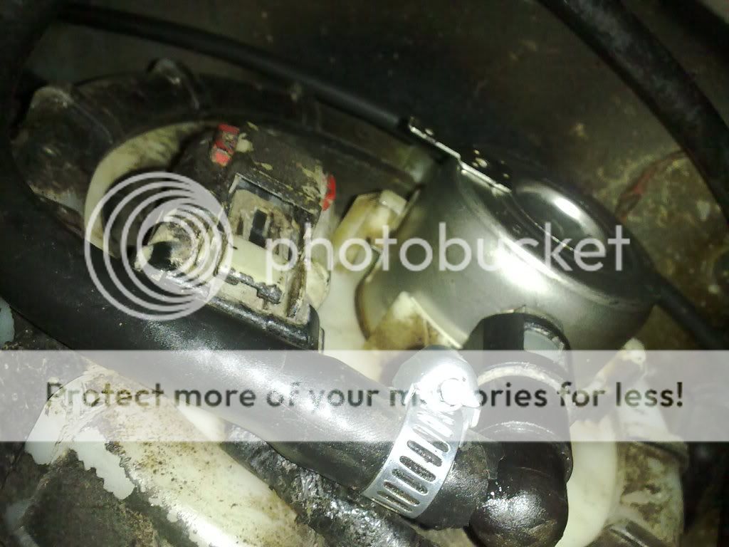

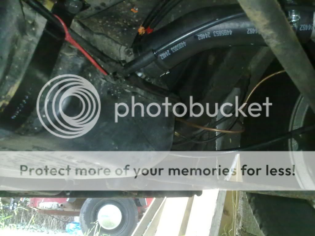

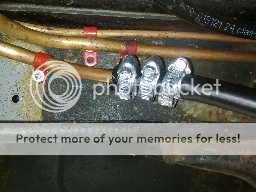

#197 Post by Mitsuru »
Well the paint was dry.
The flex hose is now connected ready for the tank.
I put gasket paste both the the copper pipe and the quick release connector.
The paste acted as a lubricant to get the hose on, and when it set will add,
to it sealing the join.
Yes I put 3 jubilee clips on the hose end which was slid over the copper pipe.
As there was no proper ridge to grip it to better to be safe than sorry!
On the fuel filler neck that I took off there wasn't am earthing strap, there is on
this one and I will connect it up later.
Yes that is a new connector pipe £44 from Rycroft/Kings the Chrysler/Dodge
dealership.
So! thats the fuel pump connected up.

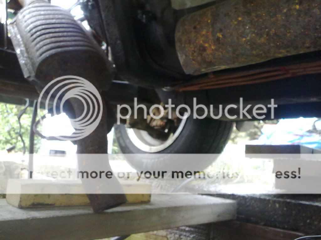

#199 Post by Mitsuru »
In between the showers this morning I managed to get the grinder out!
I cut the exhaust pipe just before the join after the cat.
This will allow me to put the engine in more easily and fine tune the
rear engine mount bracket, plus I think the exhaust pipe might need to
be shortened by an inch or two!

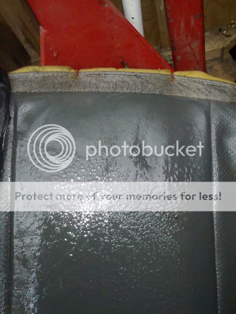

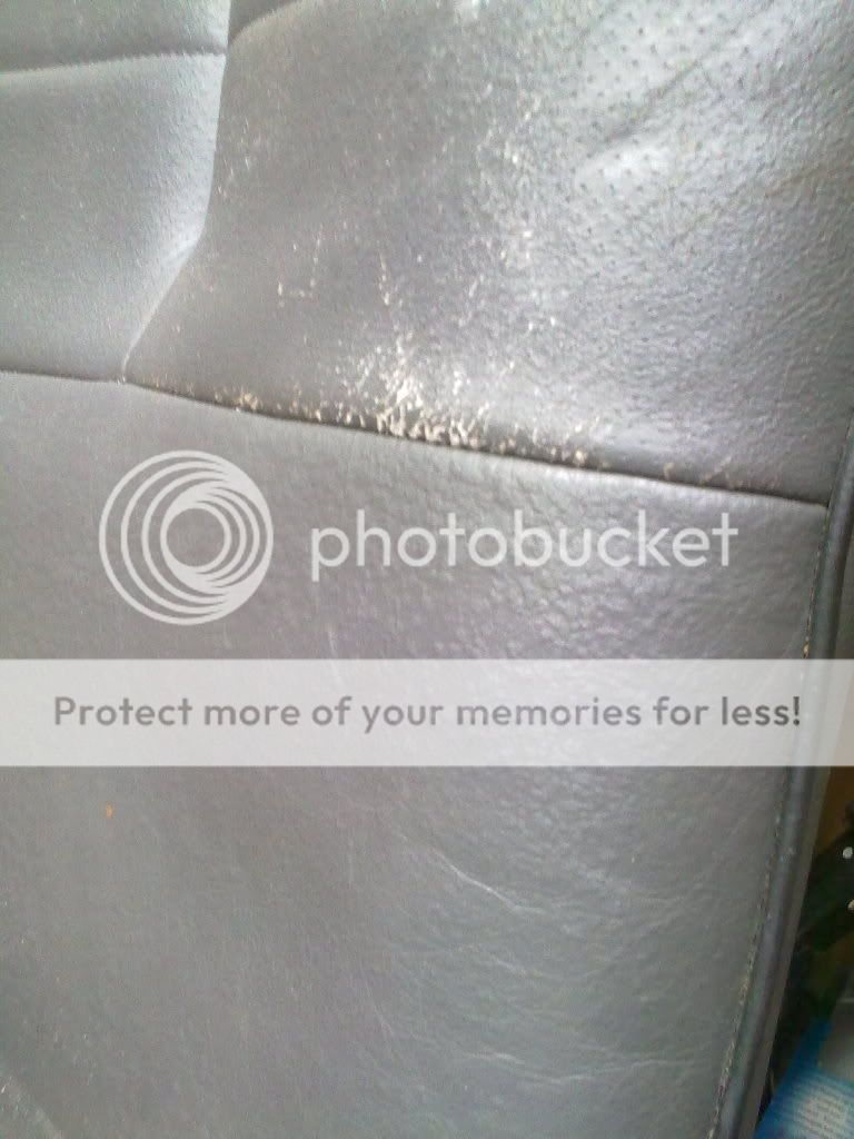

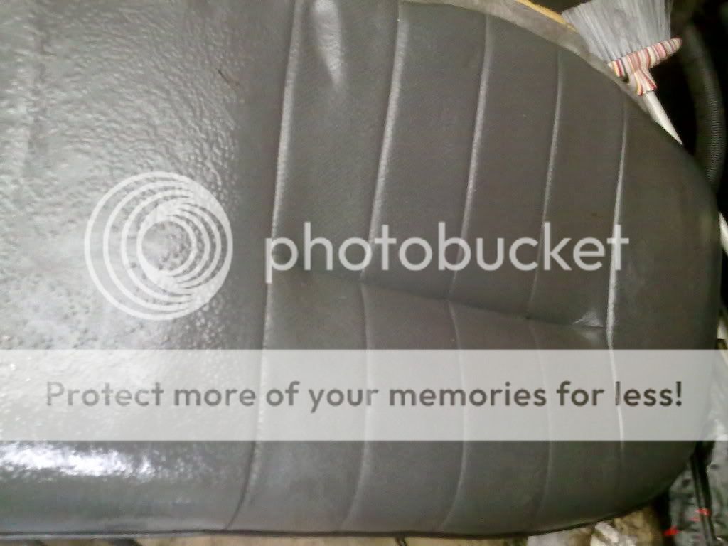

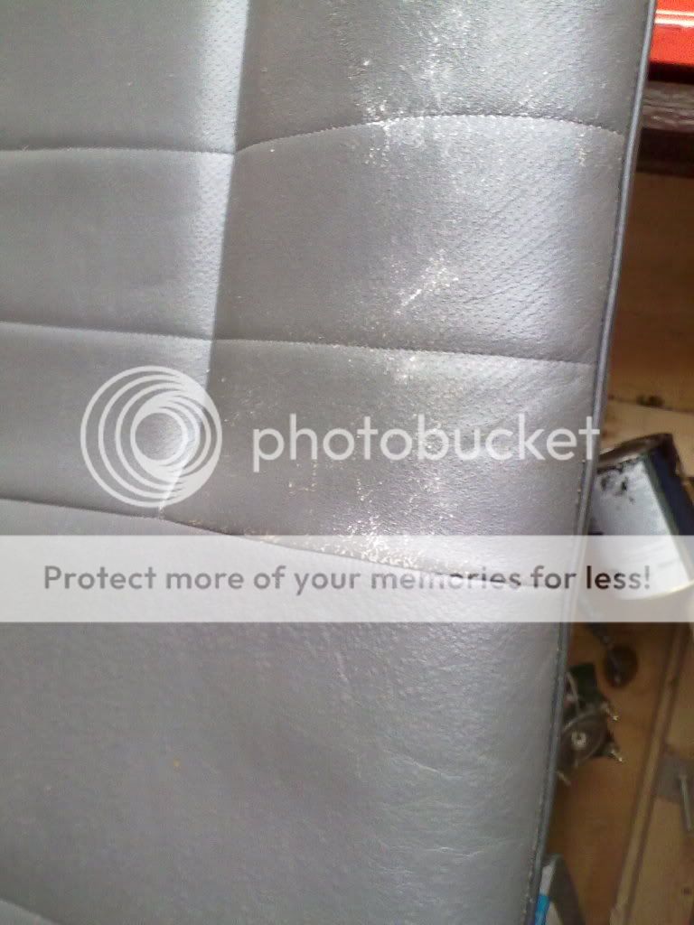

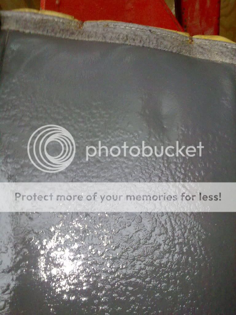

Here are some photos of the rear seat bottom cushion, and what I'm up
against! I think that as the car has been standing that salt! has been
coming out of the leather, and might be blistering the leather
elsewhere!
I have applied an oily type of leather feed which is used by horsey
types on there leather saddles etc.
It will be reapplied every couple of days if I see some improvement.
However after the first coat it has shown how bad the leather is.
#200 Post by Mitsuru »
Is the leather too far gone, or do you think it can be saved?
Any suggestions on how it can be saved?
