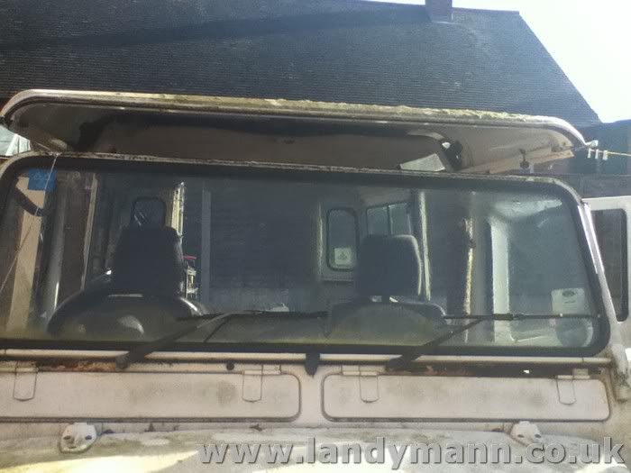

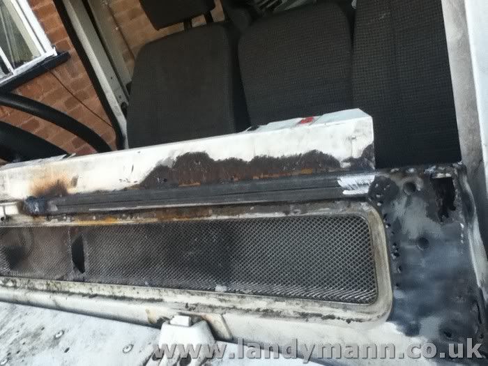

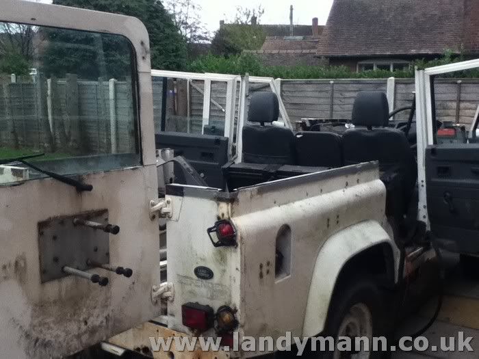

We have progress!!! We've got all the bolts undone so the roof could be removed (as one piece with the rear sides). All the seals needed breaking including the silicone bathroom sealant round the windscreen and wedged it up with some handy bits of wood.
The windscreen has now been taken out and the top of the bulkhead inspected properly... With some vigorous poking and grinding some metal was found on the bulk head!!
That’s about progress leaving the 110 looking like this, before one of the lectures from uni came round to do some measurements for his 110 that’s going from V8 to 200tdi.

I've got quite alot of progress to report since last time, all the welding on the passenger side is done (Thanks BiosBill) and I've now fitted the new galvanized cappings on to the tub. Just a couple of photos as it was dark by the time we finished. First with the roof and sides completely off and the other of the first section of welding partly done. It looks like the Christmas deadline might be a reality

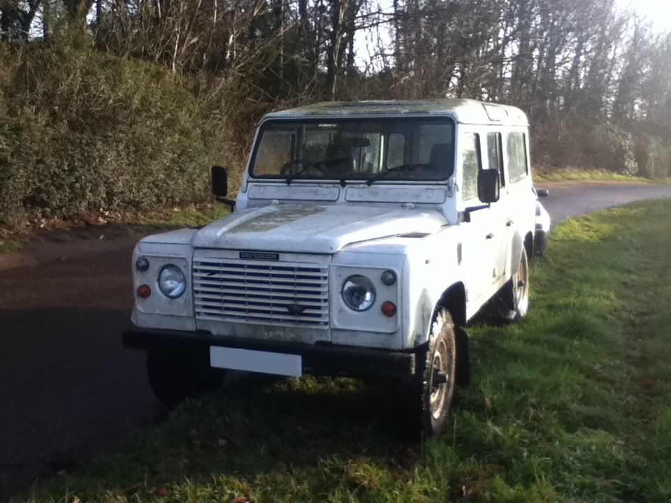

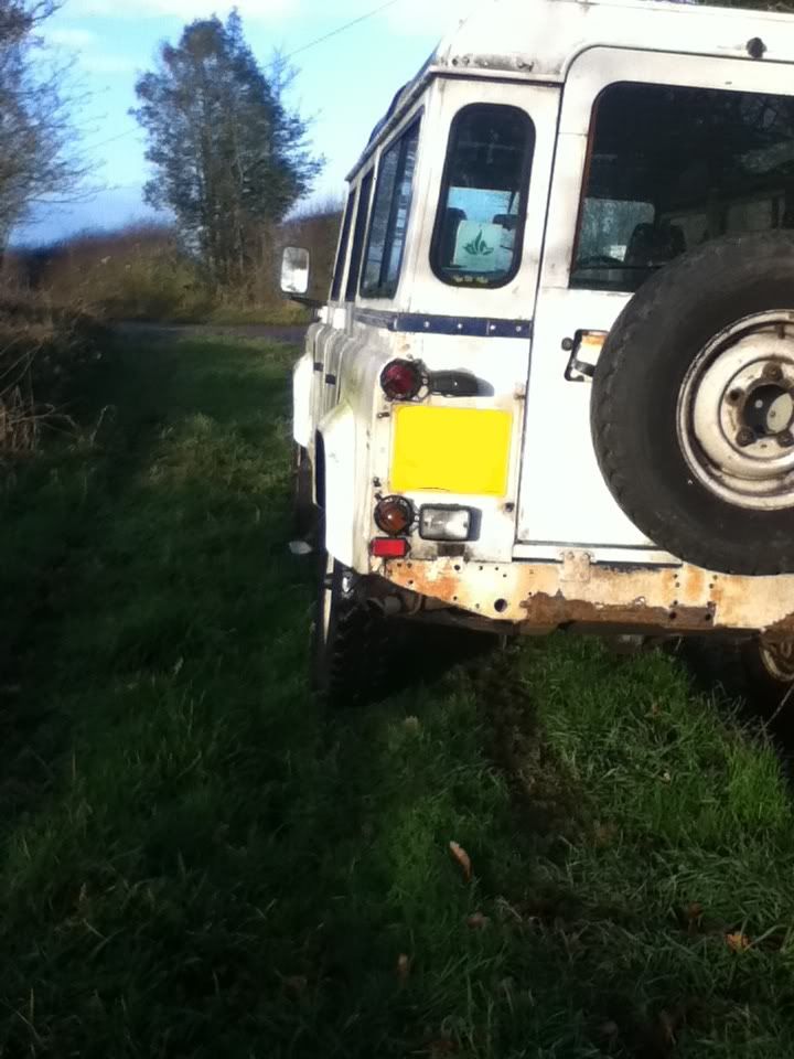

Apologies for the lack of updates, over the past week everything’s suddenly moved, spurred on by deciding to book a MOT, so all the welding's done, the roofs on and the doors are all back where they should be. By the light of a 60W incandescent work light I sorted all the remedial bit yesterday evening (minor things like bolting the roof back on...) The only hiccup is despite everything electrical working when I got it some of the lights decided that they didn't want to work properly...
Anyway to cut a long story short she went to the MOT station this morning and failed! On tail lights, beam alignment and a loose headlamp, all easy fixes that I'll have sorted by the end of the week.
Here are some photos I took on the way back from the MOT station:

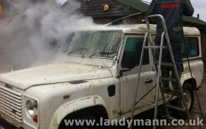

A few days after this I borrowed a pressure washer so my white paint now looks white rather than green.

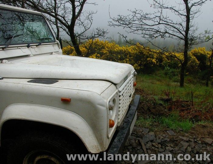

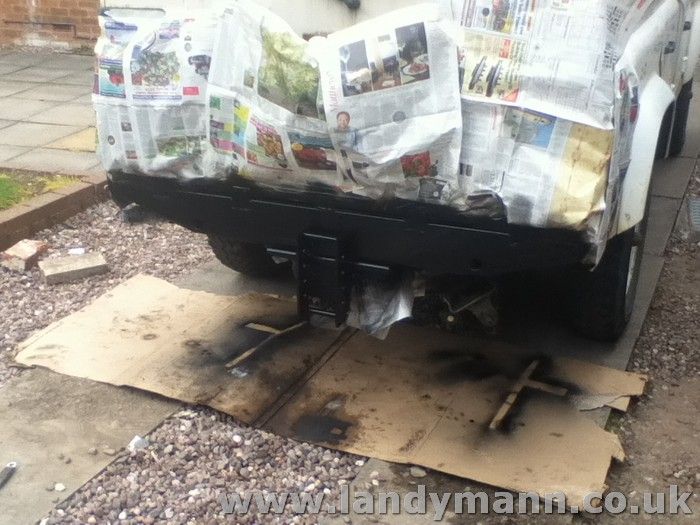

The 110 has taken up the roll of student hack again, however now sporting some new to me doors, a new rectifier pack (but charging issues still persist but no flat batteries), an new fuel tank, wheel bearing, clutch fluid change after complete clutch failure, steering arm straightened out (don’t ask), and that’s about it, CB radio and some recovery points have been fitted, and the 110’s proved ideal in both Yorkshire and Wales. I’ve spent the afternoon painting the cross member, how well the finish will stay I’m not sure but we’ll find out! And now for some pictures:
