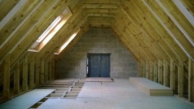

The added bonus of a loft space but has you can see unfinished with a lack of floor boarding (now completed) and crammed to the rafters with everything that SWMBO wants to keep just in case of a nuclear fallout (99% of which is useless but she insists on keeping it)

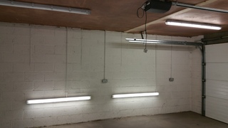

Over the last six months I have attempted to get works done and have now managed to get the ceiling in the main workshop done and got the plasterer to screed the floor at the same time with a heavy duty latex compound - concrete finish to the original slab was very poor having been laid in several batches it was uneven and harboured dirt & dust. The electrics were nothing more than life threatening how the previous owner had not killed himself I am not quite sure - I spent a couple of weekends sorting this with wall mounted lighting and a good spread of 13amp 2 gang industrial sockets - 32amp feed for the compressor - outside lighting etc - still have some minor odds to finish on the electrical front but getting there

Have you mounted a strip light on the roller-door? Clever .. although if tight for space it is in a prime position to be "taken-out" on something immovable parked/placed too close. Didn't think of looking at that idea on mine ... how does the wiring supply work? My "motor" is on the side frame so it is on a flexible-coiled cable to the wall mounted control box .. remote activated of course!
I would love to have low down lighting like that but that's my storage areas .. all around the walls .. also considered a pit until I found the builders drawings of ours and the garage is sitting on concrete piles (side of valley!) and steel reinforced concrete floor! :cry:

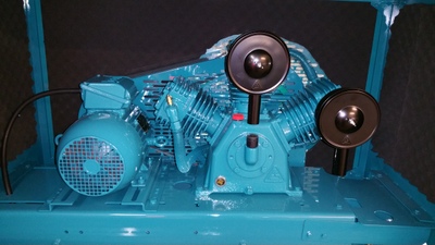

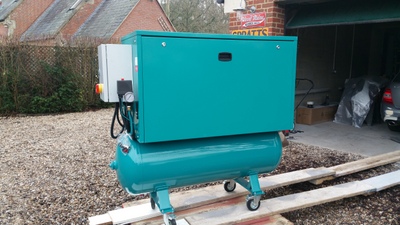

I needed a compressor for the workshop - whilst there is a vast range of off the shelf kit available - nothing suited my requirements - I wanted to future proof my capital purchases - hence although 150 litre 14 cfm (cubic foot per minute) compressor would suit my needs now - it highly unlikely that it would be of sufficient capacity in 12 months time so after much research I found a company that would custom build to my requirements and the end result is this
270 litre - 23 cfm - however to power a pump of that size the motor requires a 3 phase supply and I only have a single phase supply - so the motor is powered via an invertor - I also had an acoustic canopy made for it which takes the 101dba down to a much more acceptable 68dba - close the garage door and you cannot hear it running outside of the building - I have great neighbours and would hate spoil the relationship by creating nuisance noise.
Has you can imagine custom build + future proofing comes at a cost - £3,500 cost ! :o - but I am of the opinion that I want to do it once and it's pointless investing for the short term when buying professional equipment - I had the compressor mounted on industrial casters so that it be moved in the workshop if required - I now have it plumbed in with feeds to 2 wall mounted self retracting 15 metre reels - supplied air initially via a 3 stage separator with coalescer to provide breathing air for the air fed mask.
