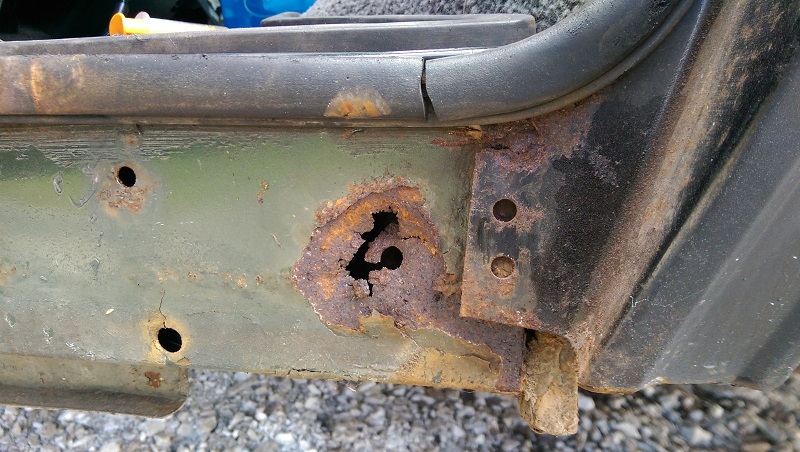

I was having a prod around last week clearing drain holes and discovered the base of the n/s b pillar was made of crud rather than metal. Pic after I attacked it with a punch and a hammer. Annoying but not a big deal. I made up a repair ready to cut out the crud and weld on this weekend.

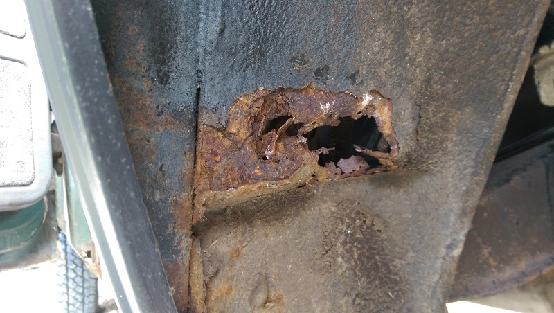

Unfortunately "some issues" translate to an extreme lack of metal. Some poking and the area under the rear door apart from the very back 4" is solid. From the B pillar forwards it's just rust and air.
After some fun with my grinder this is what came off. There is much more in need of cutting out but after measuring the metal (1.89mm?!?!) I don't have anything in stock to replace it with so I have stopped and ordered 2 square meters of 2mm steel (as I'm assuming the drivers side is just as bad) to replace it.

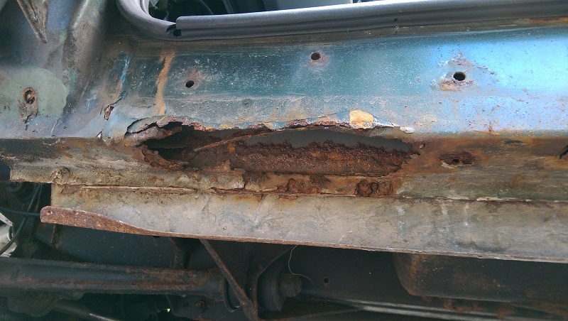

Poking about and about 2" further up the bulkhead from where I had repaired the floor, what looked like metal was rust held together with structural paint. Another day of poking and I have cut out about an a4 piece of paper in size worth of "metal".
