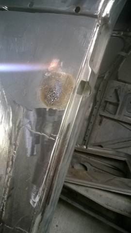

Paint on a good quality solder paste - this is a solder bound flux - it's not cheap but its good - only cover a area of say 150mm x 150mm at a time (cover more and you will find that the paste has dried out with the heat before you get to it)
Then with a suitable narrow flame (you can just see the blue flame to the left of the picture - you could use a standard blowtorch but you need a fine nozzle / tip for it - use a wide flame and you will have no end of problems) Carefully heat a small area of the solder paste until it fluxes - you need a well ventilated area - don't apply too much heat or you will begin to distort the panel - has the paste fluxes and the solder starts to run - remove the heat and wipe the fluxed area clean with a damp cloth - take care not to wipe off the rest of the solder paste that you have yet to heat - working methodically complete the process in sections until you have tinned the area that you wish to lead load
Should look like this once you have the area tinned - I will post the next steps when I return home a little later today

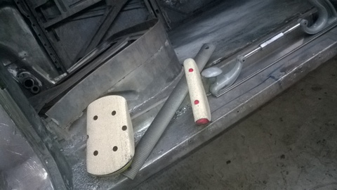

Lead loading paddles - normally beech or maple they are different types for achieving different shapes - if you are handy with woodwork you could make your own but they are relatively cheap (usually £7 - £10 each) Tallow is what is used for preventing the lead sticking to the paddle face and be seen to the lower of the image with the flat paddle

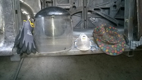

Ok once you have the lead roughly into shape you will need to wash the tallow off the lead before attempting to shape it - I use panel wipe but any spirit based product will do - once clean you start shaping - there is no reason why you cannot remove the tops / rough with a flap wheel fitted to an angle grinder but please wear the correct personal protection
Anything less than this little lot and you will not be doing your health any favours
This is a body file and is just the tool for the job - it can be adjusted to be flat / concave / convex dependant upon the panel profile - just work it in a forwards motion and it will soon indicate any high / low spots in the work area

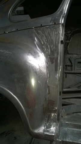

Still some way off yet but with some additional work it will soon be in profile

The shallow areas shown in the image shall be reloaded with lead to bring the area flush
But nearly there ! Once you have completed an area you will notice surface / flash rust start to form within the surrounding areas due to the powerful flux that you have been using - don't be alarmed by this - just complete the rest of your lead loading then redress the surface areas by rubbing back with production paper or a orbital sander. Immediately prior to paint I use a rust conversion product called 'Fertan' http://www.fertan.co.uk/Item-Fertan%20r ... verter.htm which resolves any surface rust issues. So there you go - appears to be a lot of work / faff - but the job gets done properly with a lasting repair and not two buckets of polyester filler. I use this company for my body solder / lead supplies - they do starter kits - attend most of the major shows but will also post out goods http://www.lb-restoration.co.uk/cgi-bin ... mmerce.cgi
