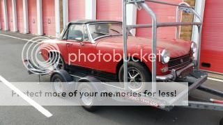

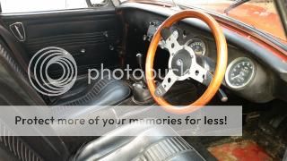

Hi guys, this is my little red midget that was found in a garage where it has been sitting for the last 15 years.
Work will start soon.

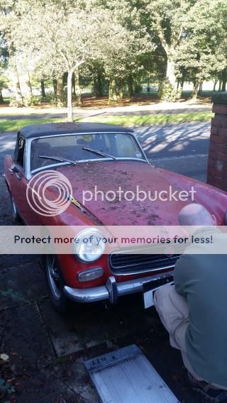

Under all that dirt the paint is in pretty good nick.
