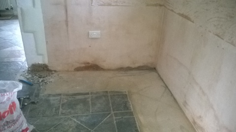

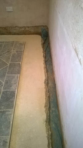

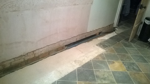

Case in point currently is our kitchen & utility which I am just prepping for a major refit - new boiler / floor / rewire / window restoration / kitchen units / appliances etc - upon taking some of the units out it became evident that we had damp creeping up the walls

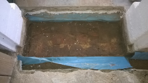

The property was converted from a chapel 20 years ago - long before we owned it and being built 140 years ago so long before damp proof courses were fitted to properties - so after digging the screed up / removing the insulation - I find that they have returned the damp proof membrane over the top of the concrete slab and folded it under the insulation & screed
Net effect being that with leaving the plaster / brickwork to to bridge the damp proof membrane - All that they had to do was return the membrane up the wall above the finish height of the screed or better still return it back into wall and form a cut off to any damp

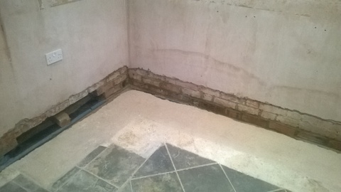

So for the last few days I have been working my way around the room digging up the screed / exposing the DPC then chasing a brickwork course out of the wall to which I have returned the DPC - added a further membrane and then made good the brickwork - but If only I could locate the bodger that did it in the first place :twisted: :twisted:

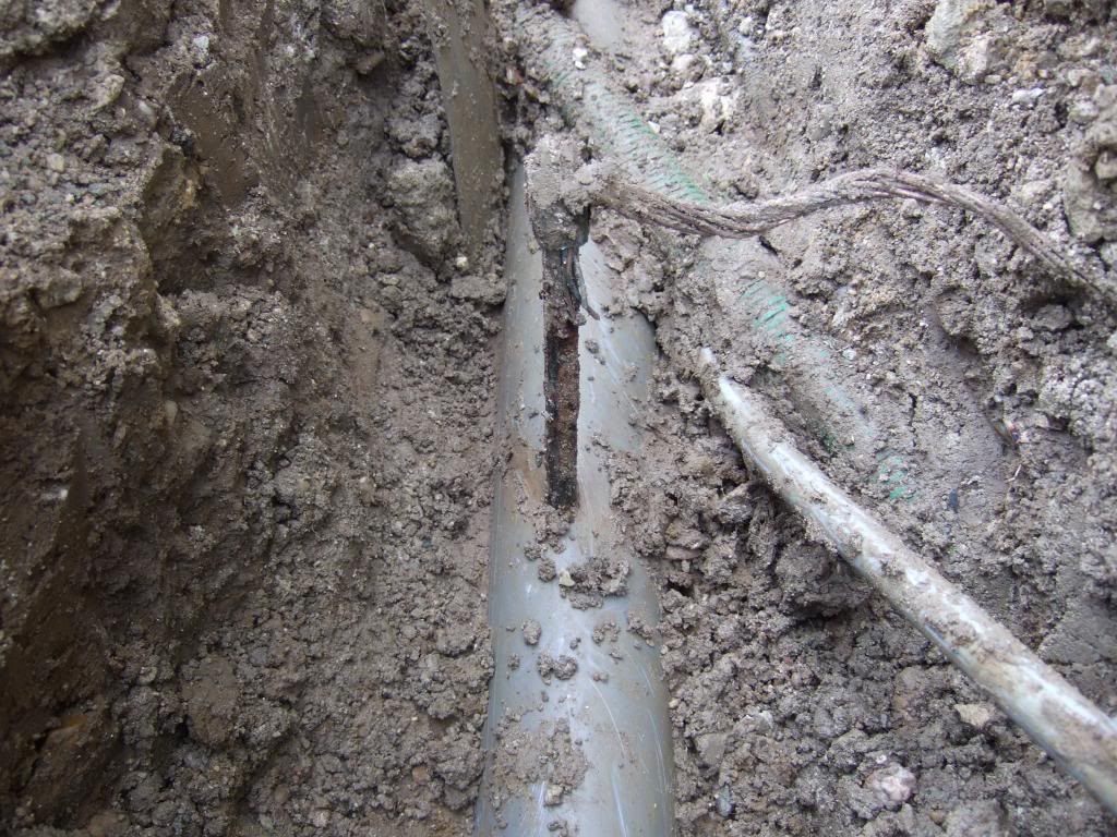

heres one i repaired a few years ago.. i had to dig out 16 metres by hand replace everything & when i got to the end of the trench i found this.. it was done by the previous owner to improve the earthing on the house.. my client was not a very happy person when i showed her the bodge..
:shock: :shock: :shock:
yes, it is the soil pipe... thats why it was blocked all the time

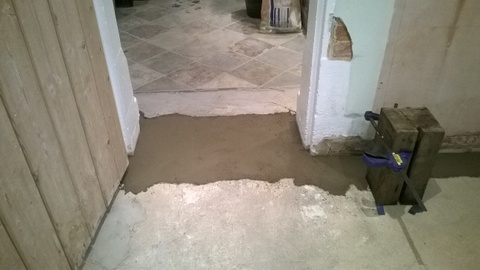

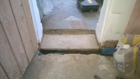

Still wrangling with the DPC bodges - heres the latest one - this would have originally been the rear door to the chapel - when they did the conversion they added a rear extension which became the utility / boot room
They were obviously too lazy to lift / remove what was the stone rear door step so they just screeded straight over the top of it :o

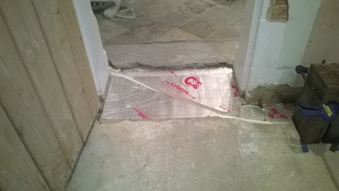

In doing so this completely bridged the DPC - no insulation either - DPC sorted and insulation installed + feed & return pipes laid to the new kitchen radiator
Finally with the screed placed that is this bodge sorted - reward for all my hard slog ?? (apart from knowing that the DPC / insulation is now sorted in the doorway) A nice reclaimed stone step that I should find a use for in the garden :roll:
