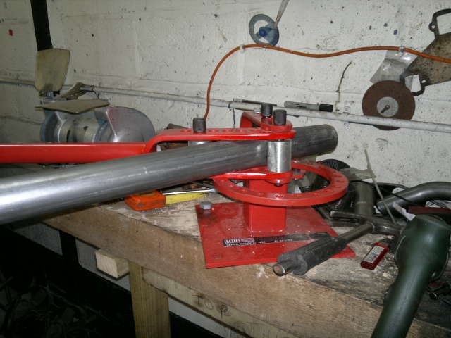

Has anyone any experience in using one of those 'cheap' pipe benders to bend 42mm 1 5/8" exhaust pipe or to be precise tube? I've watched various videos on line but still not sure about it. I've tried a few of the methods, filling with sand, using a die that's a bit tight and whilst they work to an extent aren't fool proof, or at least not for this fool....laugh please it's a joke. I wish to make a new exhaust with a couple of bends but so far no joy. Any help would be appreciated. I'm going to keep trying as I'm sure I'll master it before I run out of pipe.....or the will to live.

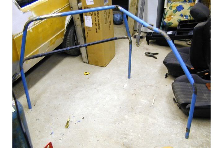

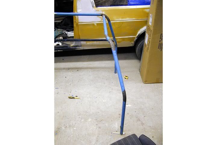

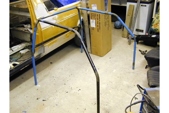

I've had some good success's in the past with a simple hydraulic bender, I worked out my own little system where I could replicate bends how I wanted them over and over.
I've built a few cages (for show use only before anyone says it :) ). I was young then and realise now that the cage would probably do more harm than good!
And I bent four lengths of 2x2 box tubing and had to get them spot on.
So it is possible,
However..... All that said for an exhaust I have to agree with the above comments. The time and effort it would take it would be quicker to just use pre fabricated/used bends.

Dobbin wrote:Has anyone any experience in using one of those 'cheap' pipe benders to bend 42mm 1 5/8" exhaust pipe or to be precise tube?
You mean one of these?
It's not really a pipe bender,more of a bar bender,as they kink the pipe
Bending pipe with these is best

No not one of those. One of these

The one I have is a 12T hydraulic pipe bender
