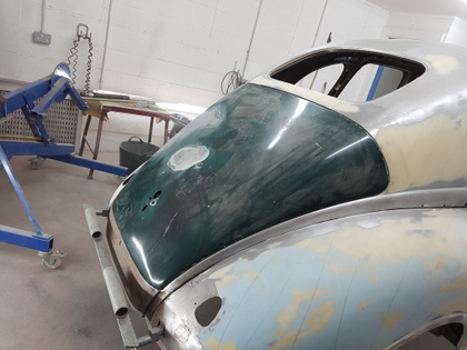

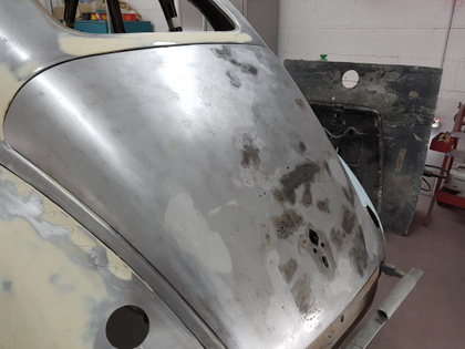

Going to have to weld several previously drilled holes for number plate mounting / non original lamps etc, meanwhile the nearside profiling is now close to completion - this has taken longer than offside due to the state of the panels especially the doors

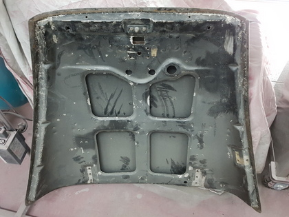

The alloy frame you mention, is that fabricated or cast? Seems a bit odd to have a steel skin on an alloy frame and not the other way around if the frame isn't a cast item. In the pictures the bootlid doesn't look too bad, I guess it will when we see the filler work going on.
- Grumpy Northener
- Posts: 1637
- Location: Hampshire UK
So here is the underside of the boot lid - it's just a pressed frame from a alloy sheet - really odd is the fact that its alloy frame / steel skinned - the steel being stronger tends to spread the frame - normally it's the reverse i.e. steel frame with an alloy skin - in reality neither works as two dissimilar metals in contact with each other - hence the alloy tends to corrodeThe alloy frame you mention, is that fabricated or cast? Seems a bit odd to have a steel skin on an alloy frame and not the other way around if the frame isn't a cast item. In the pictures the bootlid doesn't look too bad, I guess it will when we see the filler work going on.
