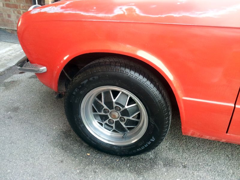

Work has progressed on and off, a little here, a little there as time, funds, and the back allow. Roof was stripped back to bare metal, and has had an undercoat applied for now. Few other rust spots have been started on, next major job is NS rear wing and rear door, which are the worst of the other panels.
Wheels have come up nice too
But I suppose the major item is, we've decided on the colour! It's orange, and probably with a black vinyl roof. Not 100% sure on what shade yet, if I stay with BL it will be Blaze
or go for out and out brightness and get noticed with Signal Orange from Ford
