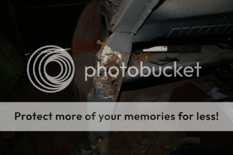

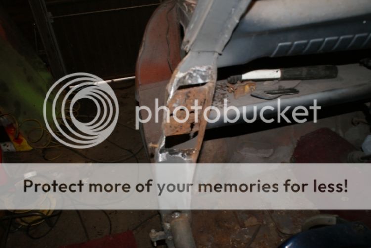

Then carried out a few localised repairs to the front inner wing and bottom hinge brace along with a repair to the windscreen scuttle corner

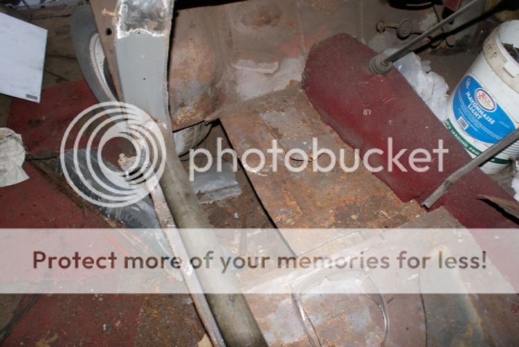

I set about removing the old sill, inner sill and floor edges etc, expanding foam was found at the end of the sill, it always seems to be popular for some reason.
This is about the stage where I lost the cameras charger
still no idea where its gone, piccies went out the window but I built up the inner sill as per the other side and sorted the floors out. Fortunately I didn't need to replace the front rear spring hanger on this side but do wonder if I'll regret it in a few years time, still, no point in cutting out what appears to be fit and well.

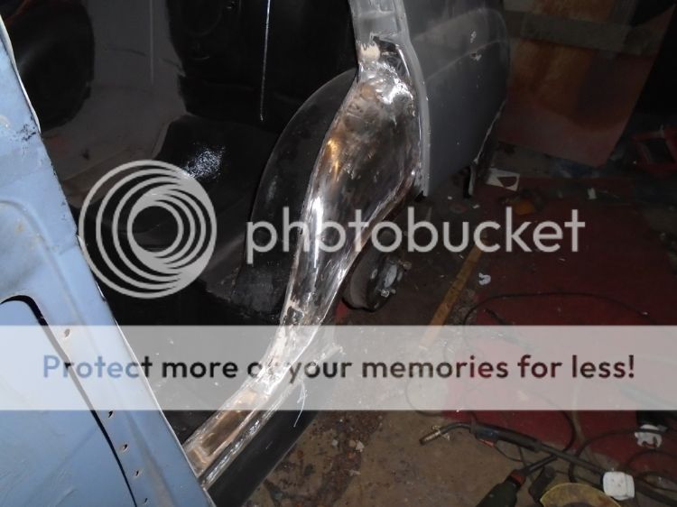

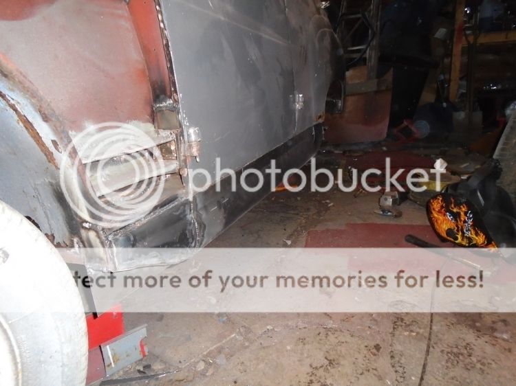

The rear spring hanger / chassis leg was good til the last few inch so I just chopped it off behind the spring shackle and remade that area. I also chopped out a fair bit of the rear wing, made a new quadrant for the chassis leg to wing area and got that in, and then the outer sill section arrived followed soon after by the new camera.

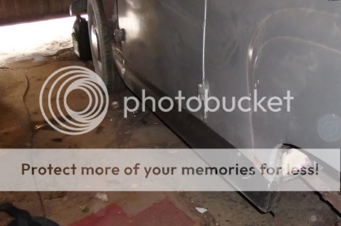

So a few photo's were taken after making up a front nose for the sill and persuading it to fit ( you get what you pay for with A30 sills and of course me being me I took the cheapest option I could work with again)
And the rear wing repairs I was on with whilst waiting for the sill to arrive, I still have to finish this area but its getting close, the white painted metal is taken from a mini roof I stored in the bottom shed after chopping one up, it had some curvature already so lent itself well to the job
I also repaired the front door posts top and bottom hinge mounting areas
The rear wheel arch to c post area and the bottom to sill area also required some repair so I let in some new metal

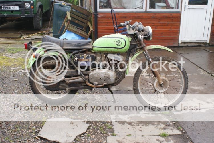

Can we see the 175 trail bike plz

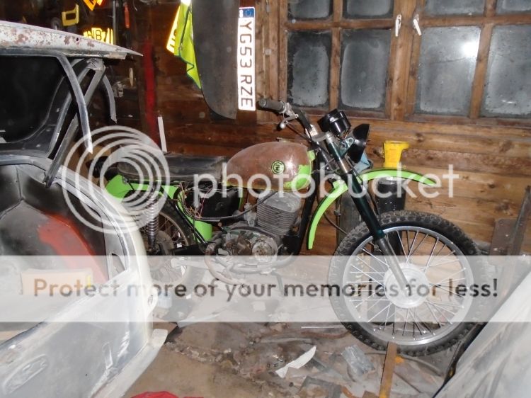

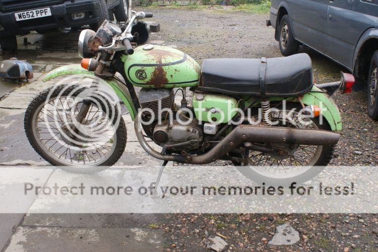

Not a lot to see really Kevin as its half apart and catching dust but
This was when she came
She's tucked away in the corner of the garage looking worse really but under the grime and only being half built there has been progress.
Stripped, frame painted, mudguards and oil tank painted in Lambo Green which is close to the original, Front forks were shot and have been changed for a pair of 60's Jawa 350 ones which have the same lowers and fit the yokes apart from I had to carefully remove the top fixings from the originals and plug them in to the earlier forks. A careful bit of lathe work and welding required there but it allowed me to keep the original top yoke correct. Those forks coupled with slightly taller shocks give it about 3 inch extra height which is what I was aiming for.
Really just the tank to sort and paint, the rear wheel to clean up and replace the tyre (already done to front) , seat to recover and then get it all back together, wired and running.
I'll fit it in to the list of jobs somewhere once the Austins done.
