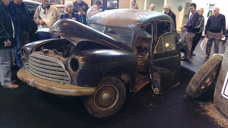

Did anybody see the rusty Rover P6 shell at the PC show at the NEC? Why couldn't we have had one that good!
Re: Car SOS - New Series!!!
#46 Post by TerryG »
I did see the rusty oxford, when are you doing that? (or is it one for a PC restoration, I think they have recovered from the jag now)
You could say that it has some rust issues.
