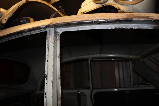

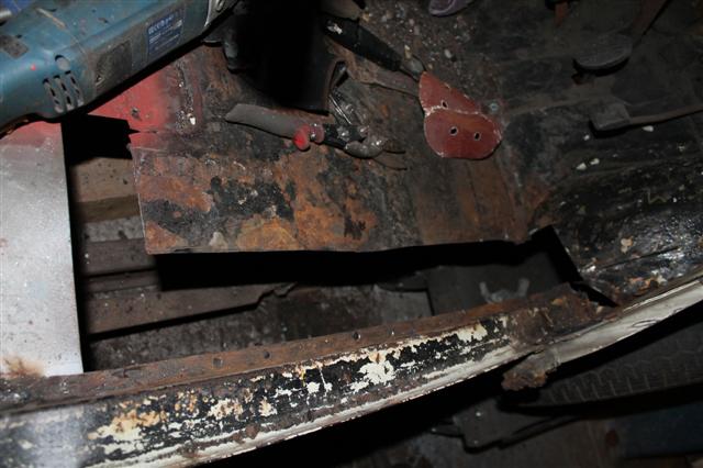

made some further progress in the last couple of weeks, most of the gutter and the step panle which goes to the door seal lip have been replaced, just down the A pillar to do now, the upper B post and around the rear side window has been finished and we have cut out the rust in the front floor and most of the rotten A pillar.

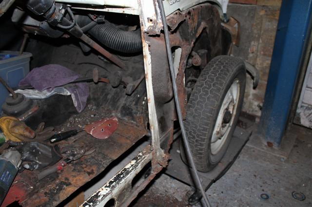

One of these pictures shows how bad the car is structurally, it has been repaired "to mot standard" ie patches welded over the rust, this means that the seams are no longer connected and panels not joined, I pushed this joint appart with my hand, the floor to sill is much the same.

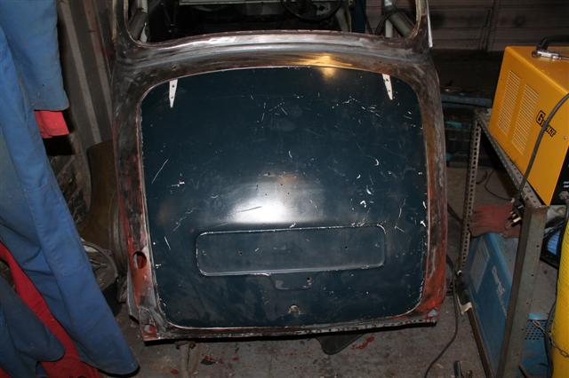

We also started on the boot lid, the plan is to use a fiberglass skin I puchased cheaply and bond the steel inner from the original bootlid to it with PU, fortunatelly the inner was in pretty good shape, but the outer had rusted across the bottom, the top and at the seams around the edges, the pictures show the inner cut out and resting in place, it has also been painted now, ready to bond together.

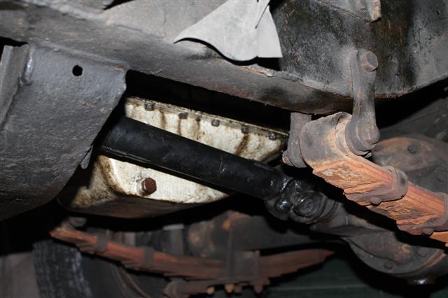

Also did a couple of jobs on the land rover, I fitted the new front propshaft (the original had very worn splines), no vibration now, and waxed a few areas of surface rust onthe chassis.

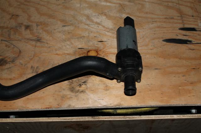

I also started to work out how I was going to fit a booster pump for the heater (Pump pictured), As I have LPG at slow engine speeds (most of my journey to work) the heater does not much flow, I plan to fit his into the feed before it T's off to the LPG mixer.

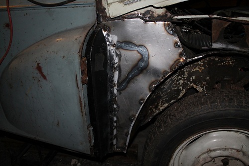

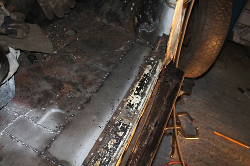

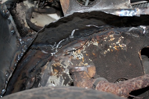

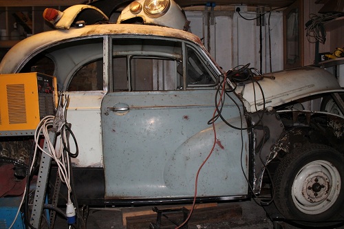

made some progress on the minor, we bought a really solid second hand door which only has some surface rust from years of storage, this led to rapid progress on the floor and a pillar and fornt whhelarch areas, many of the parts are only tacked in the photos, seam welding has followed.

Been away for a week, but there is some progress on the minor before we went, the door post is now on (needs final welding) and it's amazing how such a simple thing can seem a great step, just the action of being able to open the door without it it droping on your foot is satisfying.
Next steps are to fit the lower rear wing, finish the welding around the A pillar and then think about some sort of paint to protect it before I turn it around and start on the other side, plan is to try and get it on the ramp over xmas and clean up and paint the underside.

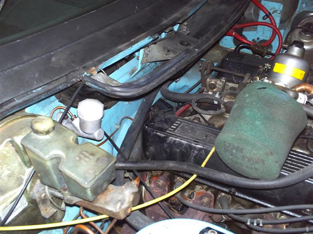

a bit of time over the weekend, I fitted a new master cylinder to the TR clutch, it has been leakin for ages, so time to fix it, it is a bit of a fiddle as it is held in by nuts and bolts but with my son's help we manged to get the bolts out and removed it. This was when I realised there was a probem, when I fitted the V8 I had changed from the original easily heat damaged plasic pipe to normal brake pipe and a flexi hose, despite the smaller bore this has always worked fine, this though meant there was an adaptor sleeve screwed in the cylinder I needed to get out,
PICT0039 (Small).JPG (54.82 KiB) Viewed 3866 times
I couldn't turn it and heating the alloy up did not help, so I cut down the side with a hacksaw,
PICT0040 (Small).JPG (59.47 KiB) Viewed 3866 times
which worked fine, once I had this out it was an easy matter to put it all back togther, then 20 or 30 poump and it self bleed as well, cluthc now works fine and is much lighter.
