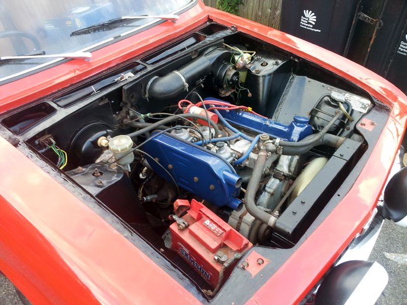

So, remembering what it was like under the bonnet

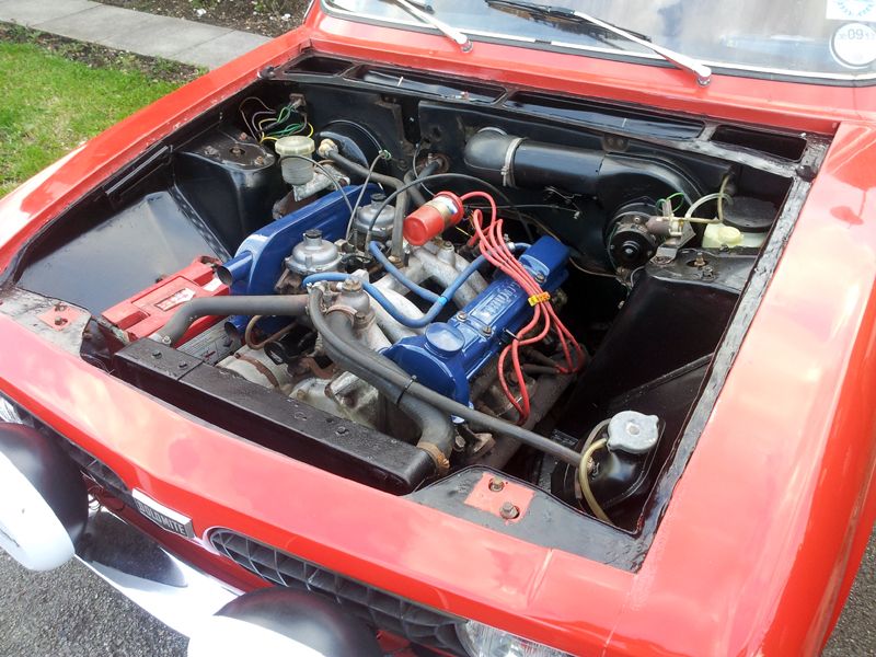

And now
And now
Nice work that man!
One observation if it's OK; where's the breather tube for the transmission? It would originally have been taped around the top of the brake servo and its open end would be at the right of the servo, about three inches back down into the engine bay. If this tube is routed too low, has no loop or is missing altogether, the trans will eject fluid from the breather at speed and will leave quite a line of fluid along the road behind the car. Both of mine lost their breathers and both maintained their fluid level perfectly once I'd put a fresh pipe on there. I'll gladly scan and post the relevant page from the original manual if you need to see that.

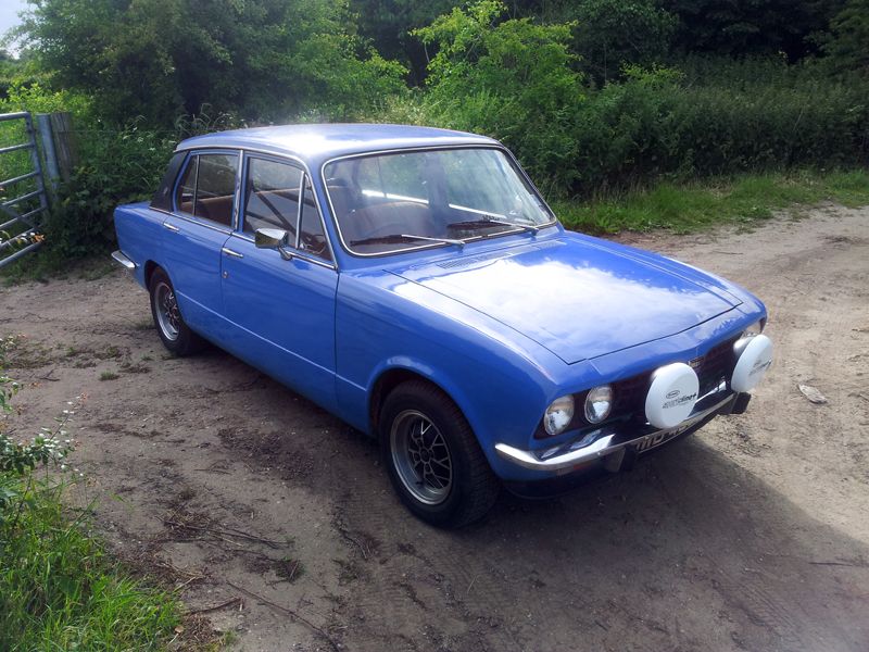

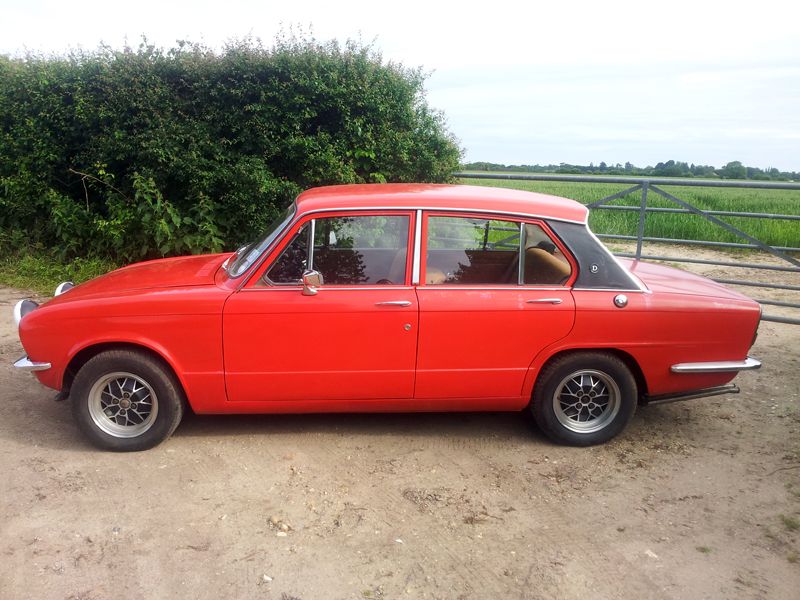

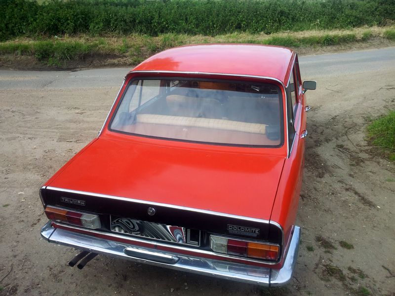

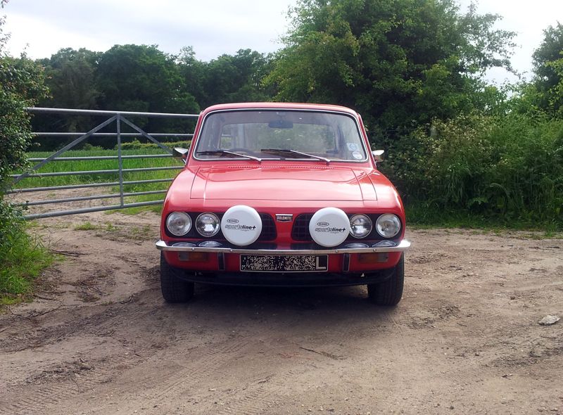

Finally bought a new battery for the Dolly, so managed to go for a Sunday afternoon run just to make sure it's still all ok. Grabbed some newer pics too. Seem to have a dunk dunk dunk on over run/ feathering the throttle, sometimes louder than others, and sounds like it's coming from the rear but not sure. Apart from that, was a nice run out.
Really need to sort out the bodywork as it's getting quite bad now, you can see how bad the rear wing and door is getting even from the distance I took photos from, so best crack out the wire brush/Dremmel/flapwheel. Trouble is, where there's lots of scabby bits, blowing them all in isn't really an option, so looks like full respray time as it will just be easier. Thing is what colour? Quite fancy Magenta as I said previously, but have a couple of other options, just not sure yet.
