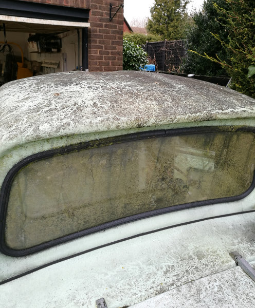

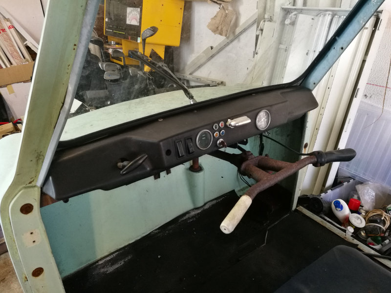

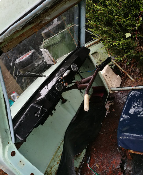

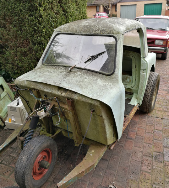

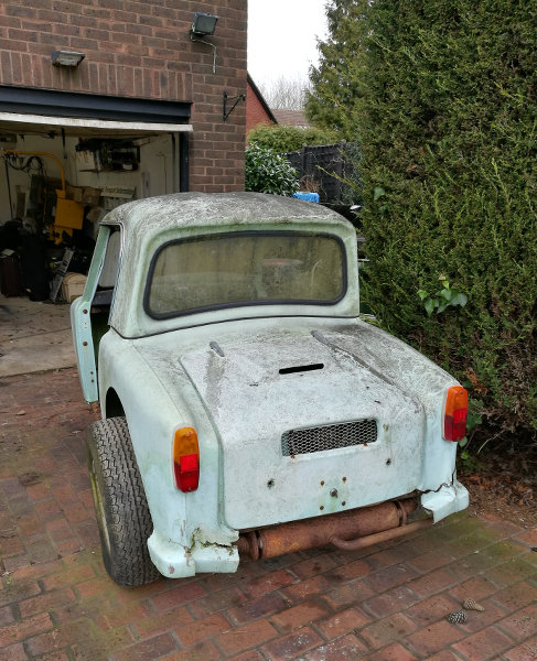

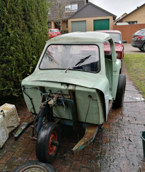

So today I attacked the Invacar with the pressure washer.
This was the starting point...
Then busted out the rotary nozzle attachment. I don't usually take this anywhere near cars given the tendency it has to remove paint as well as dirt.
I also discovered that the (rotten) floor appears to actually be totally non-structural. It's only attached at the edges by a few rivets, and doesn't appear to actually attach to the structure of the chassis - which is why it's falling to bits so much! On the plus side that should make replacement a lot easier.
The whole car is still a long way from clean, but at least now it should be rather less disgusting to work on.

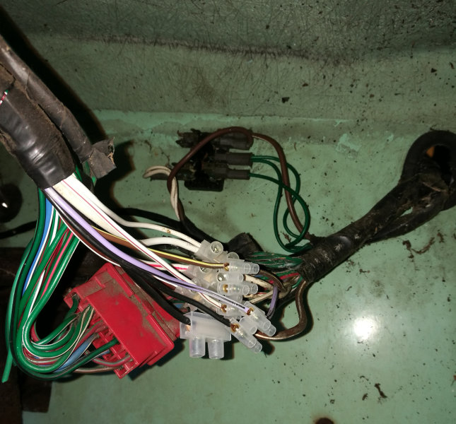

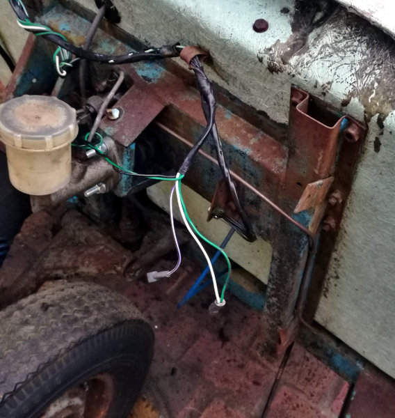

Before I had any chance of considering running tests etc, I needed to repair some of the butchery that the wiring had been subjected to. Armed with the schematic it wasn't too hard to figure out what was what. So I set about reconnecting roughly 92340985477 wires in the engine bay and under the dash, and safely terminating many that were just dangling about looking for something to short out on.
Here's a small selection.
The screw terminal connectors here aren't a permanent solution - everything will be properly crimped and heatshrink sealed once we're done. These are good for a quick test though, and are handy for safely terminating a lot of the dangling wires until I figure out what they're meant to be attached to.
The interior is a slightly nicer place now it's clean(er).

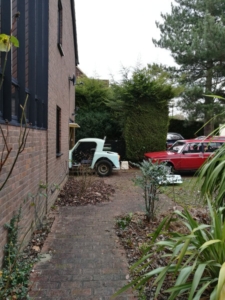

I've also proved it will move under its own power now - stopping is still out of the question though so I'm not going to do much more of that until the brakes have been sorted as it's mildly terrifying. Especially as the idle speed is a bit on the high side meaning that the clutch drags.
Here's a Link to the YouTube video where the drive was tested for the first time. It's worth noting that the carb has become far happier since this video (even though I've not touched it yet) so it is actually capable of making it over the threshold into the garage now without backfiring and carrying on.

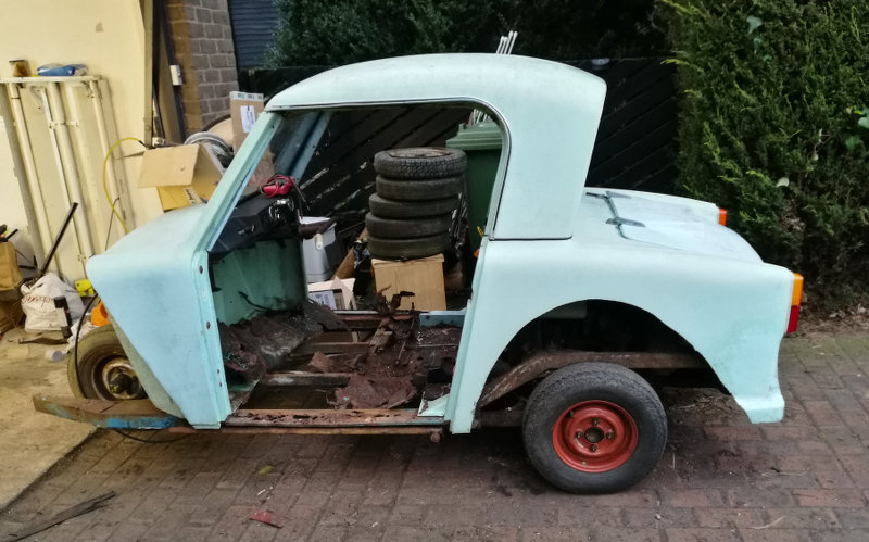

[] The ridiculous 15" Daimler wheels have gone. It's now sitting on 10" wheels (which are correct for this model year - 12" wheels were used up to 1973). Whether I go for the 10" or 12" long-term will probably depend on which I can get the right sized tyres for the most readily. This has however made the cut out wheel arches look even more silly.
[] A significant amount of electrical gremlins have been traced to the top fuse holder not working. I'll remove this to be properly cleaned shortly - but won't waste too much time on it. Long term plan will be to replace this with a modern fusebox anyway. Logic here being twofold: Firstly that I'm probably going to want to fuse more than two circuits at some point, and secondly that I'd rather have fuses that I can obtain from pretty much any car parts store - especially as a blown fuse in the case of this setup can totally immobilise the car (both the ignition system feed and the starter solenoid switched supply are fused).
[] A good hour's run time has elapsed, during which the comedy smoke clouds we had when it first started to warm up eventually cleared.
[] I had planned to change the oil then - but it still looks brand new, so leaving that for now. Especially as I don't have the right grade in stock right now - so will leave that on the list for next week.
[] Seat removed (it's beyond saving - and given I've a duff back, a more comfortable one will be going in). This turned into an hour long fight on account of a multitude of rusted fasteners that didn't want to move and was made more frustrating by the fact that AC seem to have been mortally afraid of using captive nuts.

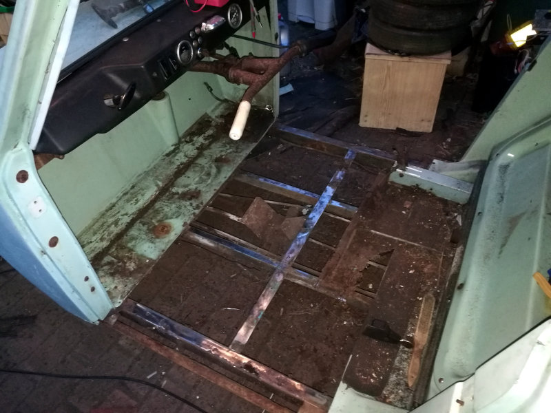

[] Rotten floor pan has been 90% removed - just need to get the last bit out - currently fighting with the fasteners on the gear selector to get to that.

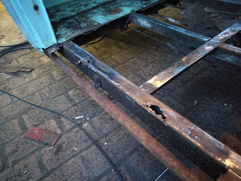

Next task will be to hit the few bits of the chassis that need repair with the welder. Then I'll rebuild the floor. The "sill covers" for want of a better term also appear to connect to the base of the bracing for the door pillars - this was simply spot welded to the chassis rail at a couple of points - I'll probably seam-weld the replacement in.
This is the worst bit of corrosion I've found so far.
...Which given that I removed about 70% of the floor simply by picking it up and pulling before I even got the grinder out is almost miraculous. I shudder to think what state most cars from 1975 would be in if they'd been sitting in a field with no doors on since the early 1990s.

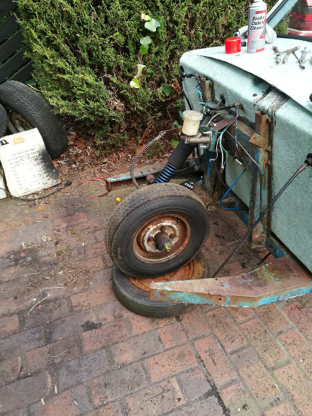

Next up was to replace the utterly knackered brake master cylinder. I didn't even bother trying to argue with the existing fittings...They'd been open to the elements for a minimum of 12 years, and were an annoying imperial size anyway. So I attacked them with the angle grinder. Much quicker and less hassle. High tensile M8 bolts replaced them.
New cylinder on, and quite happily freed off after its overnight soak.
I've bled it through as far as the first union on the system, so can confirm it's pumping fluid. Given that none of the drums currently have shoes in, I've not gone any further than that. I need to spend a bit of time studying the diagram of how the logic puzzle that is the combination of springs, clips and shoes is meant to fit together under the drums. That sorted out, hopefully I'll find out tomorrow what wants to move and what doesn't.
Even if I could get brakes working on one wheel, it would make moving the thing around a lot less unnerving!
By far the most annoying part of the jobs today was getting the blasted split pin out of the link between the handlebars and the master cylinder pushrod. That must have taken me a good half an hour of swearing at it while standing on my head - the whole process made significantly more difficult by the fact that the car currently has no floor.
With a bit of luck, we might have brakes tomorrow...or at least know what in terms of braking kit works and what doesn't.

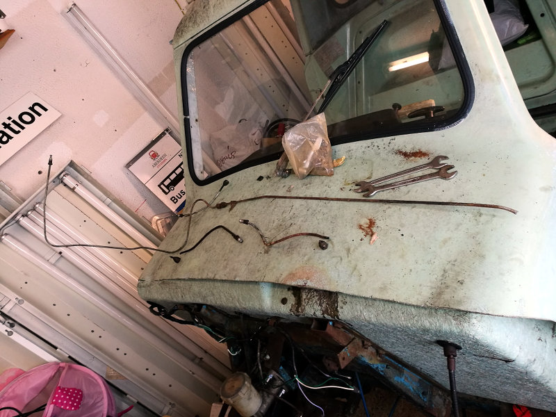

Had a dig around through my old toolbox of junk today and located a handful of imperial spanners. Also dumped about 2/3rds of a toolbox of cheaper and nastier copies of tools that I've since replaced with better versions...so this toolbox will officially now be the imperial toolbox so I don't wind up mixing everything up and getting hopelessly confused.

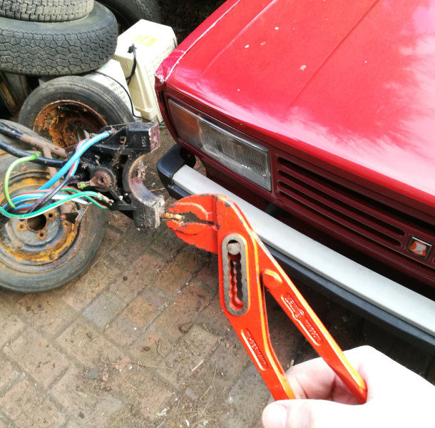

Today I had two tasks in mind. Firstly was to get the indicator stalk assembly off the spare handlebars. This involved getting the drill out to drill out the one screw that someone had rounded the head off of some time in the distant past. Then allowing me to get at it to unscrew the remains.
This pair of adjustable grips is a standard piece of the Saab 900 toolkit, and is one of the most used tools in my toolbox.
I am however going to need to do some repairs to this before I can fit it, as there are several broken wires, which are going to be at best fiddly to sort...Waiting to find out what car the stalk assembly is shared with, as it a replacement is readily and cheaply available I may just opt for that.
Next task was to get the rigid brake lines off. Having the correct sized spanners made this a much more approachable task. This is one of those areas where the quality of fasteners etc that have generally been used on this thing really shows. Every single union came undone without any drama, any stripped heads or anything. The only slight casualty was the bracket the rear T joint body is attached to the chassis by is now slightly bent.
Here's what came off...
I did cut the main front-rear section in half just to make the job simpler, as I had perfect access to do that with the floor currently out.
...The final bit of the front-rear section is actually hanging on the master cylinder, I forgot to pick it back up for the photo.
The only bits I've left be are the first pipe from the master cylinder to the first union, and the pipe that goes from the rear flexi to the rear wheel cylinders, as they look fine. The one to the front flexi would have been fine too if some idiot (that would be me) hadn't nicked it with the grinder when cutting the master cylinder bolts off. Oops.
Will be having a closer look at the rear wheel sections before I make a final choice on whether they come off too though as I'm not taking chances with this - especially as I know I've said this before, but it bears repeating...You don't take chances with a single circuit braking system as they don't take prisoners if things go wrong.

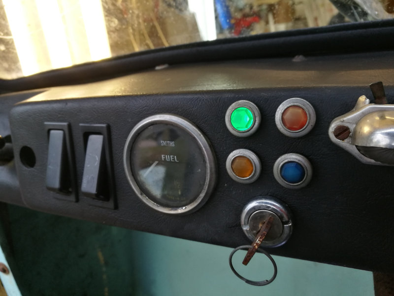

Having established that I could intermittently get continuity through the indicator stalk by hitting it (a new one is on the way), I decided that it was time to make sense of the spaghetti on the front bulkhead.
Did what I really should have done ages ago, and sat down (well, crouched on the nearside chassis outrigger...) with the wiring diagram and labelled everything. Couple of differences to the stock wiring diagram, but it's easy enough to figure out by process of elimination after a while. The sidelight circuit is red with a green trace (diagram says solid red), and the brake light switch supply is white with a light green trace (diagram says solid green). The fact that red, brown and purple traces on green wires have all faded to white also means you need to dig back into the loom tape in a few places to determine what colour it's actually trying to be.
This is starting to look a bit less electrically intimidating now...
Ten minutes later we had insulated spade terminals on all the hot feeds, and then this happened...
That's a working side (intermittently as the dash switch is unsurprisingly a bit dodgy), dip and main beam circuit.
Plus the dimmest main beam indicator on the dash that I think I've ever come across.
Astonished that the light in the fuel gauge works, unfortunately the same can't be said of the gauge itself which is knackered. No light in the speedo yet as someone's nicked the lamp out of it. Astonishingly they've actually just removed the lamp rather than hack the wires off as they had with just about everything else!

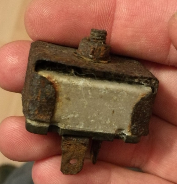

Would you believe that this thing works?
I'd have said it was scrap at a glance. It's sat quite happily for half an hour though click-pinging away switching a 55W headlamp from the bench power supply, so seems to be good. I'll give the terminals a quick sand before putting it back in the car. The nut is never going to come off the bracket though - nor is the bracket going to come off, so it will get cable-tied to the dash support bar I reckon.
