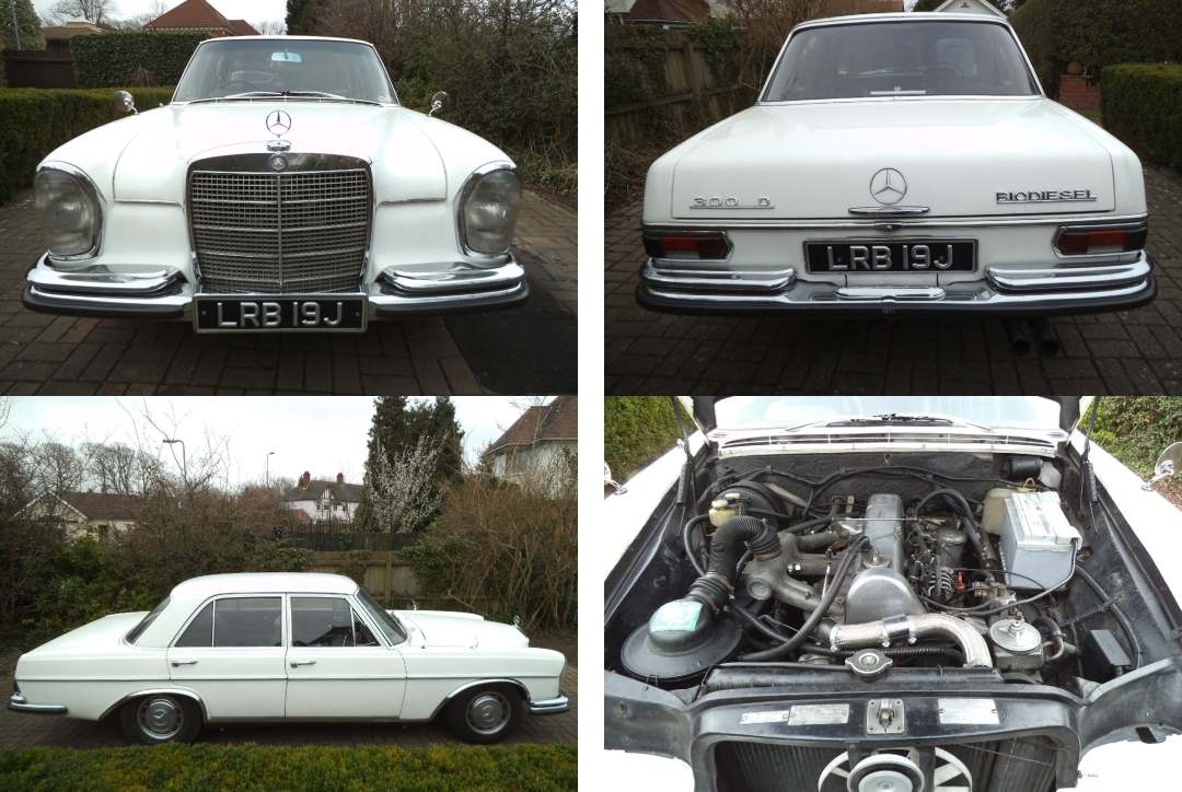

Hi, I've only just discovered this thread but I can offer an insight into a similar car.
I've been driving a diesel W108 for 6 years as a daily driver. Pics attached.
I restored it myself. It didn't need the work you've been putting into yours but it did need 3 new doors and a respray, plus the engine transplant of course.
Mine is the traditional 3L OM617 all mechanical diesel with manual 'box out of an early 80's W123 donor car.
Its easily the most reliable classic I've ever owned (and there's been quite a few!). It also has the massive advantage of being very cheap to run with free tax and classic insurance of course but the really big saving, that doesn't seem to have been mentioned, is that the older diesels run perfectly on cooking oil with little or no modifications.
I reckon I've saved more than I paid for the car, including restoration costs, in fuel bills since I've owned it!
I'll keep this post brief but any info you might require, let me know.

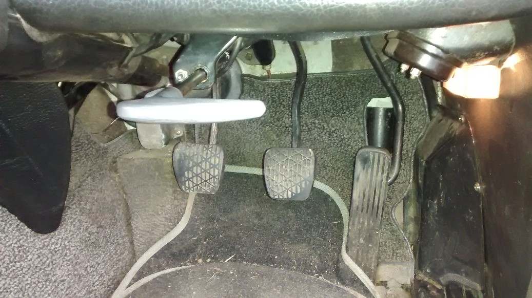

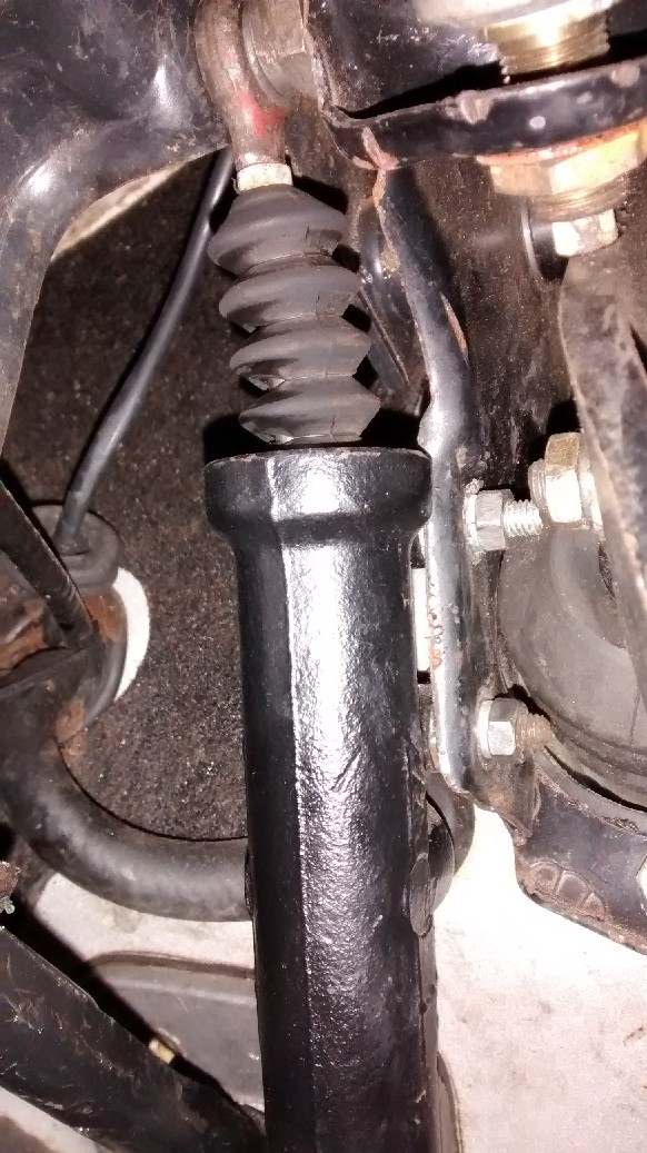

Clutch pedal pics as requested. The car was auto but has had the manual stuff added from a W123 Merc. You can see the master cylinder poking out above the carpet as well as close-up.
