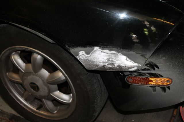

Been working on 3 fronts today, firstly on the mx5, while washing it the other day I rubbed a mark on the wing to find a hole appeared as a piece of filler fell out, after cleaning it up I had this.
mx5 wing1.jpg (41.26 KiB) Viewed 2621 times

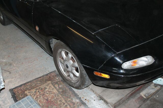

Cut a piece out to weld in then smoothed off weld with a flapwheel to give this.
mx5 wing2.jpg (47.83 KiB) Viewed 2621 times

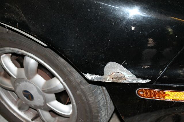

mx5 wing3.jpg (37.7 KiB) Viewed 2621 times

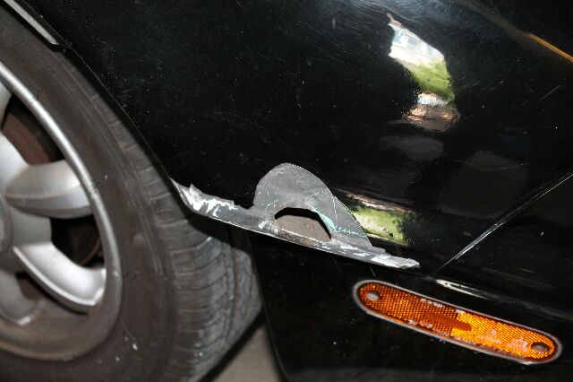

Finaly primed and painted
mx5 wing5.jpg (44.38 KiB) Viewed 2621 times
Needs cutting back more but I left the paste in the tr at work, so only had Tcut.

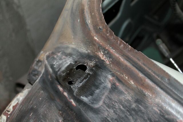

While I had the welder out I had also found some more rust on the minor when stripping the paint off the scuttle so this had to be repaired, firstly the damage.
minor scuttle1.jpg (45.06 KiB) Viewed 2618 times

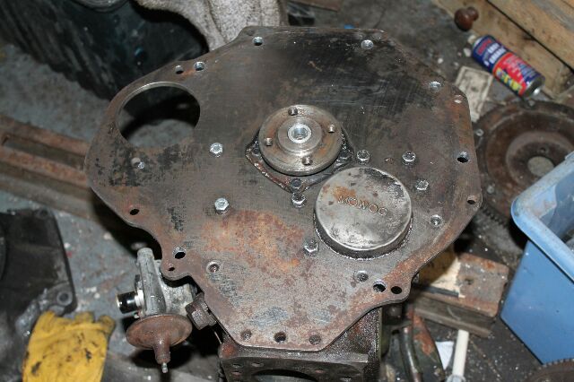

Thirdly I drilled the minor engine backplate for the mx5 gearbox, firstly the input shaft was wedged centrally in the nose of gearbox using alloy strips, it was then dropped into the pilot bearing and clamped in place before using suitable sized drills to mark the centre of each hole, the box was the removed and the holes drilled.
Just need to cut some of the bell housing away to give clearance for the starter and the ring gear is touching the inside of the bell housing so this will need fly cutting out.
That though can wait, at least now it can be trial fitted into the car.
