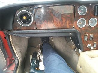

For the last week I have been using the Lotus every day, this inspired me to do some of the little jobs which I have been putting off for years, the main ones are repairing the lower dash trims and tidying up the vinyl around the screen and make the glove box open properly.
Firstly I tackled the glove box lid , taking a bit off one corner made it fit much better and open properly, at the same time I also re-fitted the glove box light switch which had fallen off and was hanging by it's wire.

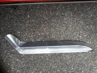

The lower dash trims are vinyl stuck over a vacuum forming, the vac formings have disentigrated.
20150520_121936 small.jpg (39.23 KiB) Viewed 1771 times
20150520_122309 small.jpg (40.79 KiB) Viewed 1771 times
So I made a new one out of thin alloy sheet.
20150520_122040 small.jpg (42.1 KiB) Viewed 1771 times
Then re used the original covering to re-cover it.

replaced backing to the dash trim on the other side with a alloy structure as well now, before:
After
Just need to find a nut for the trip re-set cable.

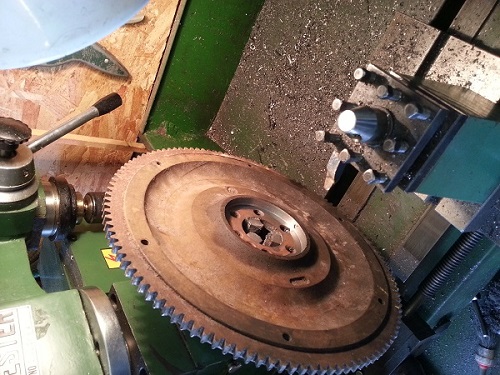

The new alternator for the TR turns out to have a 17mm shaft, problem is the old one and hence the pulley had a 15mm shaft.
So I needed to get to work on the lathe, boring out the pulley only took a few minutes, but while I was at it I did the turning required to fit the mx5 box to the minor, firstly I enlarged the hole in the centre of the 1275 marina flywheel and the recess for the crank flange so it fitted on the minor crank.
I then urned up a bush to centre the pilot shaft to the crank, eventually I wil get some bronze to make one but for now alloy will do.
the flywheel now bolts to the engine (still need to drill 4th bolt hole).
the only problem is the flywheel fouls the oil pump cover so I see a bit more machining coming up.
