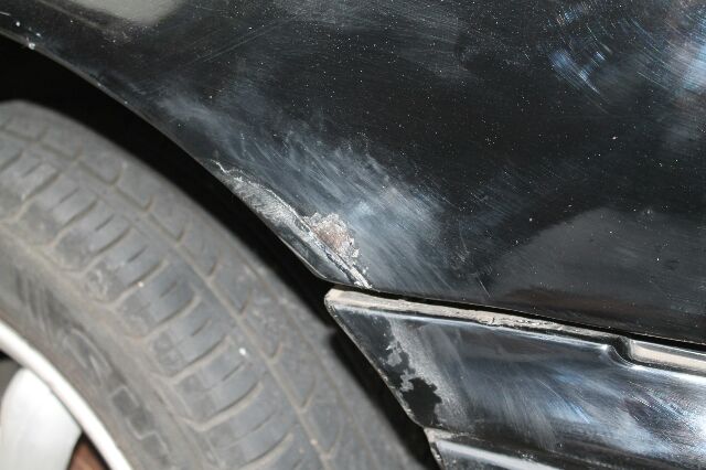

Also washed the MX5 and noticed a couple of rust bubbles in the rear corner of the rear wheel arch dreading the start of serious corrosion I gingerly cleaned it off to find it was only surface rust, the rear factory fitted rear mudflaps have rubbed through the paint and corrosion has begun to run underneath it so it will be a pretty simple repair,for now I have just treated the area. I might even look at binning the mudflaps as one is damaged anyway.

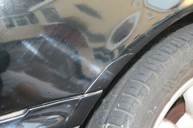

Some pictures of the paint damage caused by the mud flaps on the mazda, they were the orignal mazda ones which go over the rear bumper and have a thin edge to close the gap to the body, unfortunatelly this edge also cuts into the paint. This is the side wbhich has rusted.
This is the other side with just the paint damage.
I actually prefer it without them anyway, so I will repair the paint damage and leave it without them.

Took mine off too, improves it no end I reckon.
