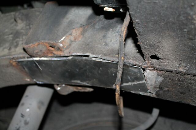

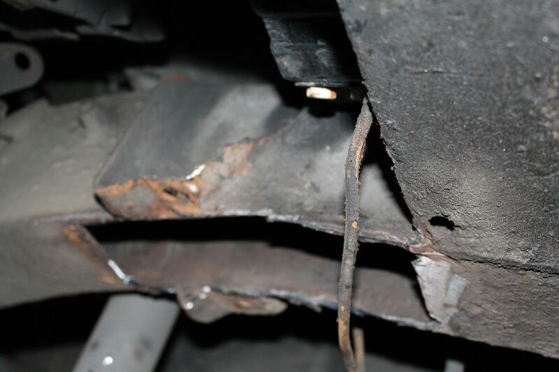

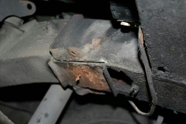

Been a very quiet time on the car front, we went away for the first week of xmas and the second week has been full of family things I did get one day to go over the landie and sort out a couple of issues, firstly there was the hole I noticed in the bottom of tge chassis, it appeared to have started in the double skinned part above the bump stop. So I decided to cut it all out and replace with a thicker 4mm single skin.
As found and first cut made
landie chassis1.jpg (36.22 KiB) Viewed 1972 times
All cut out
landie chassis2.jpg (52.28 KiB) Viewed 1972 times
Repair patch cut out and trial fitted.
landie chassis3.jpg (38.47 KiB) Viewed 1972 times
Patch welded in, not particularly neat but plenty strong enough.
landie chassis4.jpg (30.77 KiB) Viewed 1972 times
Just need to remember to wax inside it later in the year, I was actually pleasantly pleased with how solid the rest of it was, and it was obvious the previous wax treatments were doing a reasonable job.
