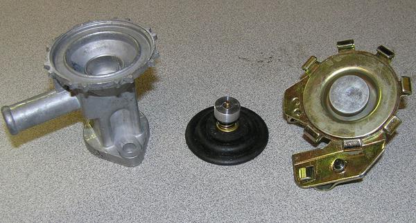

Sooo, an update related to the smiths heater. I was losing a little water over time and after all the other mechanical improvements I've done (like the sump seal work), I wanted to get to the bottom of where the water was going. So I borrowed my brothers snap on pressure tester and found 5 issues!
4 were easy fixes, new cap, tighten jubilees etc... but one leak was a drip from the smiths heater valve. There are loads of replacement valves on the internet, especially for triumph and land rover and they look similar except that the inlet pipe is angled on mine, so that makes it rare as hens teeth! I could get regular one and steal the diaphragm from it as I suspect that's the issue, but thought I'd ask on here in case anyone has seen one or knows where I can get just the rubber diaphragm/washer thing inside.
(pic is reference from internet to show what the diaphragm/washer looks like)
