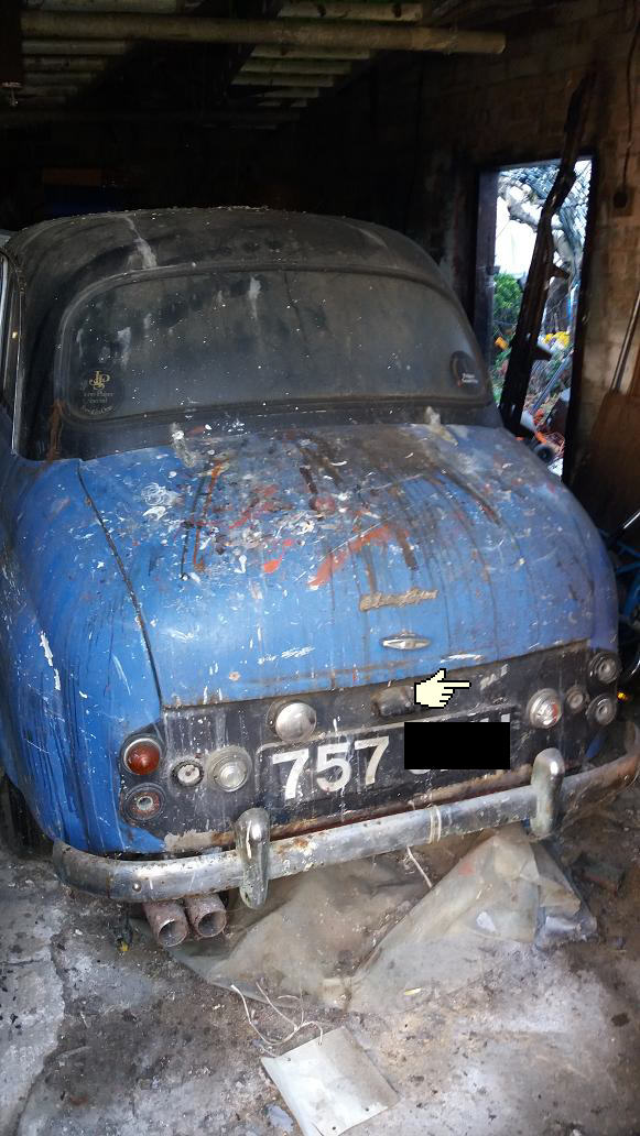

Well it's not the fuel injected one but it is mine! Spend several hours yesterday getting access to my A35 in my late Mother's garage.
As I expected the bonnet has been bent in, but I know of a few around or a man that might be able to "unbend" it.
It took a while just to get to this stage as just inside the door where step ladders (that looked lethal if you tried to use them!) and TWO broken lawn mowers plus bags of rubbish .. I would add I started to remove parts several years ago .. the hole in the rear panel is for an alarm key .. the hole in the sill needs attention! No the rear wheels are no standard .. 5 1/2" banded steels with 185R13 tyres. They came with 4 1/2" rims and 5.20 cross plies. Mine did at least go around corners!
Once I cleared the side I was able to squeeze past an old broken gas cooker (why? :roll: ) and get one of the garage doors open ...
I never knew my parents knew Picasso .. :shock:
It's a Mk II (no BMC never made one!) and that boot handle is the more modern Mini Clubman one. Still locks and unlocks too!
So it's now got four wheels and tyres that hold air so it's at least moveable .. push me, pull you moveable .. next up is to find someone to transport it home for me ..
The JPS Formula 1 stickers in the rear window date it's last excursions into the outside world .. I'm sure the offside one said "F1 Belgian Champions"!

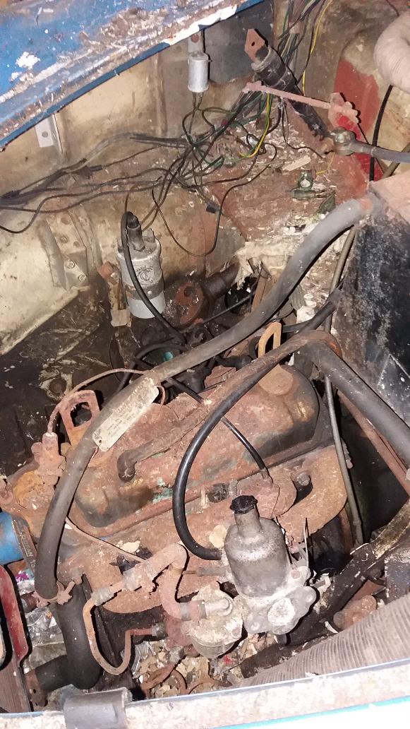

After removing several plastic storage boxes, books and sheets of 1/2" plywood I managed to get the bonnet open too ...
JPB there's that 1 1/4" SU .. there is another complete carb and manifold set up in the boot .. must have been from SHMBO's old wrecked A40 Mk II. The A35 is sporting the A40's 8" front drums too ... I made a start to get it back on the road many years ago but never finished. I plan to fit Midget discs now. Those 8" drum assemblies are highly sought after by my Owners' Club members. The 8" are more efficient and still look original.

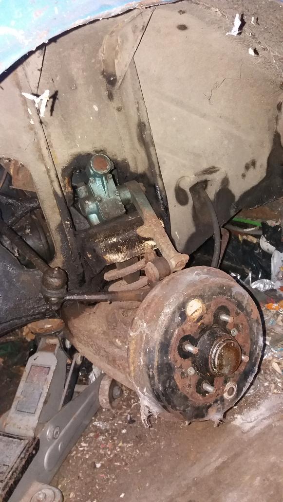

So here are those 8" drums ..
I was surprised at how easy the car was to move until I found the 8" shoes in a cupboard in the garage! And the brake return springs under the car ..

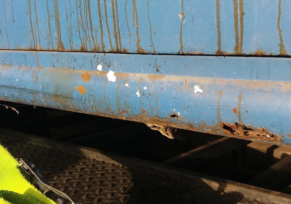

The nearside sill was a lot worse than I remembered .. the offside isn't quite as bad ... but I now have two brand new sills, and some wing repair sections sitting in the garage ready for that fateful day when I get the angle grinder out! (which won't be tomorrow!! Still have to strip the mechanicals out and get it on the spit!! :thumbs:

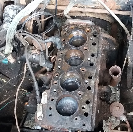

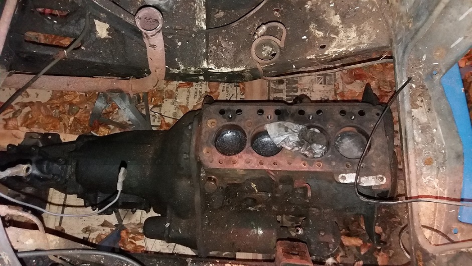

As the engine is seized I wanted to see what was in the bores ..
That is penetrating fluid in the bores .. engine is still seized .. it all came apart very easily apart from a coupld of studs and in teh process iof lossening one, I managed to take out the engine plate! :(

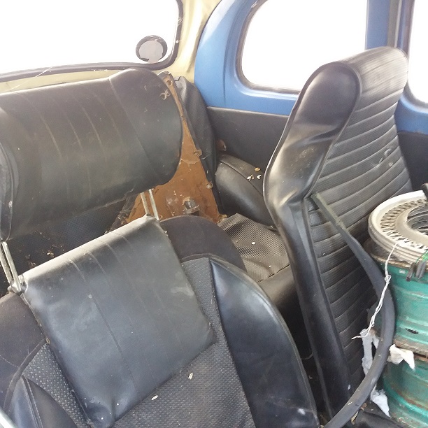

I also started to clean up the interior, but that can wait until next time!

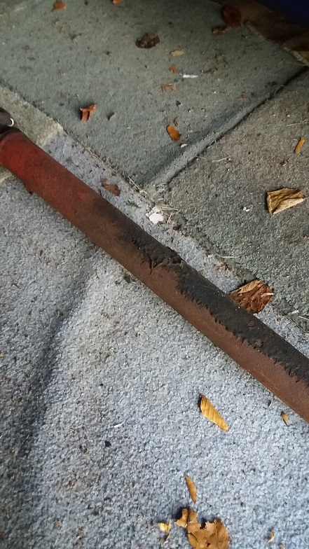

The propshaft shouldn't be rusty .. it was half coated in underseal! Well half won't rust! ;)
Given "most" of the underside is undersealed it is remarkably solid. There is a rust hole in the passenger footwell and two crack where the front tilting seats hit the floor if dropped. Most of the rear rust is confined to the outer sills, bottom of the front wings and the front panels.

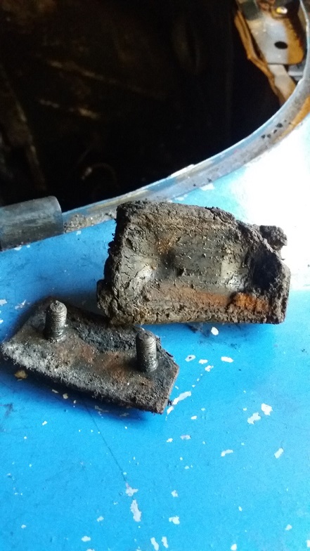

While wrestling with the gearbox and engine I heard a metallic clink as something hit the floor .. half an engine mount! :shock:
