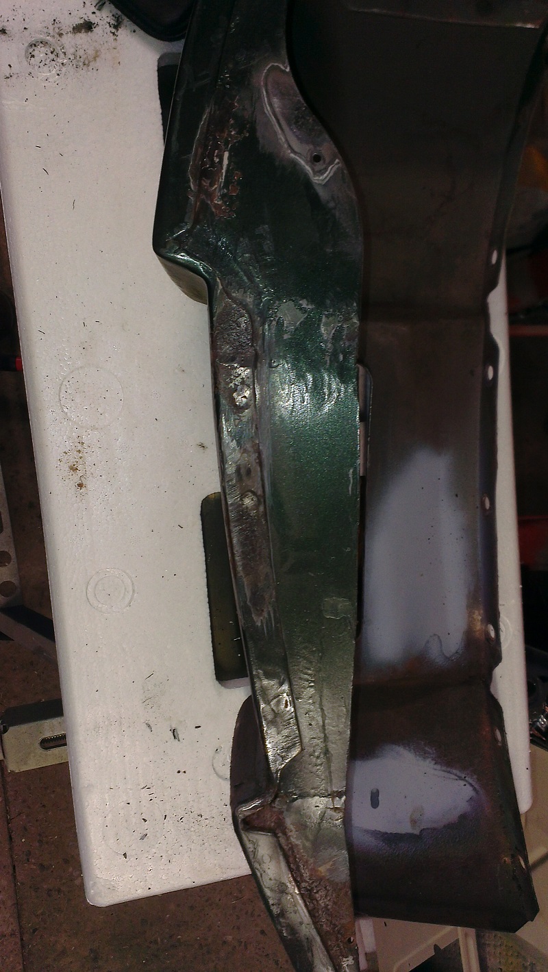

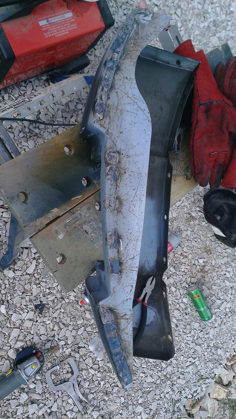

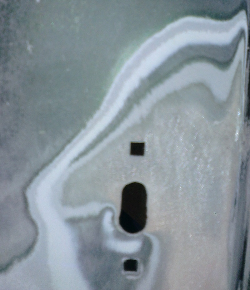

This is the NSR corner/light box
A bit scruffy on the outside
ruined on the inside
So I had to make up a new piece
Drill out the old one, clean up the rust and weld it in
While cleaning it up for painting, I discovered the car has been resprayed once before
I also made up some floor / wheel arch repair sections which are now welded in.
There are other bits welding such as 90% of the wheel arch now being solid again that are done. Pics to follow shortly.

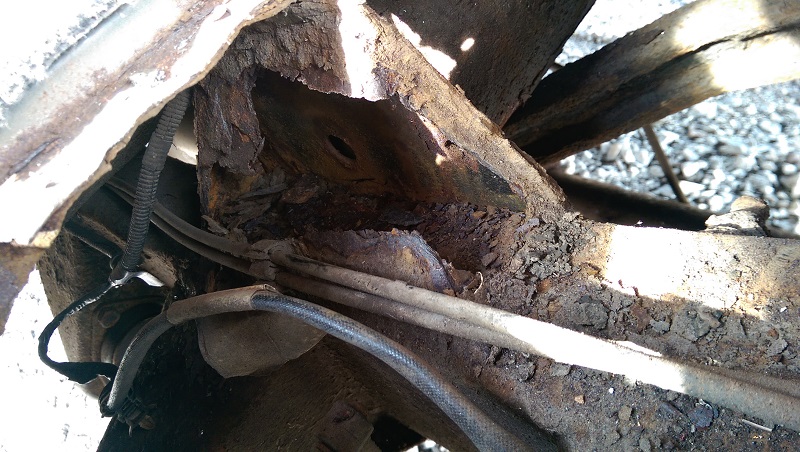

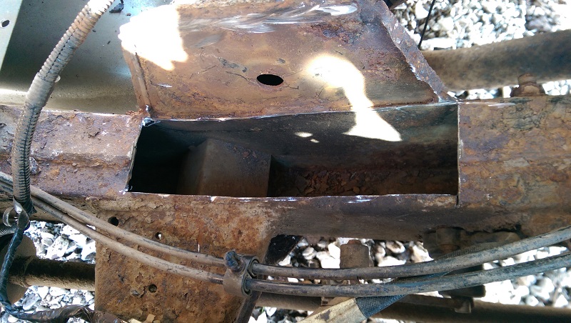

Just as well I did as underneath some chassis issues were revealed (both sides are the same so I will only post images of one)
chassis rot.jpg (183.14 KiB) Viewed 3914 times
To get at this I had to take part of the rear floor out. Just as well I did as this is rotten too (not pictured)

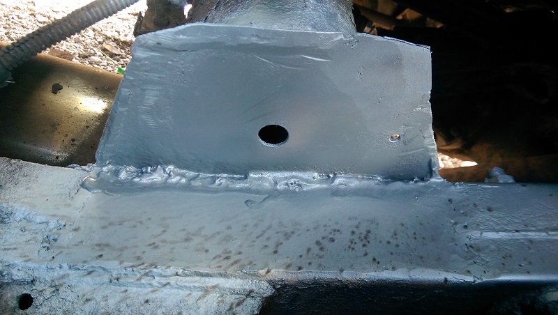

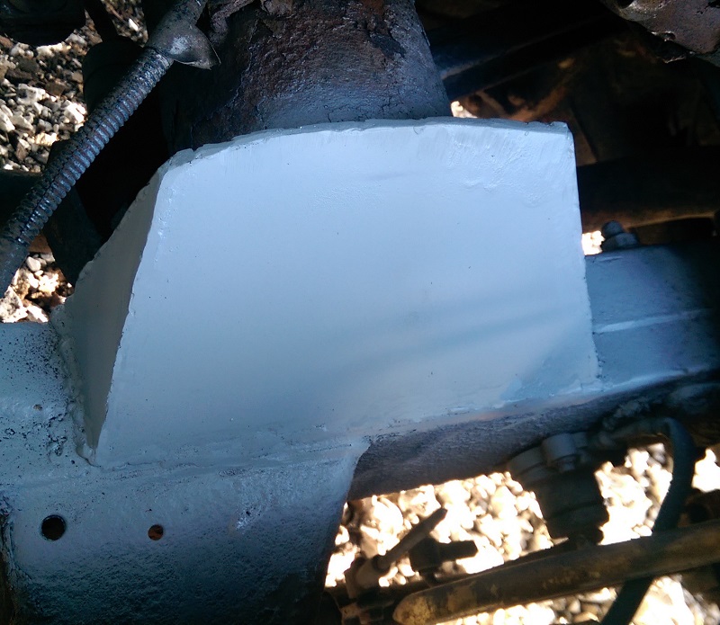

but it allowed me good access to attack and re-create a rather important bit normally hidden.
chassis cut out.jpg (185.8 KiB) Viewed 3914 times
chassis patch 1.jpg (142.07 KiB) Viewed 3914 times
chassis patch 2.jpg (181.45 KiB) Viewed 3914 times
Not the tidiest job in the world but given the silly angles I have had to work at, I don't think it's too bad. it passed the "whack it with a hammer and see if it falls off" test ;)
I haven't got as far as completely repairing the drivers side but the top of the chassis itself is now solid.
I have also started wire brushing and k-rusting the original chassis as you can see in the pictures it is a bit flaky but bashing it with a hammer shows it to be solid.

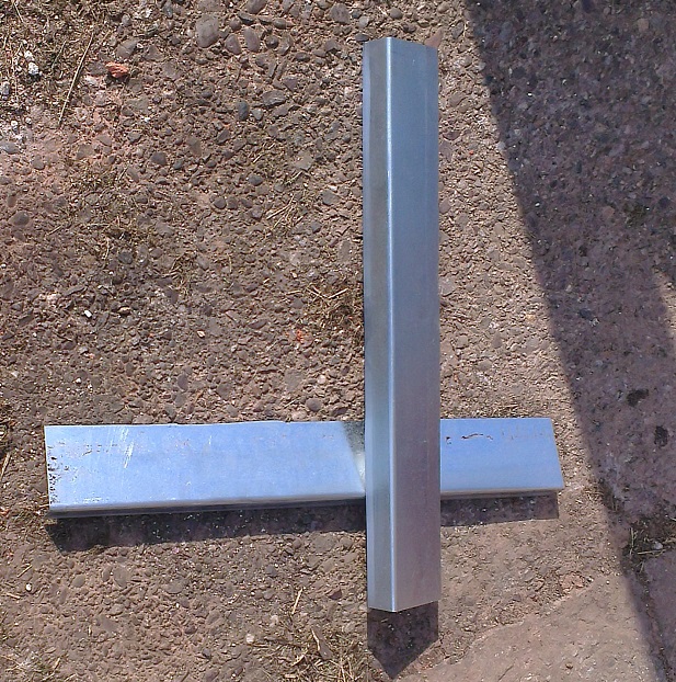

z sections to replace the corroded lip that the boot floor sits on
