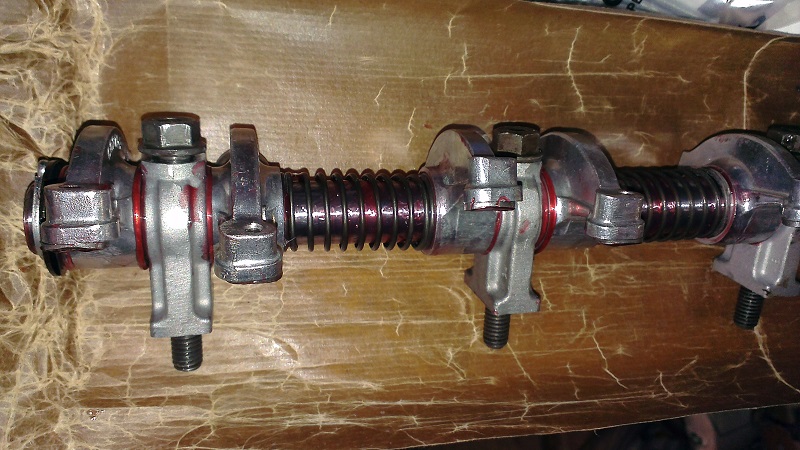

John Craddock to the rescue, bits arrived this morning.
I had half a tube of cam lube left from when I put the engine together so I made use of it.
part way done
part way.jpg (179.55 KiB) Viewed 2531 times
and complete
As the other side is the same no point in posting a pic of it.
If the weather is OK tomorrow then jobs are,
Pull and wire brush the rocker covers as they are looking pretty grotty
Fit the new rockers, and put the covers back on with new gaskets
Pull the sump again, degrease the outside and wire brush the rust I have seen on the bottom then wave some morris green engine paint over it. (it's the only engine paint I have and it will look better green than oil and rust plus I have no idea what colour it should be)
Re-fit it with a new rubber gasket. I have never seen rubber sump gaskets for a rover v8 before but as every cork one I have fitted has fallen apart within a year or so and started leaking again so hopefully this is a fit once and worry about it again in another 150,000 miles when I rebuild the engine.
