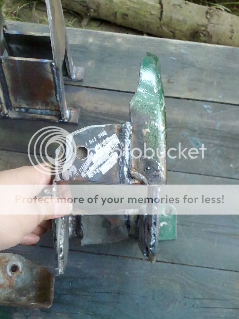

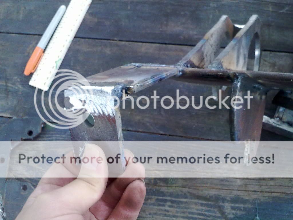

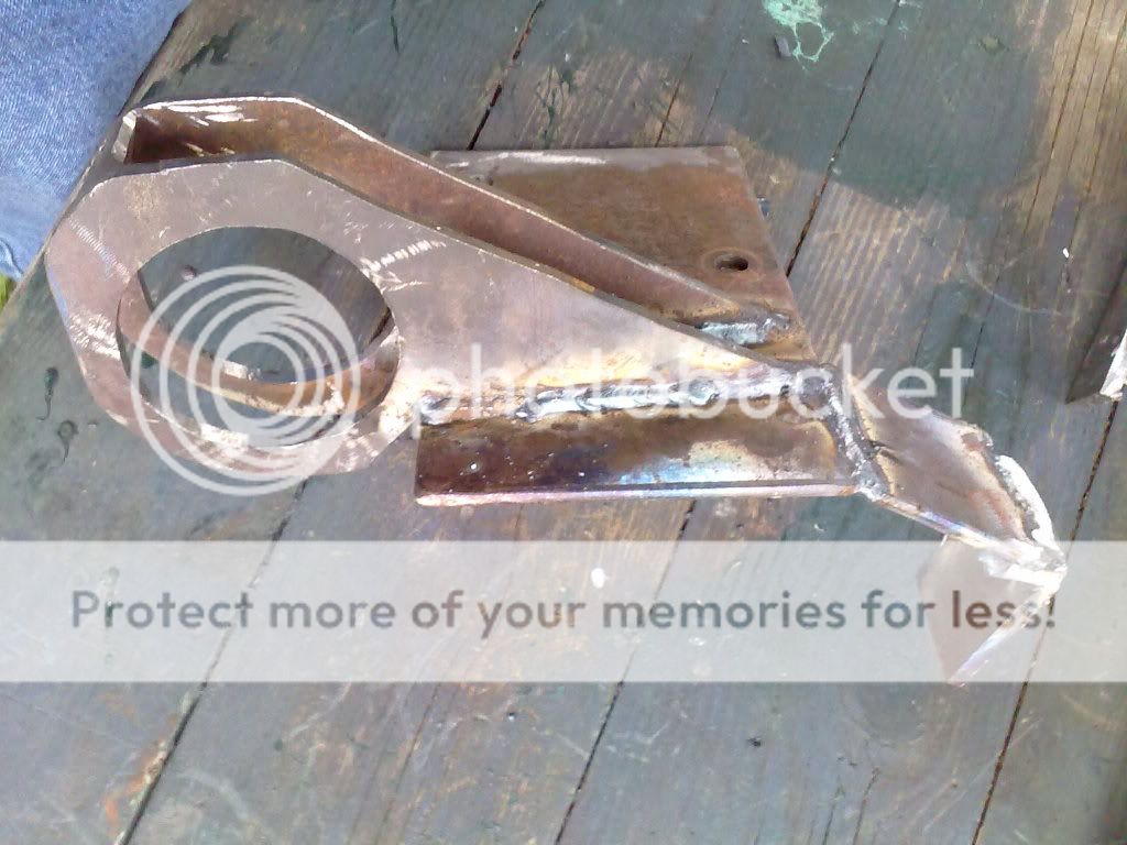

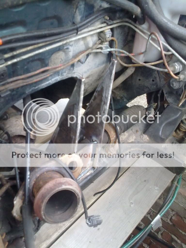

He did some more welding for me.
The rear engine mount brackets, the engine/transmission part is now
complete but just needs painting.

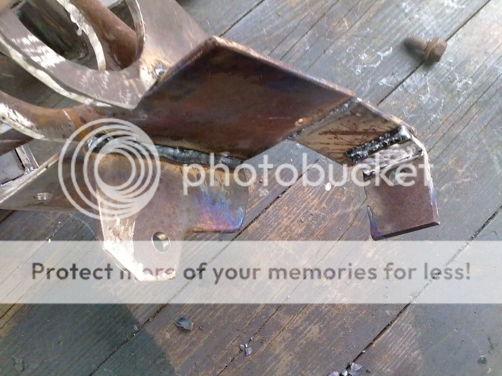

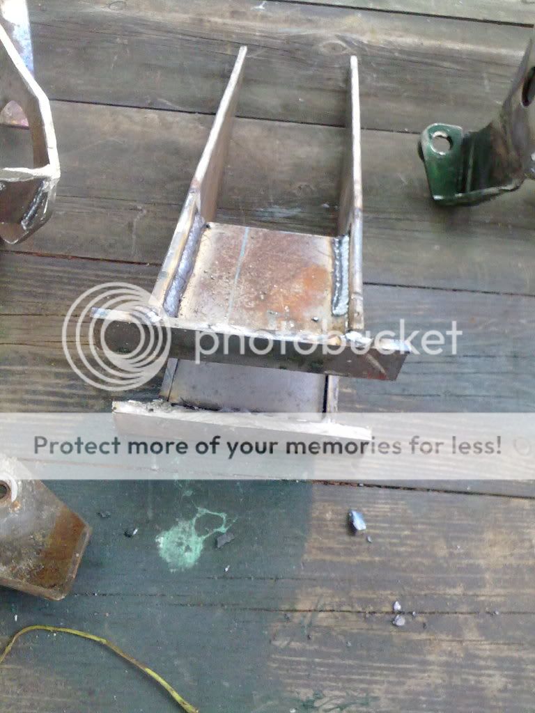

Now the subframe part.

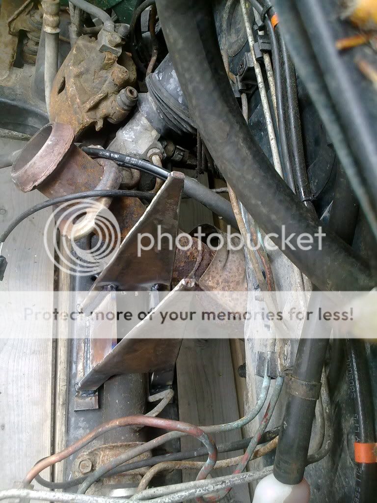

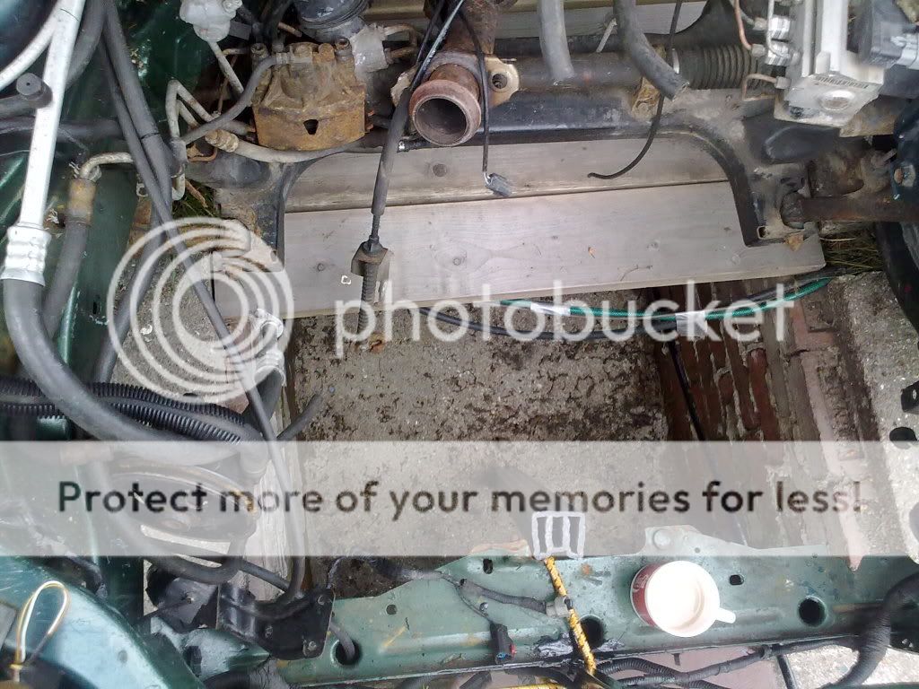

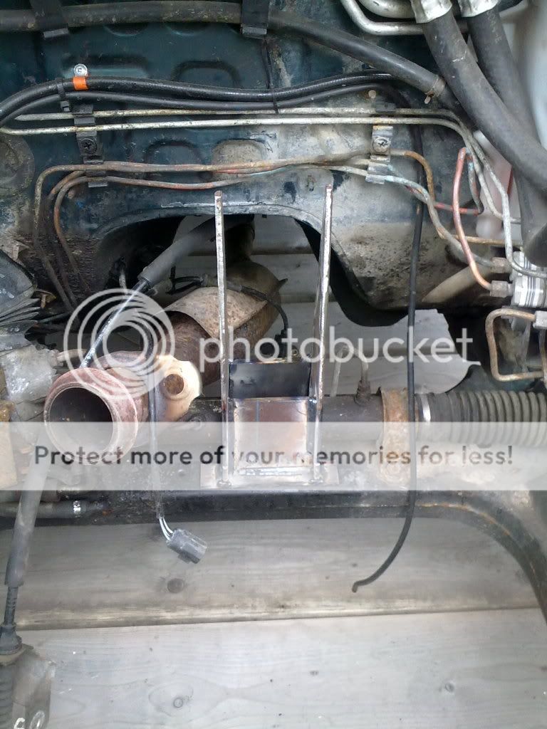

I then tried this part on the subframe over the steering rack.
And now the other way

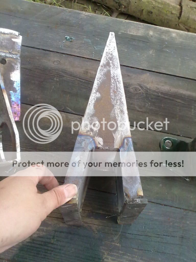

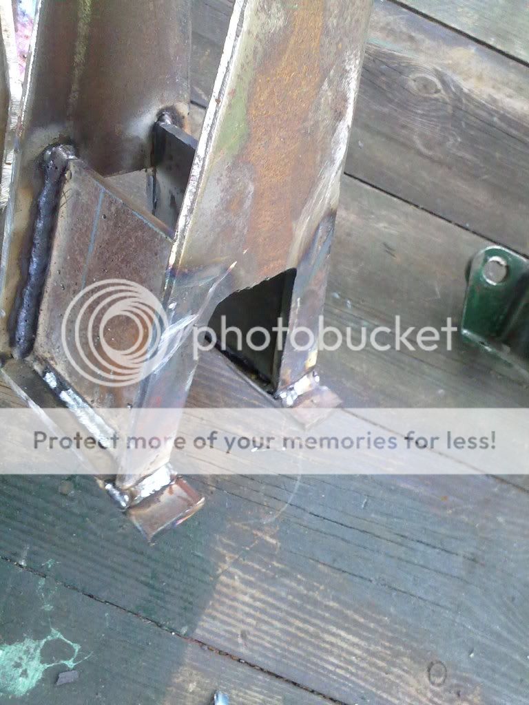

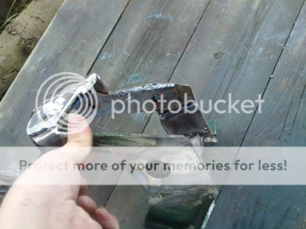

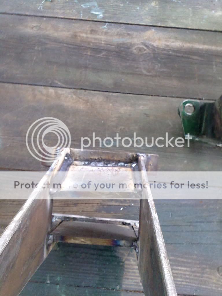

The front engine mount, it's not going to win a beauty contest.
I will fill the holes before painting, but I tidied it up with
the grinder.

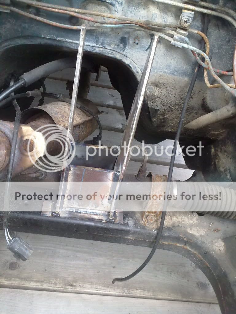

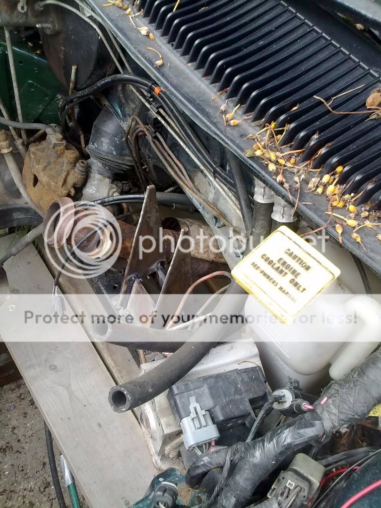

DEEEEEEPPPPP engine bay
Might have the engine and transmission in again for a fitting
at the weekend, weather permitting.
the grinder.

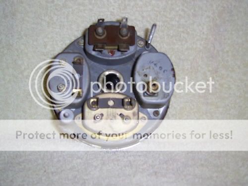

I have a picture of one of the speedometers out of the tool shed.
I've been picking Jimbo's brains.
I posed the question what used the same gearbox but with a speedo cable,
rather than an electronic speed sensor.
(page from Jimbo thanks much needed)
One of the options that was suggested was the Dodge Omni, which I then
remembered it's called the Talbot Horizon over here in the UK.
It was a mater of a few emals and calls for prices.
The dealer wanted £100 plus tax (20%) and couldn't tell me if full unit, or just
one part!
Eventually, I came across a Talbot owners club forum with details of a parts
supplier. His name is Colin Hill I sent mail containing the above pictures.
He said he would look and email me back. He did with the pictures below his words.
So that has been paid and will arrive next week sometime.

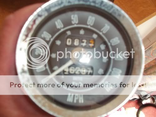

one part!

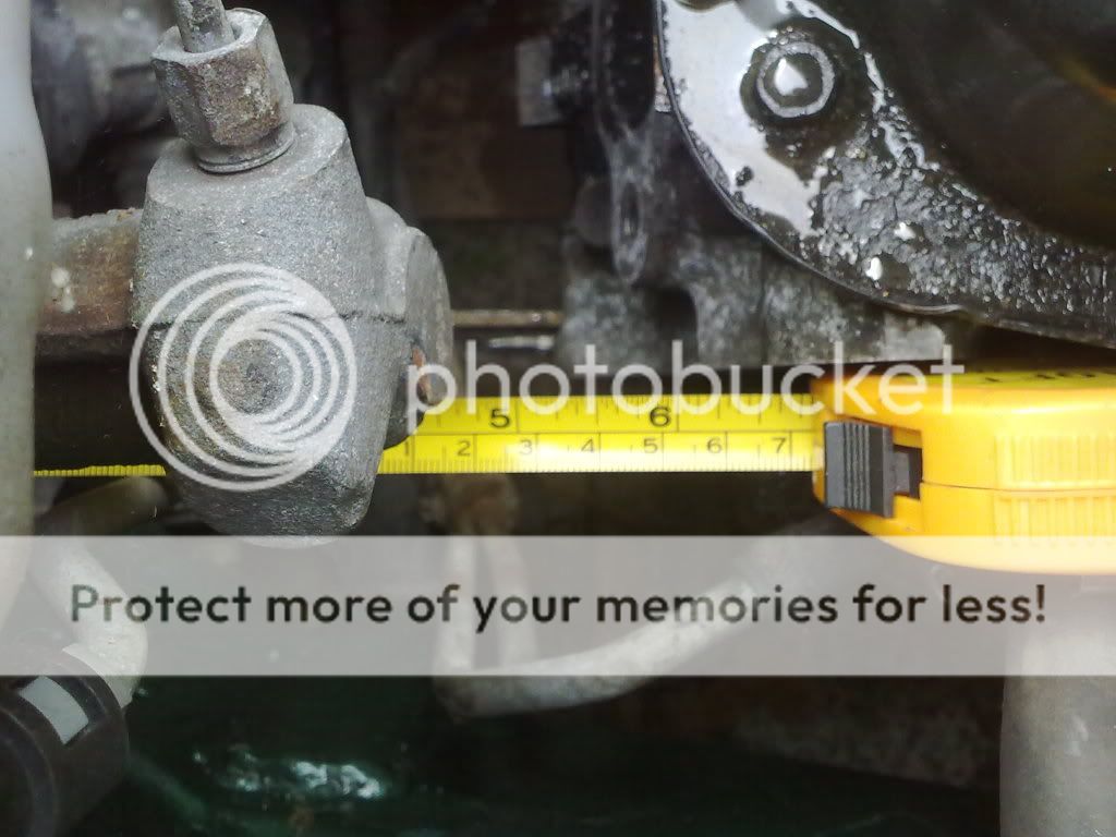

I do indeed have the part from a Horizon Automatic and attach 2 pictures.
Size of aperture for the fitting is 32mm.
If interested £20 including postage.
Can accept Paypal if you have it,or cheque or cash.
Let me know
Colin

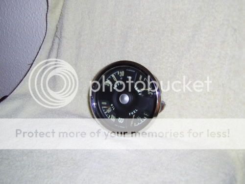

Then I came across a nice multi gauge unit off a Wolseley
A rare gauge indeed, if I don't use it in the neon it's one to be saved.
Fuel level, Water temp, Amps, and an Oil pressure Gauge in one unit.

That multi gauge is no use for a car with an alternator, but as you say; well worth saving.
Also, consider that the Dodge Omni/Plymouth Horizon (US) and the Chrysler Horizon (UK) aren't the same car under the skin. They look similar but don't share any panels, trim, torsion bar suspension (Omni has struts and coils both ends), VW Golf engines/gearboxes (same Golf gearbox in the Omni as found in the Maestro & Montego), looms, glass - apart from the o/s/r drop pane, etc. Maxi arrangement is as has been said earlier, but the Golf gearbox has its speedo takeoff from the n/s driveshaft position on the Golf of the era (basing this on my P plate CL Variant with ADZ engine and 5 speed manual), so it's a reasonable assumption that the Maestegos, with the same gearbox, also use that arrangement.
I get that it's pricey, but electronic speed & distance recording may be the best way to go in the end.

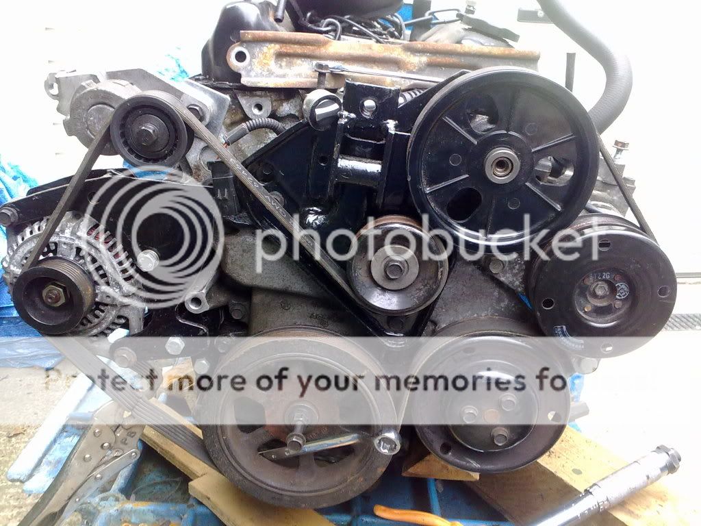

Because he never came today I got the tools out and put the pulleys on.
Now looking at previous pictures.
I know I will need another roller pulley between the Alternator and chrank shaft
pulley. BUT! the placement of the spring loaded pensioner needs moving as the
brake master cylinder is there.

Mitsuru wrote:spring loaded pensioner.
This I have to see.
