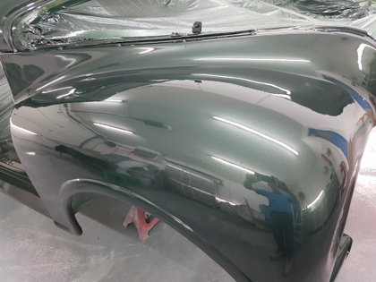

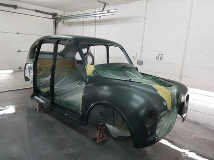

Did the minor rectification prior recoating with basecoat and then on with the lacquer
#144 Post by Grumpy Northener »
All gun finish with exception of the front panel which I have now flatted & polished - I now have a limited time to flat & polish the shell - It looks good but by flatting & polishing I can achieve a more authentic finish to the paint - so that will be tomorrows task - If left any longer the lacquer hardens to it's full strength and becomes very difficult to polish - but pleased with what I have so far - no defects and very few minor specs of dust that will all polish out

Right - quick update from the last few days - apologies but starting to have to burn the midnight oil so limited time for updates - I have another job booked in next week that will interfere with the Javelin progress - and having Saturday off - I need my fix of petrol / oil / burning rubber and old large / loud engines - so off to Goodwood for the members meeting - so what's got done: All painted bodyshell panels flatted & polished

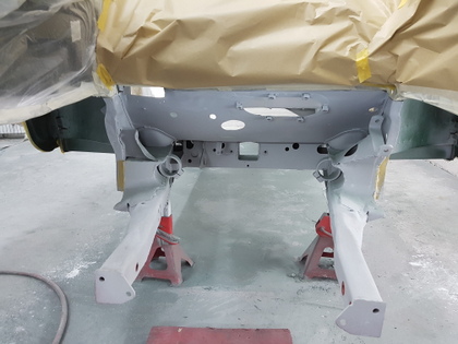

#147 Post by Grumpy Northener »

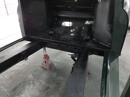

Dash prepped & masked in advance of painting - chassis rails, underside & inner shell panels prepped & masked for painting
#148 Post by Grumpy Northener »

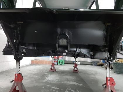

Shell demasked and cleaned up post satin black application to underside / inner panels etc

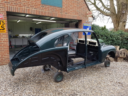

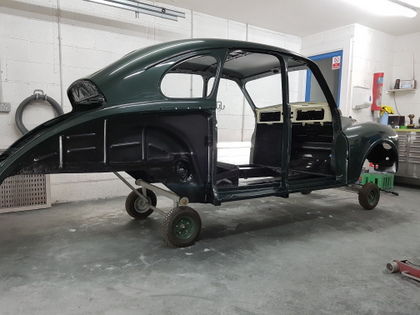

Transit axles / wheels fitted and the paintwork inspected again but now in natural daylight for any defects
