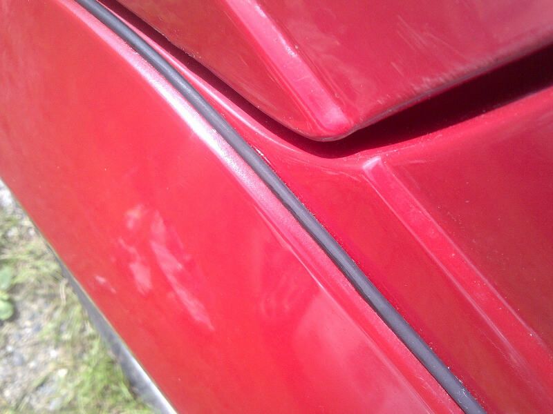

Done a little more
Painted up the front bumper as needed a little work as after removing the washers I had painted with a red that was not quite right
It needed new brackets to replace the heather robinson bolts someone had drilled through the edge of the wing after the old mounting points rusted away
I welded some nuts behind the drilled hole and then bonded it to the bumper. This was then covered in fibreglass to secure them properly
I had to weld up some small holes in the passenger door skin that where then ground back filled and painted.
Thought Id show the process I use for blending new an old paint maybe it will help someone or maybe Il get tips on quicker process!
So first going over with 400 grit, then 800 grit , 1200 grit, 2000 grit then coarse cutting compound then T-Cut then a polish and wax
Bumpers back on and she is starting to come together..

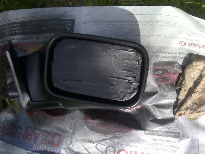

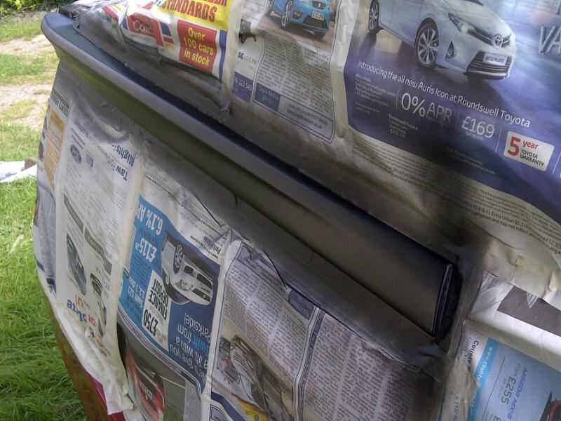

And today I finished going round painting the black trim. I had gone a milky grey over time and now the rest of the paint is in good nick looked terrible.
I wanted to make sure it did not flake again, so I used white spirits to clean, then Halfords bumper prep spray then bumper black paint. This was used as a key for another coat of Satin Black.
I did not like the finish of the halfords bumper black hence the satin. And I did not want to use gloss black as I though it was to shiny versus the original look.
I did the door handles and the wing mirrors too as they where also tatty.
All took allot of time consuming fiddly masking!

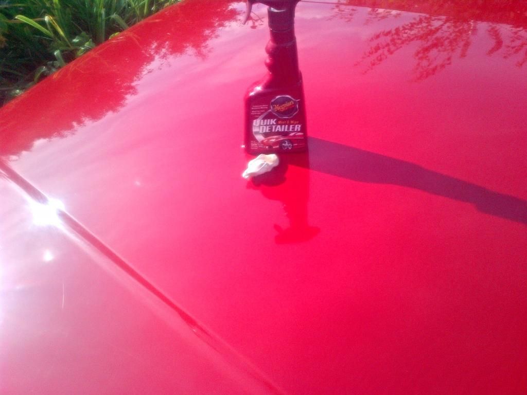

With the car sat for 2 years under various tarps and car covers and all the welding and grinding etc, the bodywork needed a proper clean now everything has been sorted.
I started with a T Cut then a clean over with a clay bar.
This was followed by a clean off with a panel wipe type cleaner and then sealed with Wolf Guard Sealant.
All pics are done off my naff 1.3mpx blackberry because I forgot to get the proper camera out!
