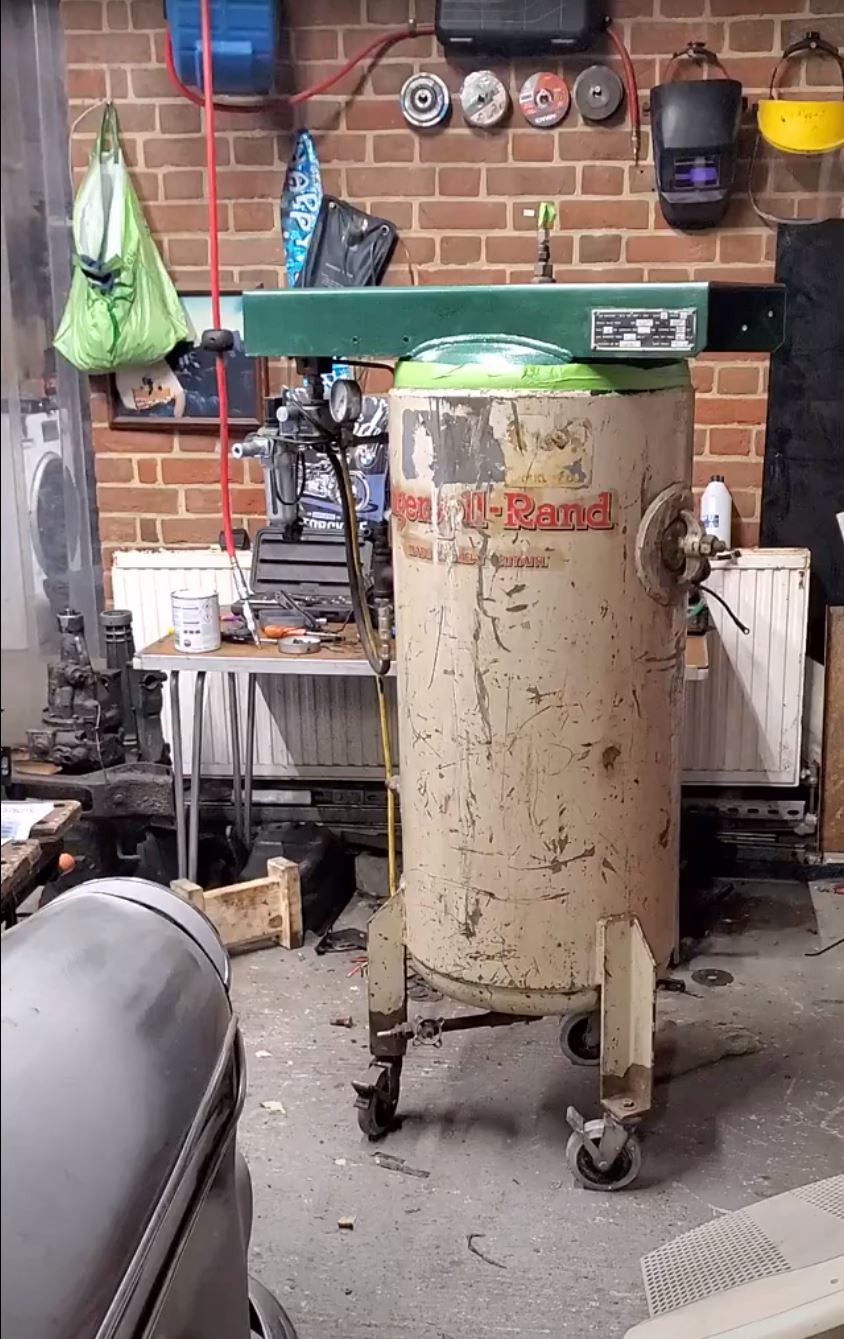

Pic of Mrs Ings looking on at me rebuilding the old compressor. I got her pressure tested and the steel is still 6mm thick all over. This old stuff lasts forever, however, someone fitted a small motor/pump. So I've bought a 3hp v twin pump and motor. I hope Mrs Ings realises I will be able to spray her better when that is done :D

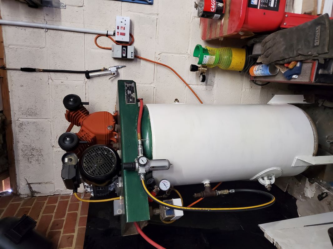

Oh, and I finished the compressor. Striped, painted, new pump, new motor, new connectors, one way valve, 0 pressure valve, starter, turned new switch, 3d printed bottom cover. A 1960 tank still good as new, pressure tested and it is still 6mm thick steel all around. Tested to 250PSI. Now there is no excuse to not finish painting Mrs Ings.
