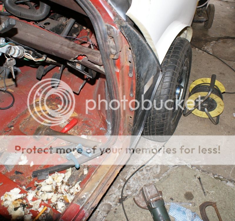

To fit the A panel and repair the door sill step, If I had time on my side I'd have bought a step but for the sake of finances and speed I have to work with what I have about.
You can see some of the expanding foam some heathen has put in there in the past appearing in the footwell of the car...

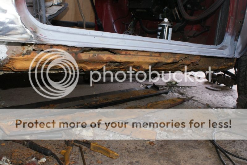

And so it was time to take off the oversill that had been fitted to repair the car at some point, this is what was below it
Despite the sill still being solid it was causing more harm than good like that.

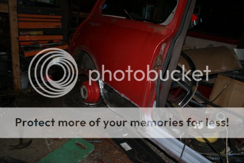

The remnants of original sill, more expanding foam and all vestiges of the over sill were removed and things cleaned up a bit
as I have oversills but not the proper short items that allow ventilation I cut one down to make an "original"
The new sill was fitted with seam welds at the bottom where it it meets the inner sill and plug welds along the top where it meets the seam of the door step / back panel. I don't have a photo of that but it is on now. I'll try to get a photo of it when I remember.

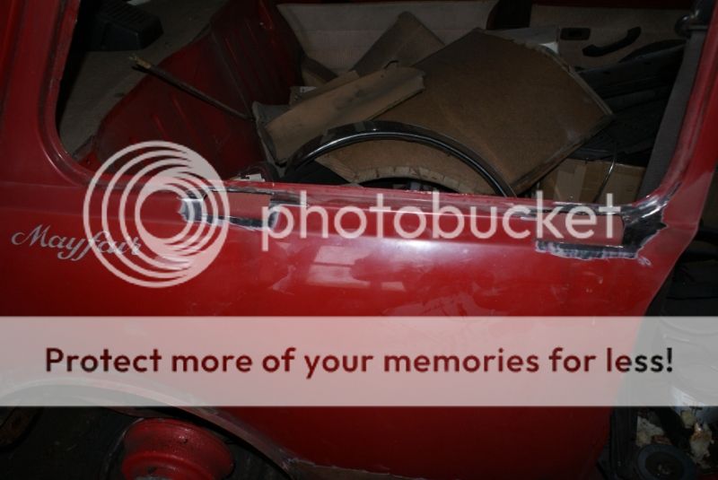

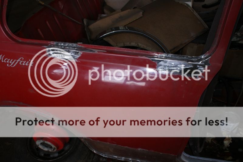

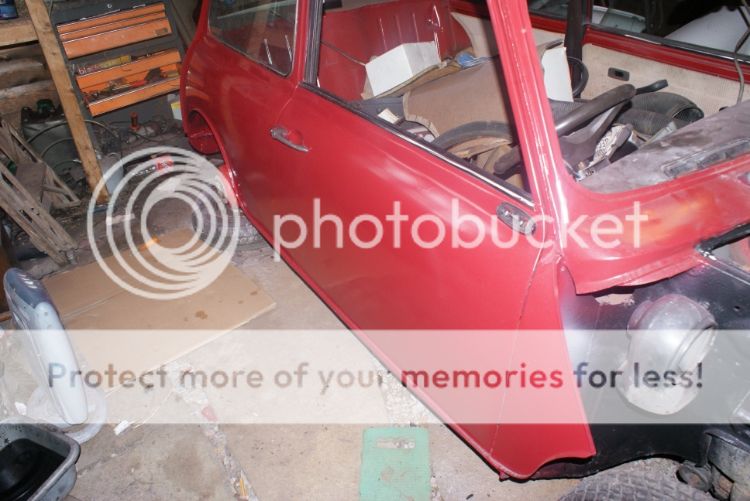

Anyway, grot was present just below the rear side window so that was cut out
then new metal welded in and cleaned up

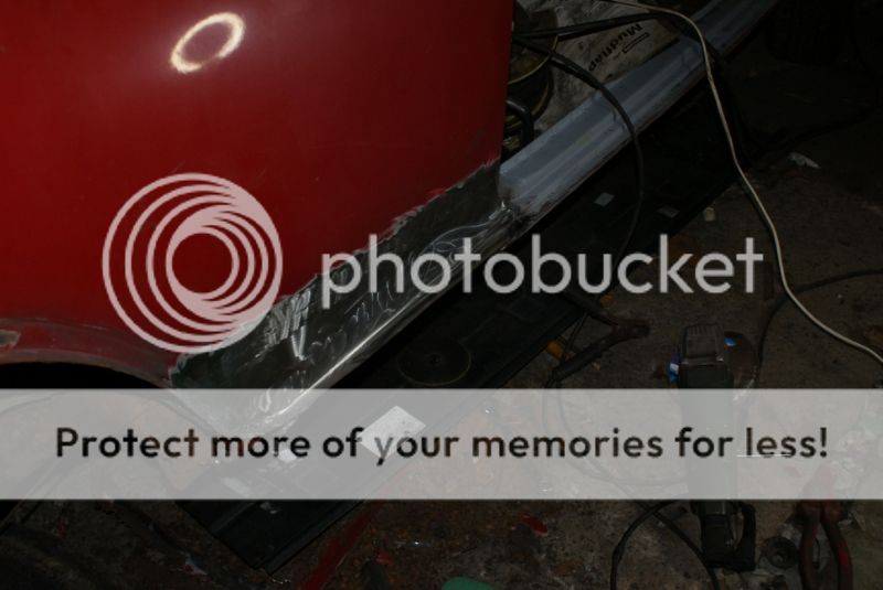

I thought I had better get what I have done to now protected, so I got the halogen heater warming the garage and did a little prep work with filler and then primed and painted the drivers side, then with door refitted, painted it again.
The filler prep could have been a little better, but by the time it is t cut and polished it will be perfectly acceptable and will at least do for this winter. I did a little stone chip coating as well while I was at it.

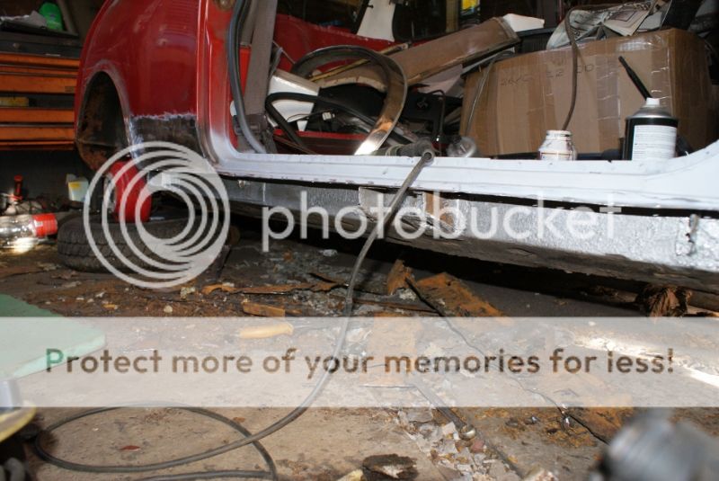

and here is a picture of the sill as promised
I decided to stick with the red as it saves me doing the odd little internal bits, I had planned to get a little more serious but as I need the car now these little things help. I went to the local parts shop which isn't exactly the biggest place but have started to mix paint on the premises. The colour is Targa Red (or at least should be), but when the mix came out it was a little to brown and while it is a bit terracotta the paint mix was way out. Anyway, I just got them to throw a bit more red in until it reached a shade I can live with, it isn't too bad really, and we have the recipe for when I want more

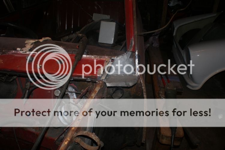

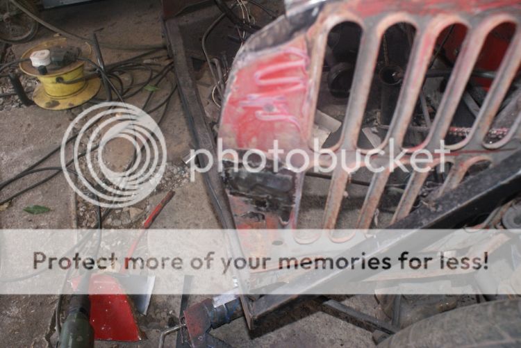

I trimmed off and welded in a new gutter on the front windscreen scuttle, then chopped out some grot from the nearside of the scuttle
A quick fab up of a new splash / closing plate to go under the scuttle and a dose of cleaning up and hammerite followed
and a repair piece for the scuttle going in

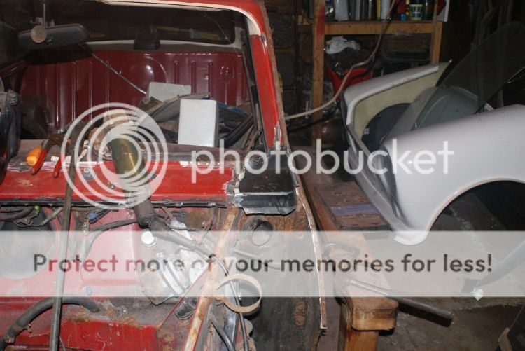

Anyway, just a little more progress tonight,
I finished welding in the scuttle end
Then did a small patch on the inner wing
Thats it for pictures tonight but while I was out there I gave things a good clean up around the wheelarch / footwell area and was pleasantly surprised not to find a hole on this side :)
That is coated with hammerite now which will get stone chipped when dry, I have also started cleaning up the engine bay ready for some rust and paint treatment tomorrow.

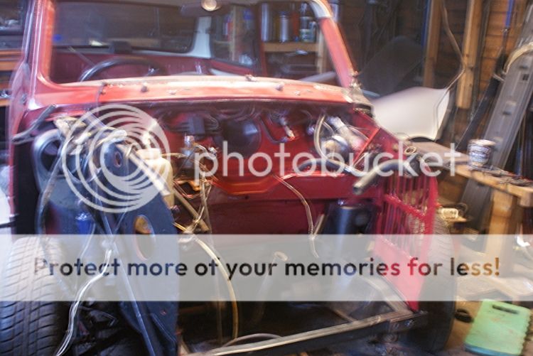

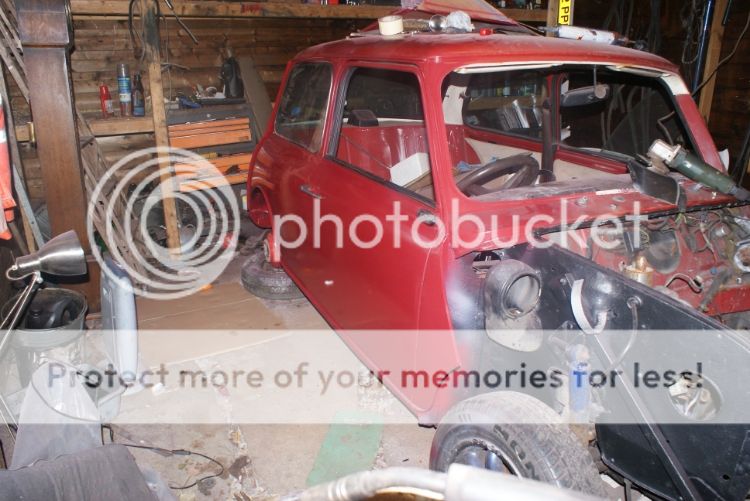

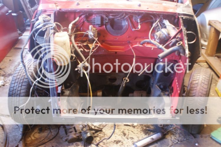

Well the front end is pretty much ready to accept the engine so just a few more jobs and I can get on to the nearside.
I cleaned up the engine bay and gave it a lick of paint, nothing fancy but it looks respectably tidy, clean, and it gave me a chance to treat a bit of surface rust, I also stone chipped the nearside inner wing / wheel arch area.
Sorry for the blurry photos, the super duper all singing all dancing fancy camera does not like low light levels (and today has ben wet windy and bloody dismal) unless you turn the flash off and let it take a longer exposure, that and my hands don't go well together.
Anyway, here are the pics,

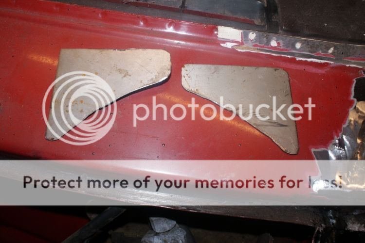

I then remembered I had intended to fit a small plate to the A panels where the bottom of the fibreglass front will meet with them to give me something to fix to. So that buggered up the paint on the drivers side A panel then, but that can be put right easily enough.
These are the plates I quickly made for the job
and here is one fitted

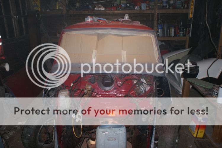

So, I then got on with the windscreen scuttle prep / filler work and gave that a coat of primer ready for the topcoat tomorrow, no photos of that yet as my internet is rubbish tonight and I can't upload to photobucket again...
Anyway, piccies of the scuttle / screen surround tomorrow all being well, that will just leave me a couple of bolts to do on the bracing bars and then I can move on down the side.

So a photo of the skimmed and primed scuttle area that will get some top coat later.
