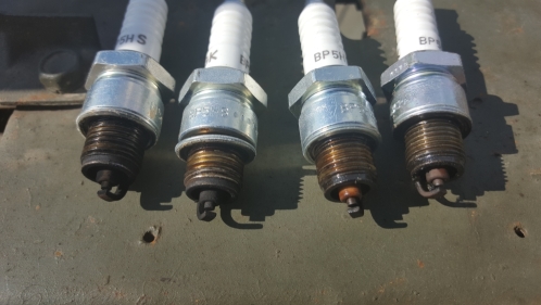

Had the plugs out today - as you can see from the image below they were filthy. Numbers 1 and 2 were thick soot, numbers 3 and 4 were not so bad.
Small plugs Aug 2017.jpg (97.16 KiB) Viewed 25747 times
Broke out the WS40 and a rag - gave them all a good blast and a scrub to clean them up. Checked the gaps - all set at 0.6mm so refitted number 2 trough 4 and laid number 1 on the head with lead attached. Got the OH to spin her over and saw a nic spark so refitted number 1 too. Started her up and she fired first time although there is still a slight miss you can here in the video so I think the plugs either need a better cleaning or replacing. Obviously UAZ's do not like sitting in traffic in hot weather for over an hour.
http://www.youtube.com/watch?v=5F4Fi05d5Lg
Neil.
