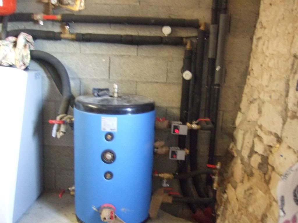

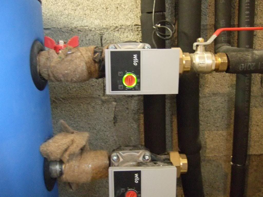

rich. wrote:John i am quite pleased with the machine & will post some pics later, just a bit pi##ed off that a simple power cut/trip blowing can cause such a problem.. if i need to have a new pump every time the trip goes ill be buying one once a week :evil: (it used to be nearly every day at one stage)
Rich, that's why I suggested a UPS (Uninterruptable Power Supply) - it will take the surges out and, if the power does go off, it will still run the pump(s) for a while - depending on the UPS's battery life.

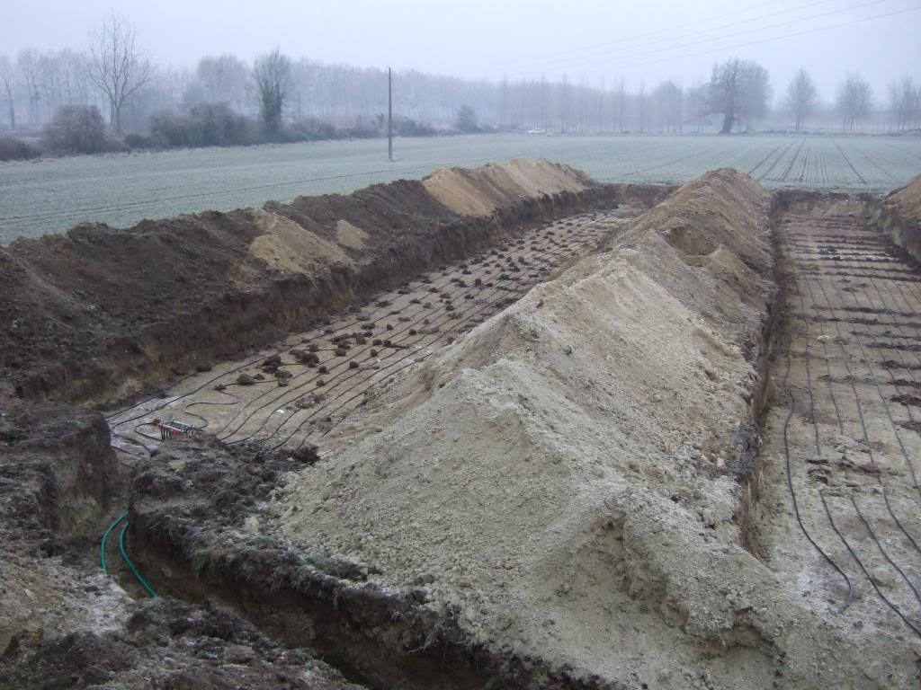

The outside pipework looks more impressive than the ones I've seen over here - they just used one long length of ordinary alkathene water pipe (the blue stuff) and had great fun trying to get it in without kinking it!

thanks for your ideas chaps! the plumber came today & chaged the pump, he then stripped it & the problem is nothing to do with the supply. the vane spindle had seized due to a bit of detritus from the old system.. :?

It may be worthwhile getting a filter fitted before the pump inlet. Our neighbour had similar problems (our houses had iron pipes for cold water and heating) and, on the advice of my heating engineer friend, bought a filter which my friend fitted (with service valves either side to stop the system emptying when the neighbour cleans the filter) when putting a new boiler in. The neighbour reckons it was well worth the expense: he had to clean the filter twice a week at first, not it's more like twice a year.
